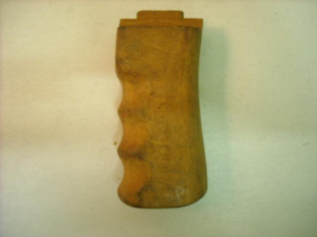

    Is this the one you’re looking for?
    Northridge International Inc. / STEN SMG WOOD HANDLE.

    Not quite. The upper part of the wooden front grip has a sort of caved shape. It is attached with a long bolt that screws into a ring which in turn slides over the barrel nut and is tightened in place. See the repro front grip in this post:
    https://www.milsurps.com/showthread.php?t=54570

    It looks to me like the foresight block band has been knocked backwards. It should be almost level with the locating lugs. That front grip isn't remotely like the original Vince.

    I am going to make do with anyway. It’s the closest thing I’ve been able to find. Maybe someday an original will surface. Until then, it’s what’s in the parts bin.
    There’s a good picture of an original with the mounting hardware on page 79 of Peter’s Sten book.

    All the photographs that I've seen of the battle of Arnhem which show MK5 Stens in use all seem to show them fitted with the front fore-grip. Was there a reason why they all seem to have been removed post war? Perhaps they tended to get damaged? I notice Indian made reproduction Sten fore-grips are for sale on Ebay; has any-one actually purchased one and are they any good? Thanks for any info.

    As explained by Peter in his book, the grips had a tendency to unscrew the barrel nut.

    My Mk5 Sten came with a reproduction forward vertical grip. It works fine. It just doesn’t look like the Real McCoy.
    I am silencer spoiled now and mostly shoot with the suppressor. When I use the normal barrel I tighten the barrel nut with a strap wrench because I had a bad experience once. It hasn’t come loose yet.
    I really don’t see much advantage shooting with the forward vertical grip. Where it does seem to be a big advantage is with the bayonet. It’s a much more natural position, like making two fists. You have better agility and much more force behind the weapon.

    The fore-grip served no useful purpose, was weak, not easily maintained, would break the top edges when tightened, acted as a lever for the crunchies to unscrew the barrel nut so was rightly discontinued. But well liked by re-enactors and collectors. But the repros are dire!
