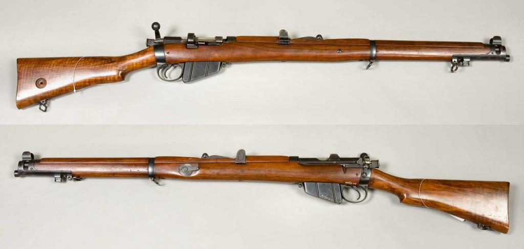

    It's a start. Those bodies belong to a .303" Lee Enfield..., the No1 Mk3. The scope mounts you showed us belong to another type of rifle and they won't fit the body shown above.

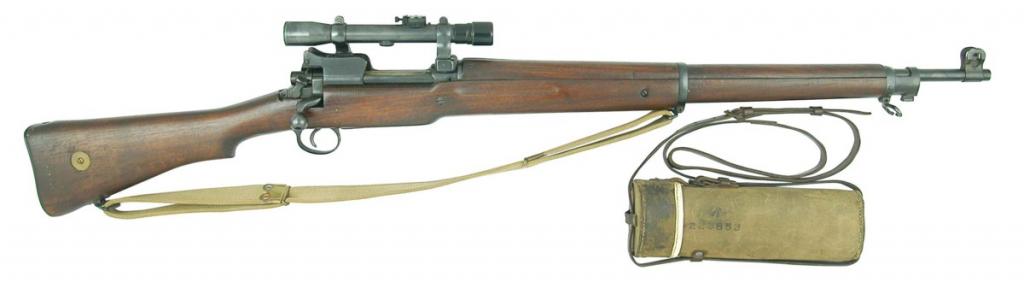

    I think the confusion is based on the mounts you have purchased are from this rifle, a P14:
    And you are trying to place an optic on this rifle, a No.1: (also called a SMLE, No.1 Mark 3 etc.)

    I didn't help matters by mis-reading the OP's original question. I did indeed quote the page showing the fitting of the over head P'14 mounts, as the mounts shown by the OP are indeed for the P'14. I am afraid I didn't notice that his question was aimed at fitting claw mounts to the No1 rifle. Of course the P'14 mounts are similar to both those used by Lithgowicon on the No1 MkIII H T & on the little known SMLE snipers produced by Periscopic Prism Company in 1918/19, but they are not the same. Another brain fXXt on my part! I need another holiday.....
