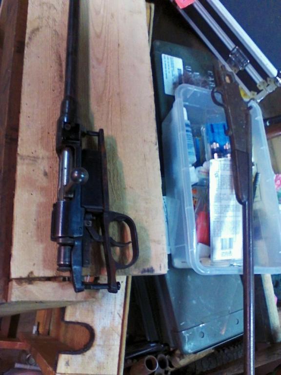

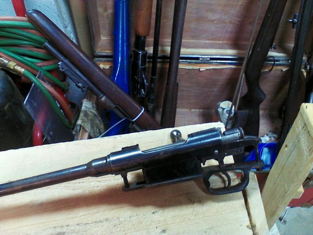

    The glue? Oh, it's a secret formula handed down from my Great Grandfather who learned of it from a 100 year old Master Germanicon stock maker. Sorry can't share it. What I can share are pics of what's next,,,freshening up and blueing of the screws and sling mount.
    Attachment 71828
    This one was one of those where every flat surface in your shop is littered with tools and materials.
    Attachment 71829Attachment 71830
    Attachment 71831
    I added an oak patch over the extra sling mount which houses a few of the pins. Used oak because Bubba used oak as the pistol grip. A view of the longest pin extending through the tang to just behind the pistol grip. This took care of a crack on the wrist and tied everything together nicely. Inside the barrel channel are pins running from the recoil lug to my fingers on the right side to join the horizontal cracks in the forearm,you can't see them but they're there.
    Attachment 71832Attachment 71833
    The buttstock had a chunk missing. Rather then splice in a patch I opted early on to make it appear as a knot. Turned out well I think.
    Attachment 71834
    Thank you Mike for the commission. It was a fun challenge, I hope you like.

    Very well done! That's the kind of challenge that is fun to work on. As long as someone else hasn't put glue in the splits before, it's usually very surprising how good this type of repair can be when it's done carefully. I often put reinforcing dowel pins across the splits when they are serious (or when parts were completely apart like these ones).
    Great work, well done,
    Lou
