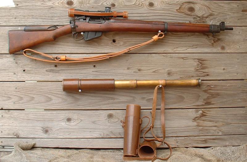

    Sure will. Nice photograph by the way.
    Ian.
