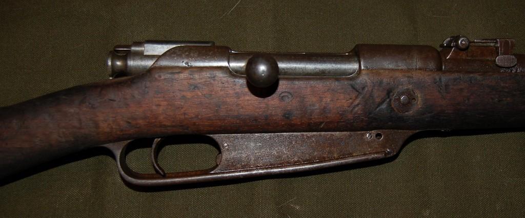

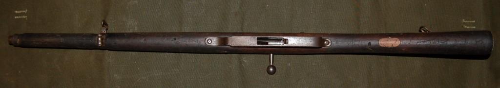

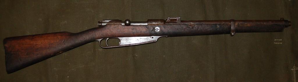

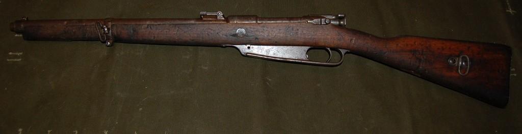

    I have four separate sources that list the sale of the rifles from Germanyicon to Ecuador between 1898 and 1904. The exact date is in question, the time frame or the seller is not. These sources include the importer who purchased them and got his information from Ecuador. These same sources also indicate that Ecuador returned rifles to the Czechicon's to be rebarrelled when they became worn out. The new barrels were kept in the same original caliber as the initial sale rifles. What is also not clear is whether the carbines were part of the original sale or a secondary sale. Granted not a lot of information out there but there is at least some documentation for this and oddly enough, some of what Bob believes fits in, the involvement of the Czech's for one. What he believes was a sale was instead a refurbishment.
    But really, I didn't start this thread to turn into another one of the senseless 88 Commission rifle arguments. I wanted to show a little known example and my efforts to stabilize and restore it.
    In that note, I cleaned and washed the stock. Most of it is solid with the exception of the front 6 inches. Seems OK but shows indications of some dry rot on the interior. Does not extend to the exterior of the wood. A lot of the dents worked themselves out without me doing anything other than running hot water in the shower on it. Still plenty left. A few things showed up, a pair of crowns on the underside behind the trigger guard. Faint but there. There is a A J carved into the butt and an A carved into the middle of the stock. I noticed the A's but not the J prior.

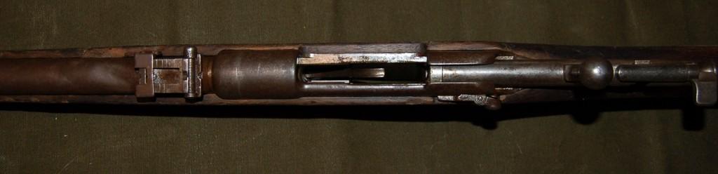

    Stock is cleaned. Metal is cleared of the vast majority of rust and it's put back together, oiled. Coated with BLOicon and it looks as bad as it did before I started. Man this is an ugly rifle. But I like it. Still need to fix the end cap and I think I will get something to fill the pitting in the shroud. Rust did eat it's way through it with two pin head sized holes.

    Thinking about doing a full restore on this. JB weld the shroud, smooth and krylon black paint. Steam the stock, replace bad wood (cut it out). Polish the metal, cold blue. It's in poor condition now so not likely to harm the value such as it is.
    What do you guys think?

    The receiver would have originally been in the white and the barrel shroud blued. I personally would try to replicate that (I also love in the white parts despite the lack of practicality).
