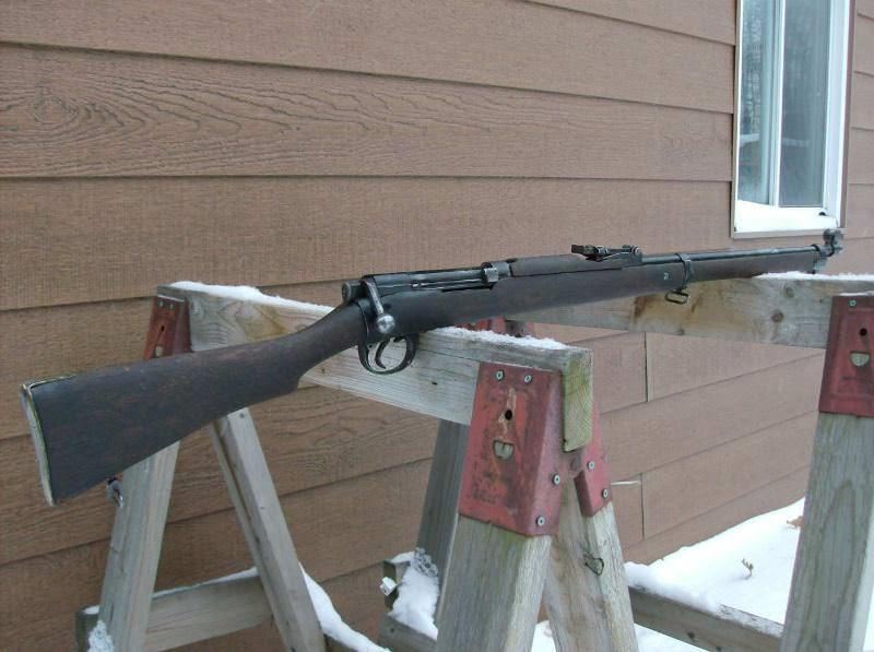

    Things went rather well, but it took time. I cleaned each part individually. From the extractor retaining screw to the front volley sight arm, not forgetting the rear sight leaf spring retaining screw Everything was taken apart and cleaned.

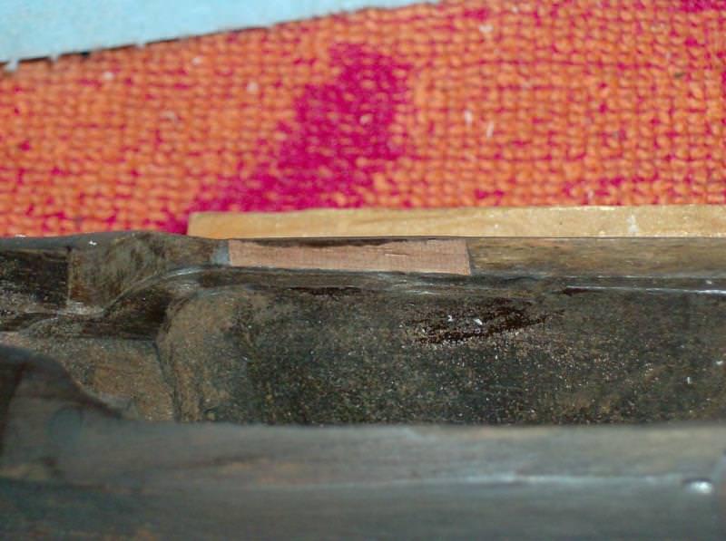

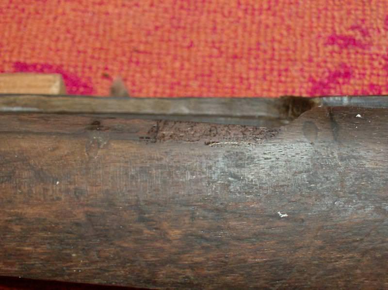

    The repair of the forend, around the trigger guard, went well too. I had to replace one small piece (probably 1/2" long), but it's now solid enough and should last a few decades.
    From inside:
    From outside, stained:

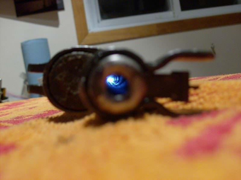

    The bore was bad. Really bad. My normal cleaning rod (which usually goes through a .22 bore without a glitch) initially got stuck in the bore, because there wasn't enough clearance. So I began by plugging the muzzle and filling the bore with a de-rusting solution, which opened things up a bit. Then, I switched to bore cleaner (filled up the bore for a few hours as well). After a few hours of brushing, there was some rifling visible! And pitting. There is pitting in there, we can't really avoid this.
    But, you know what? It shoots well enough to say: it's alive!

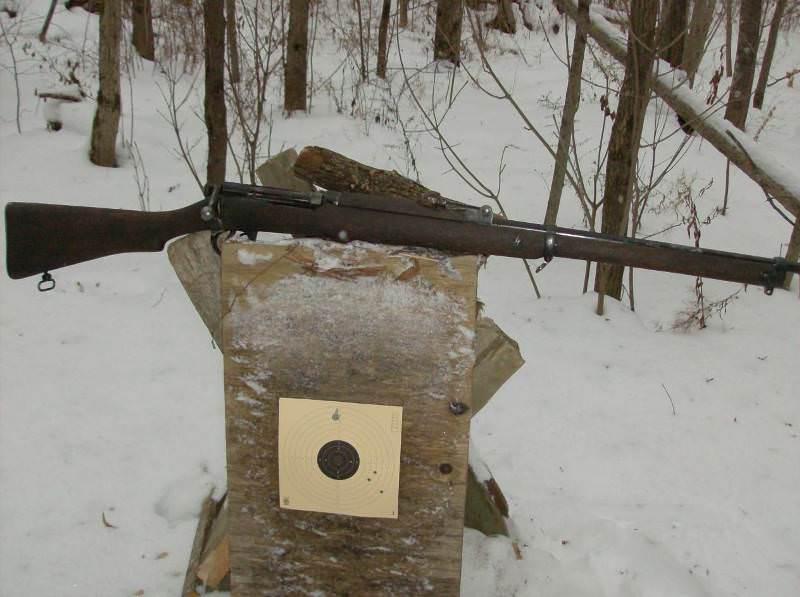

    Further more, testing it in my backyard with CCI "quiet" .22 shorts (because neighbours and so forth), I am very happy to report that, at about 25 yards, we have rasonable grouping!

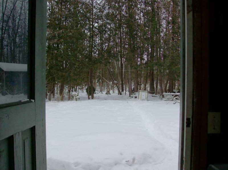

    My "backyard range" (target is in the middle, behind the bird feeder - not the one on the right)
