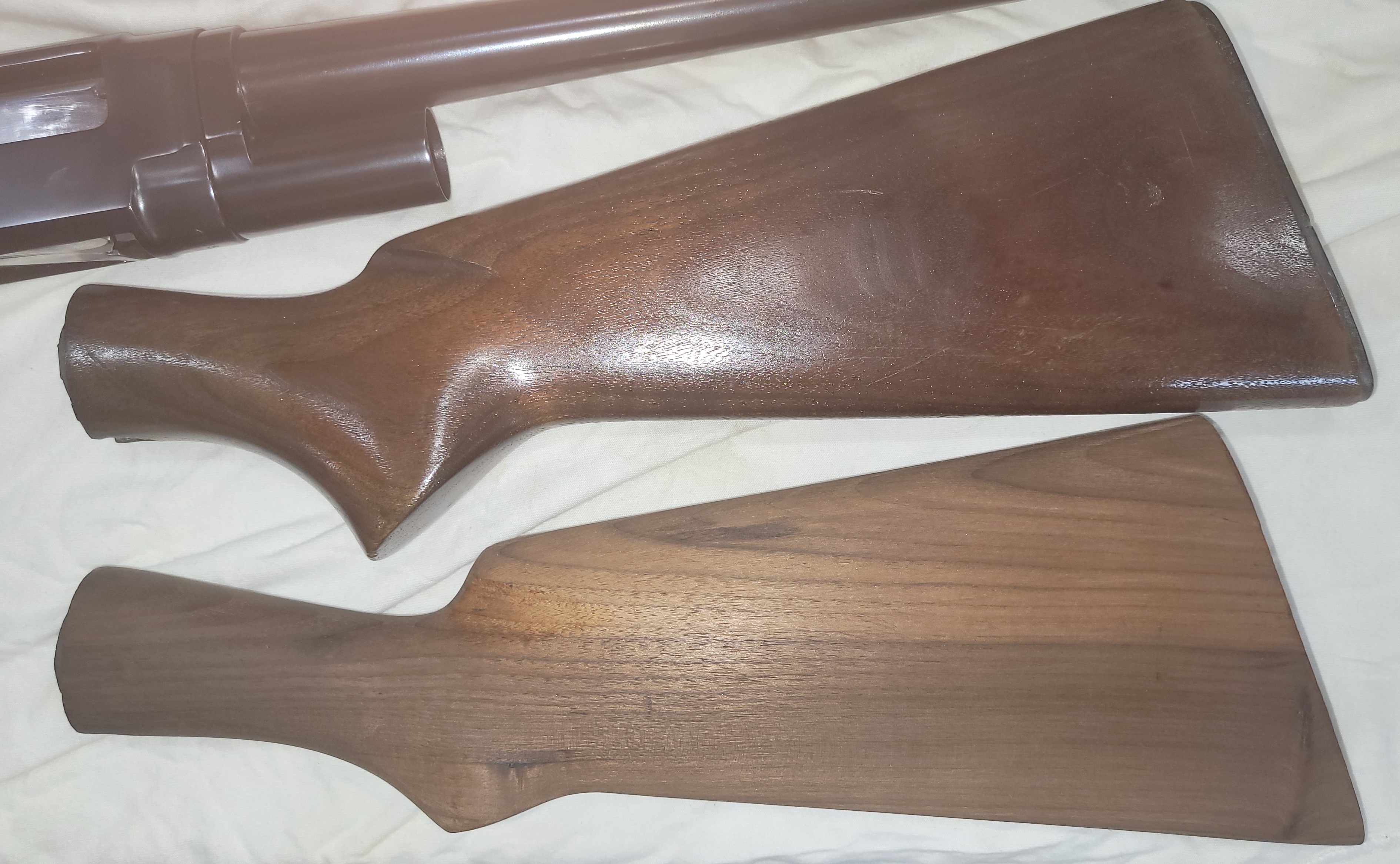

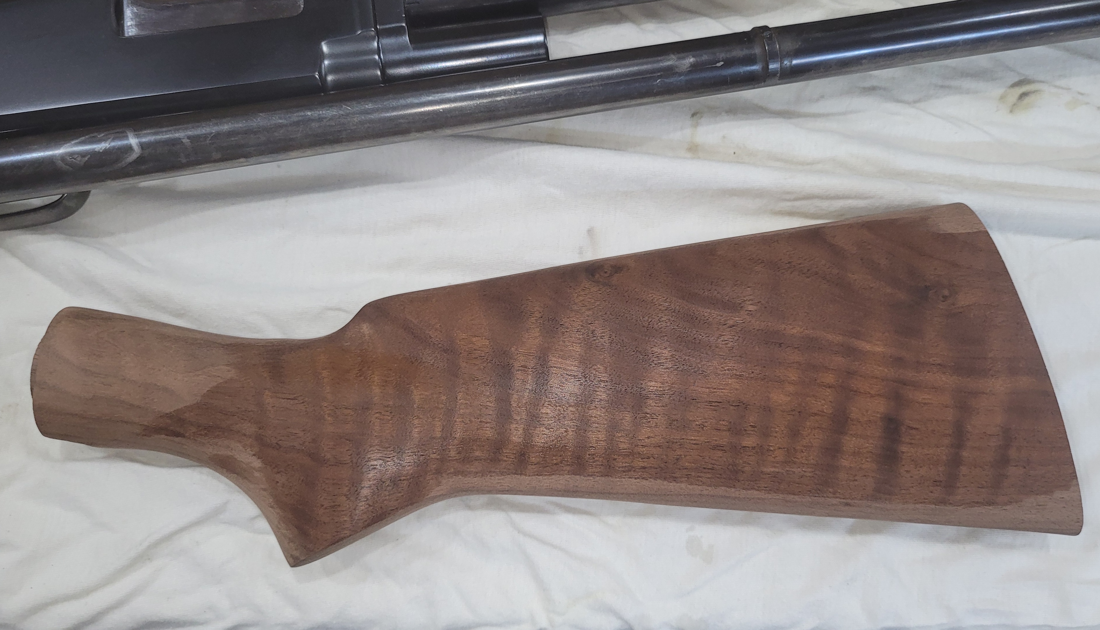

    So this is the next stagnated project in line for clearing out. During the long wait, I was able to find an original stock - without a crack in the wrist, still full length with original buttplate - and at a very cheap price. I was also able to source some 1/4 thick buffalo horn plates for ~$30. I think I'm going to forgo the Boyd's stock though in favor of the original replacement I found. Should clean up nice. Save the horn for something else down the road. Sad though. It really is a nice piece of walnut - worth putting a rubber pad on and finishing at least.
    Replacement stock is the shiny one. Bubba clearly sprayed it with a rattle can clear coat.

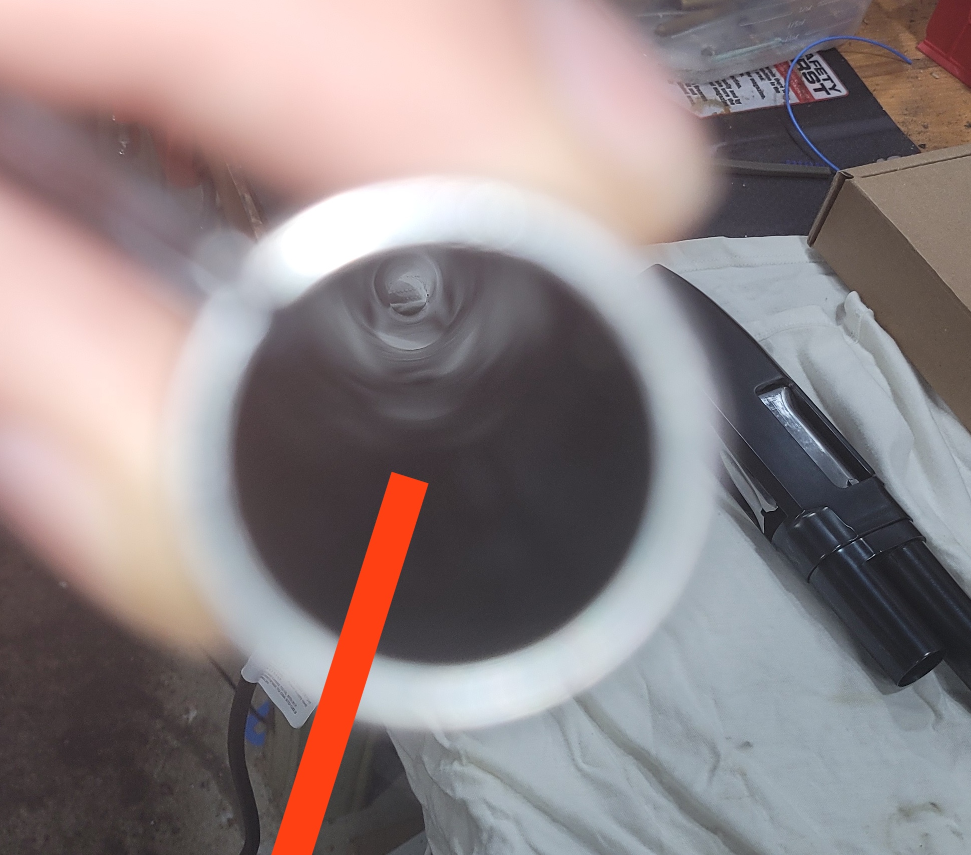

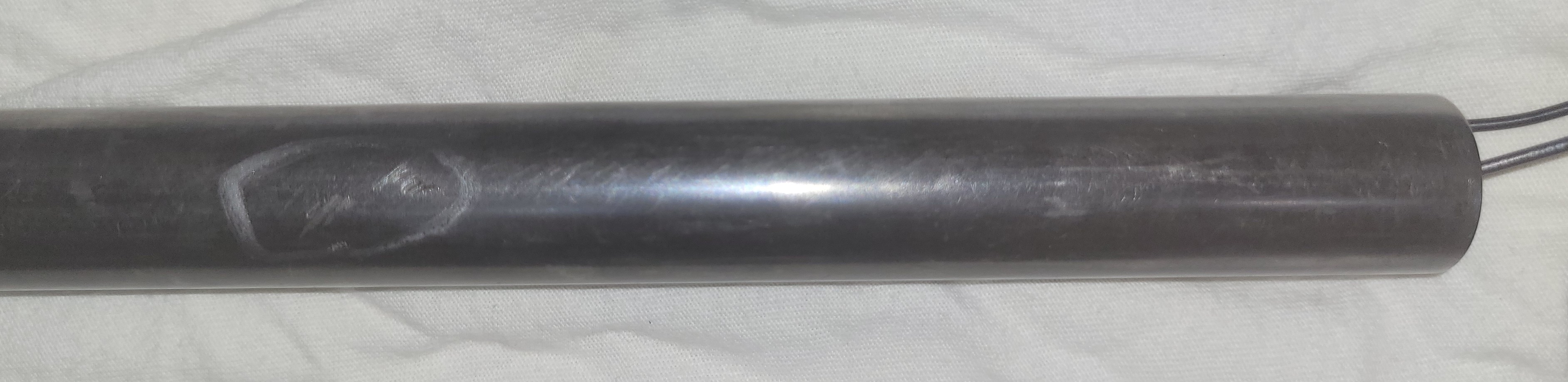

    I have two forends to prep, blue and assemble. The 20" riot barrel is already done in my last update. The original 30" full choke has a small dent - a very hard picture to take when too lazy to get out the borecam. You can make it out where the line is pointing. I've circled the offending area of the exterior. Looks lke it was dropped and maybe scraped a rock. I'll likely wait to polish and blue the barrel until I can rent a dent raiser - which I already need to do for that ithaca SxS I'm nearly done with. Soon, I hope.

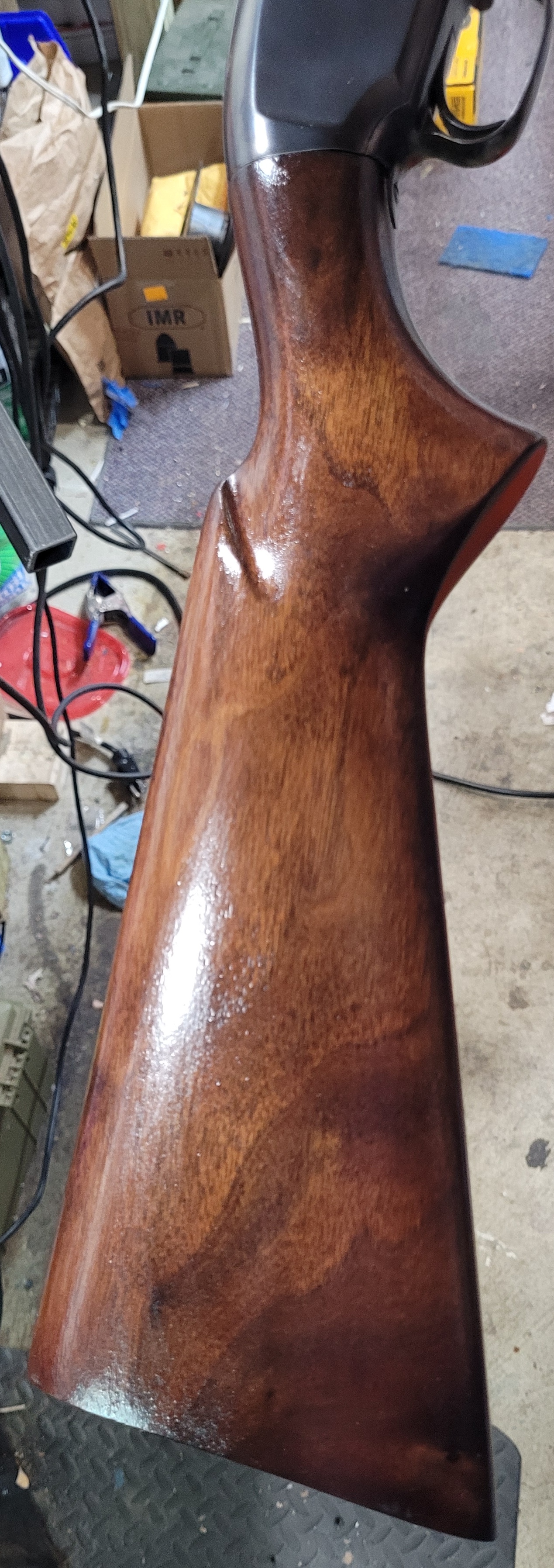

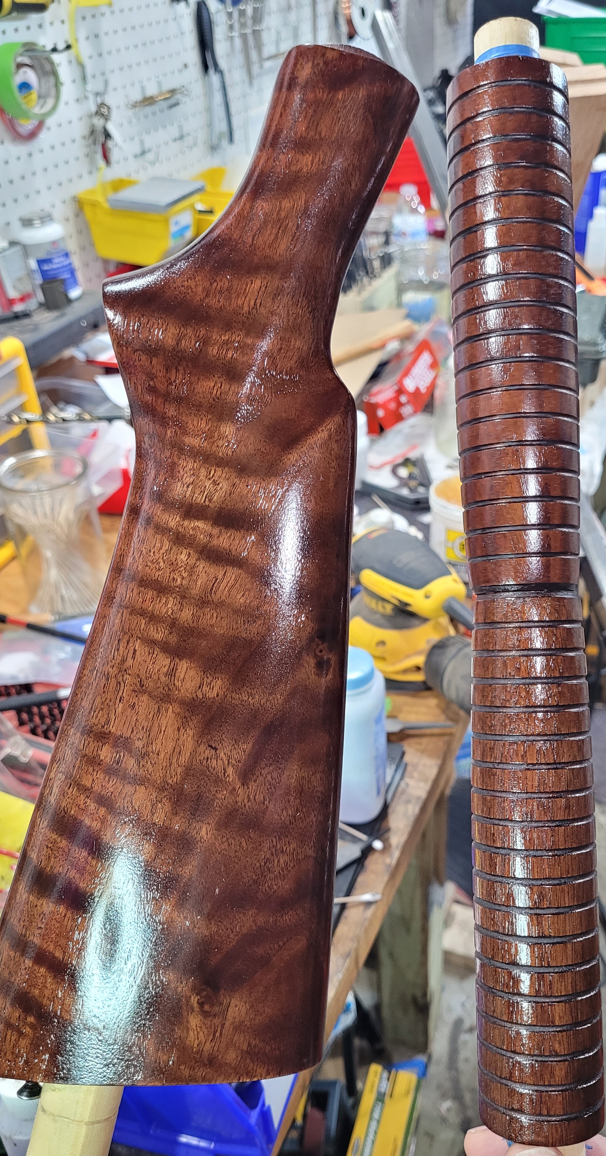

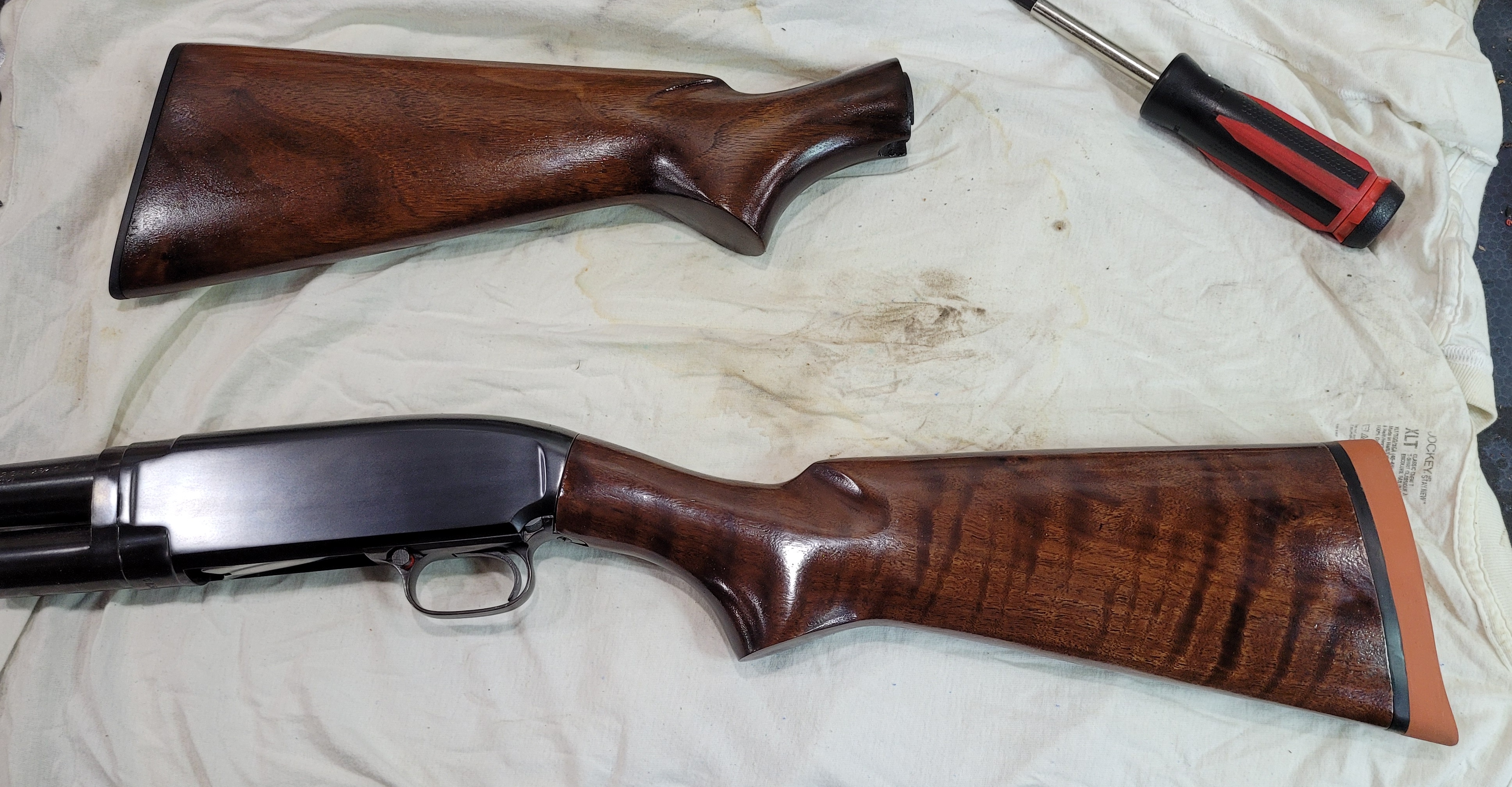

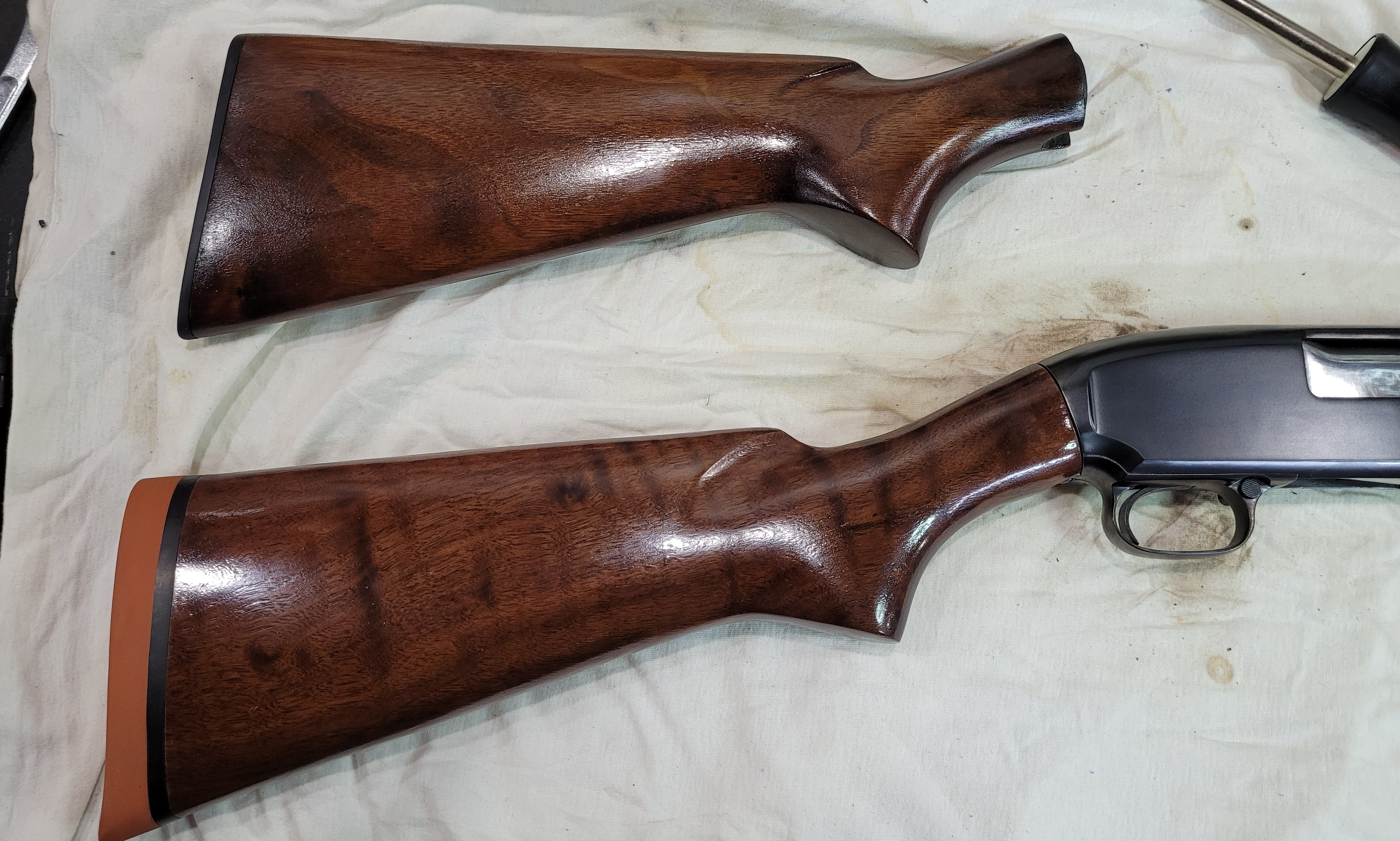

    I was able to get a repop winchester rubber pad, and it will work with the Boyd's replacement stock. I fitted it a couple weeks ago, and started applying finish all the stocks I had on hand. Now I have a real problem - deciding which to use. I'm open to being persuaded at this point.
    First up - the original stock that was on the gun. I repaired the crack with threaded pins and acraglas. The finish is my own alkanet stain and red oil. Grain was purposefully not filled, but the dents and scratches were removed to at least make it look used but well cared for. The lighting shows off the repair more than it actually looks in person. It passes the 10ft stare test.
    Second option - the used original stock. Plenty of dents needed steamed outlet and it needed a new buttplate fit. All that is left is to lightly scuff back the final finish and wax.
    Last option - the Boyds stock with repro rubber recoil pad - not affixed in this pic because I have a couple more weeks of finish applications to go. But it's starting to look as is it should.
    I suppose I will need to see them on a fully assembled gun, but I'm still polishing parts between applications of finish on the stocks. Once I decide, I will sell the others, so if anyone on this forum needs a good model 12 stock, shoot me a PM. You can have dibs before I put them on fleabay.

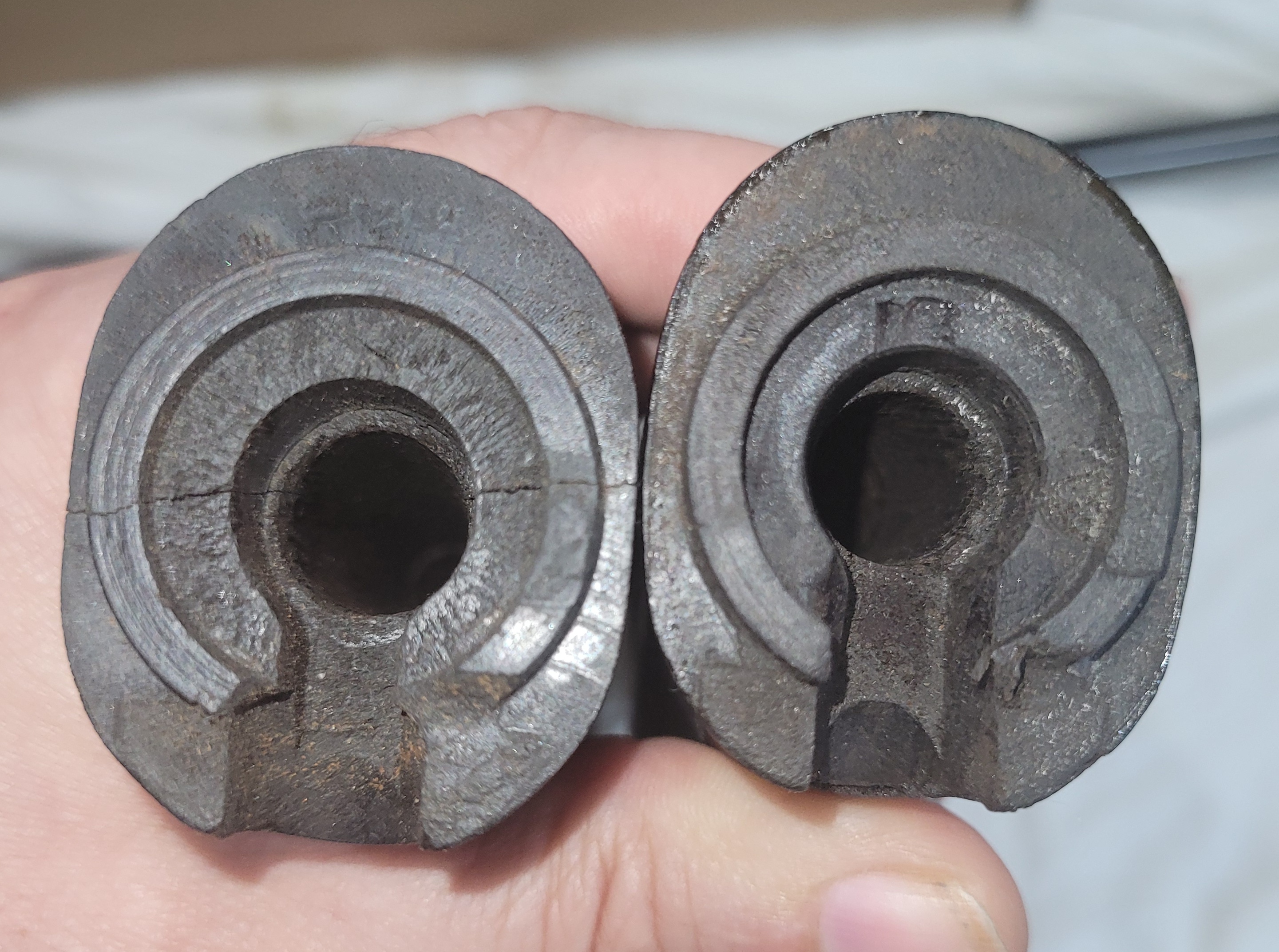

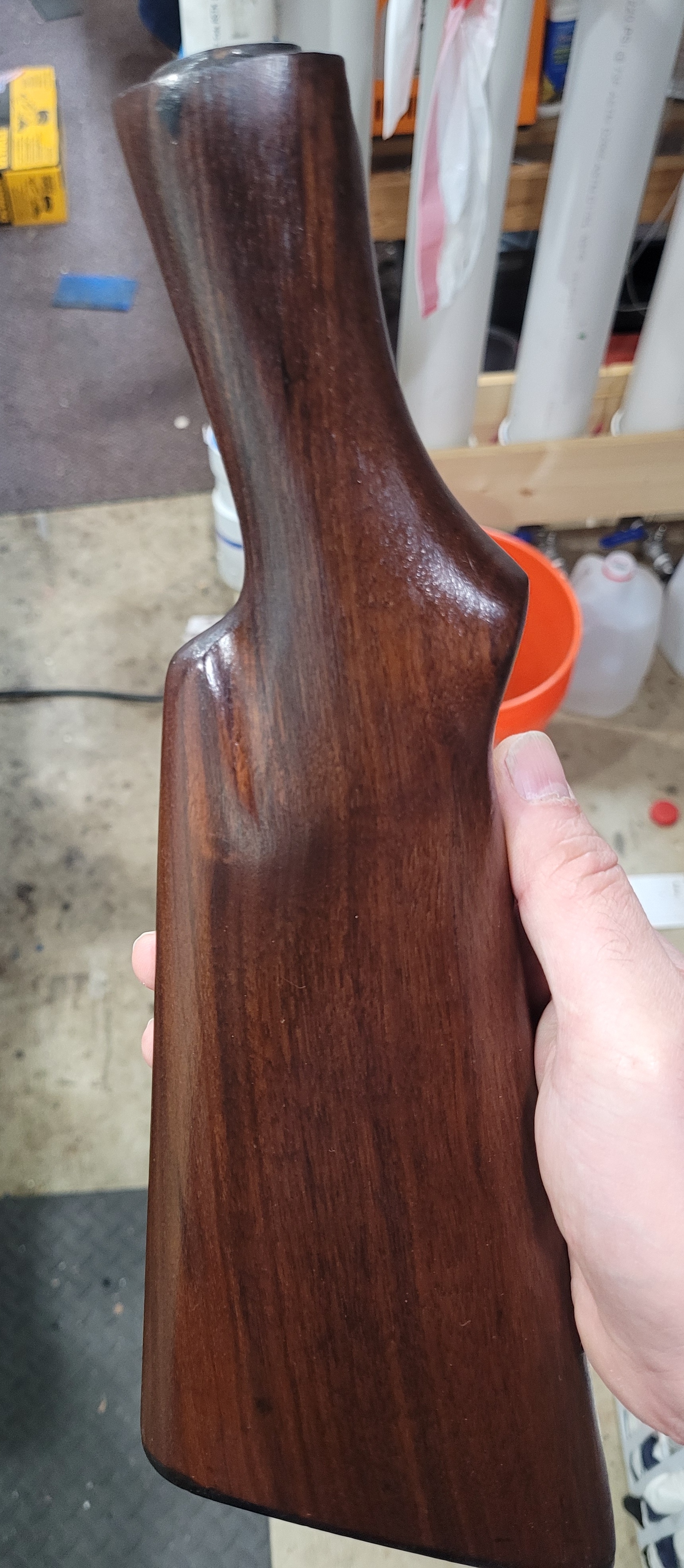

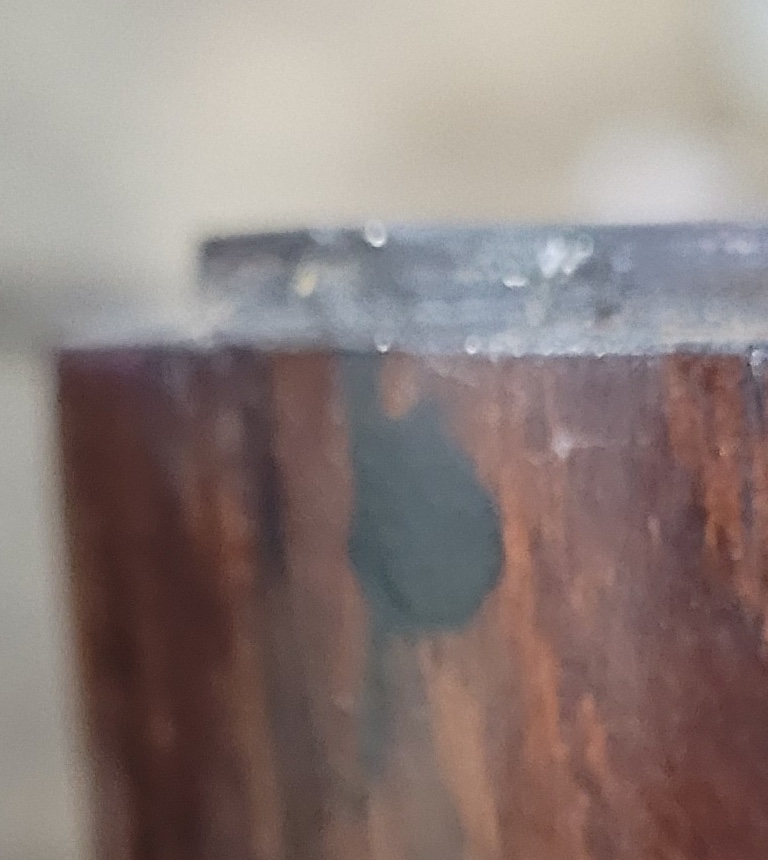

    Ok, so boyds' replacements aren't entirely a waste. In addition to the wrong butt length though, there was 0 (zero) material at the wrist to work with. On either side the woods' edge is just barely below the metal.
    But I think it came out as good as it could. The fit is a little sloppy unlike the original which is nice and tight, so I will need to bed the socket. You might think I should have done this before finishing, but it is much easier to clean epoxy off of a finished and waxed stock and touch up the finish then it is to clean from bare wood and I was afraid to remove any material around the edges.
    Next up is to blue the forends, and fix and blue the 30" barrel.
