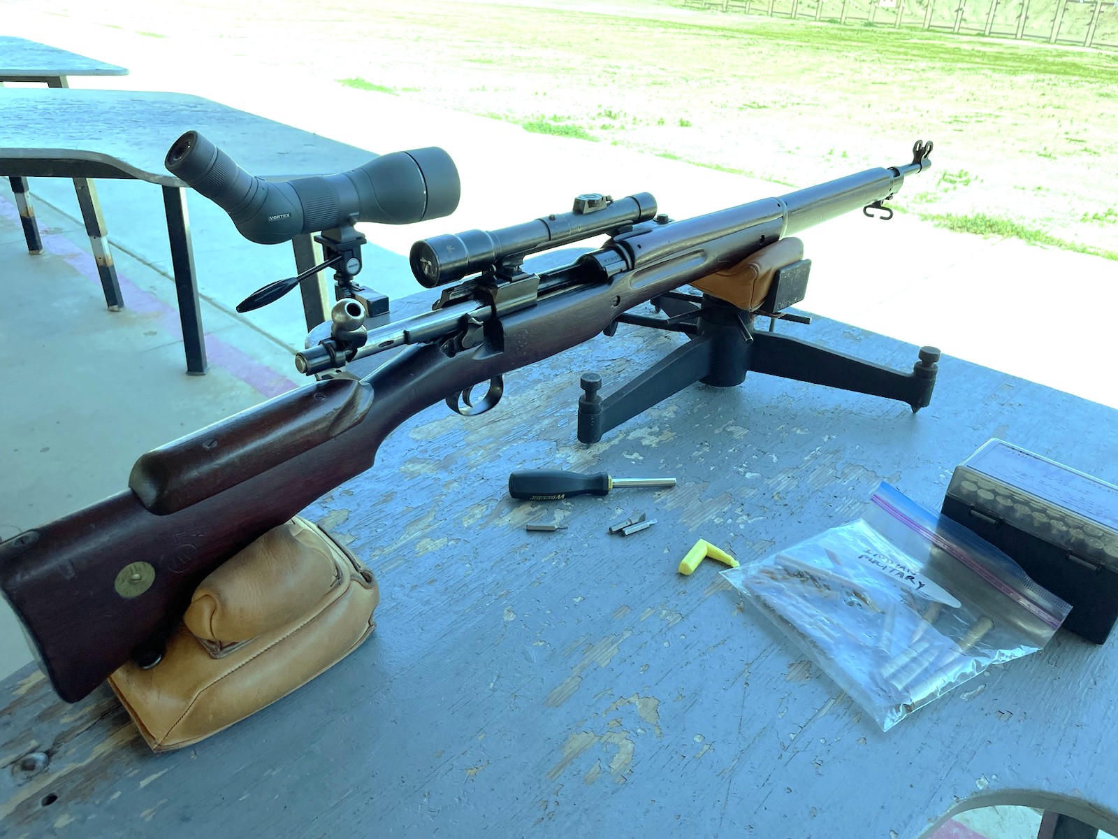

    Well, I took this rifle out to the range today. I found the section in Skennertons "The Britishicon Sniper" on how to zero this scope in its mount. Pretty straight forward, but nerve wracking. I was petrified I would lose one of the tiny grub screws. Anyways, did a quick bore sight and adjustment for windage. I was using some surplus Indian Mk7 ammo. First ten rounds produced a decent group, albeit 12 inches over the POA.

    But...., there is always room for improvement. This scope is slightly out of focus, so trying to shoot a blurry target is not ideal. Gotta read up on how to focus the Aldis.
    I appreciate all the nice comments, and I'll post more when I get more proficient with this rifle and scope. The offset scope does take some getting used to, and I'll be the first to admit it takes extra concentration as it is neither comfortable nor ergonomic. With the weight of the P14, this thing has very mild recoil.
    Hope you all enjoy.
    Nice to see the "old girl" at the range. What distance were those targets shot at once you were dialed in 100yds?

    There are no anti-backlash springs under the reticules on these Aldis scopes, so it's possible that your vertical dispersion is partly caused by that. Hard to believe, but that error was repeated on the No.32 until well into production.
    Optically those Aldis No.2 and 3 scopes were top quality, it was the mechanics that failed them. Your scope was originally a Holland & Holland fitting on a SMLE by the way.

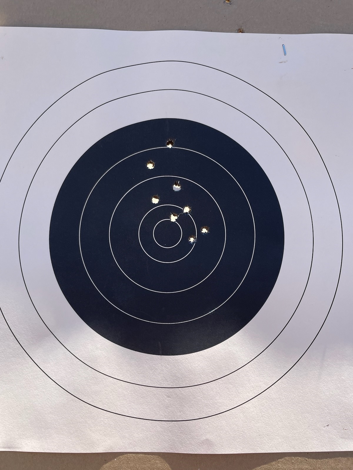

    So after the first range trip, I spent the following days focusing the scope in my garage. Once I was able to obtain a crisp picture, I loaded up a fresh batch of loads and made it to the range.
    At 100 yards (first pic), the rifle prints groups just over 1.5 inches (its advertised standard). I'm sure some reticle backlash is worked into these groups (thanks Surpmil for that info). The scope is 108 years old, so I am not expecting bench-rest sized groups out of it.
    The rifle really starts to shine at 200 yards (second pic). It was very consistent, and aside from the two errant 9-ringers, the majority of rounds fell into the 10 and x rings. All in all, I am very impressed with the accuracy of this rifle. It is awkward to shoot the offset scope, but it is fun nonetheless.
    Next trip will be at the 300 yard line.

    I was finally able to make it to the range today. It was a little warmer than expected, so I was encountering a persistent mirage at 300 yards. After a few small adjustments (I eventually had to set the elevation drum set at "4"), I was able to send 9 rounds into this target. I am still astounded at how well these old optics shoot. This is the furthest distance my local range has. I'm going to have to plan a desert trip to try this rifle/scope combo at distances beyond 300 yards.

    Yes, they shoot alright. All that is required is mounts with no play, a reticule likewise, and little or no parallax. Consider the results achieved with scope-sighted target rifles in the second half of the 19th C.: often as good as most modern rifles and scopes.
