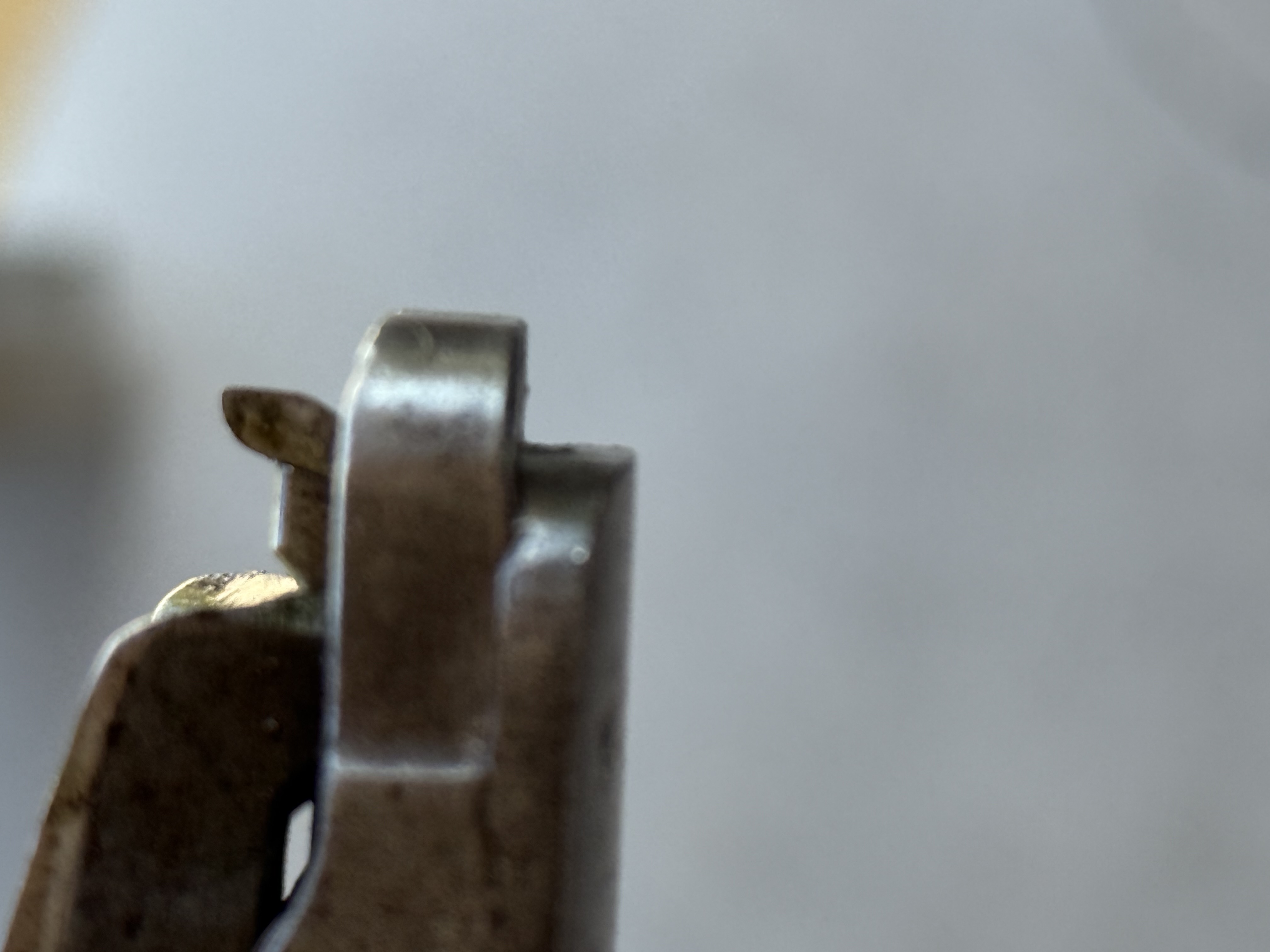

    These side by side says much:

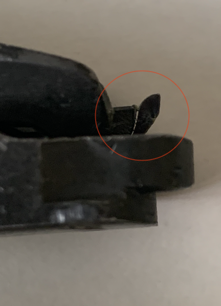

    Is that a crack?

    There ya go. That crack would effectively lower the stop tip just enough to let a round by while working the action robustly enough to operate the lifter.

    Here is the bad boy. Not totally sure as my Frenchicon is nonexistent:

    There are some pretty good vids on U-tube showing the operation of the rifle, and the feeding cycle. As long as it's all apart, looks like it would be worth your while to check the cam on the bottom of the lifter that pivots the stop up. Wear here could limit upward travel of the stop. The leaf spring pushing the stop up is another pertinent piece of the operation. Probably fine, but...
