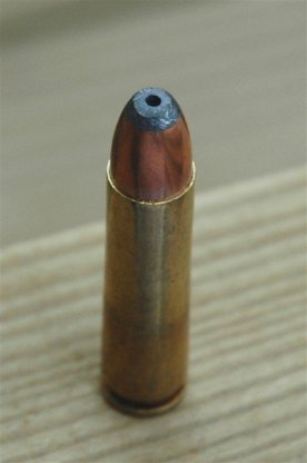

    My favorite load for .30 carbine is 14 grains of H-110 behind a 110 grain soft nosed hollow point.
