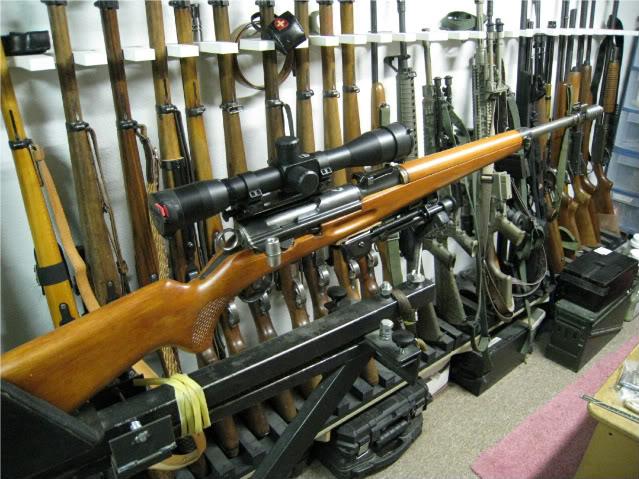

    Great article! Thanks for that. As for the k31 and headspace................
    My Dad has done this for some 45 years or more, and there have been a lot, maybe 80 or more k31's pass through here. We have Go, No Go and Field guages here and not once ever has a k31 here been found to be out of spec. We still have a few of them.
    This is part of the west wall in the armoury.
    My Dad has always specialized in Swissicon rifle load data development, and for the past three years I've joined him. He was so in love with the rifle that he began our second family business, Swiss Products. One of your Mods here is our Canadianicon Distributor.
    We probably have an easy 3,000 GP11 still here, but its' only used in the zfk55 sometimes, so it'll be here a long time. We only use RUAG Swiss National Match brass for reloading.
    As for the GP11, there are still an estimated 7,000,000+ rounds in Switzerland eligible for export.
