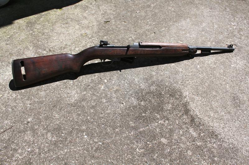

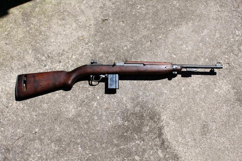

    Finally had a nice day for a photo shoot so here's what I've got
    Appears to have the NPM punch marks on all the major components except the trigger group
    Stock markings look like an AN and a STD Prod rebuld marks. And possibly an IH Inland stock
    Rebuild proof
    Trimble handguard
    Fixed my recoil plate too, just had a bunch of caked up crud underneath it
