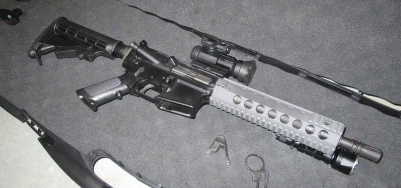

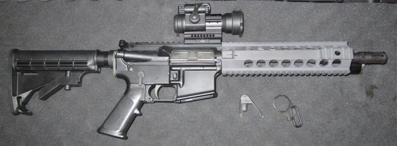

    Spent some quality time with a buddy's AR, my angle grinder and my Dremel, today. Cut the FSB, bayonet lug, and delta ring off and ground down the leftovers to allow a FF handguard to fit over top.

    [QUOTE=Stevo;252477]Spent some quality time with a buddy's AR, my angle grinder and my Dremel, today. Cut the FSB, bayonet lug, and delta ring off and ground down the leftovers to allow a FF handguard to fit over top.
    I couldn't "tap" my pins out so I ended up milling them out on the bridgeport , just because I had to show it who was boss. I should have done it your way, it would have been a lot faster after spending all that time trying to tap them out

    In all honesty, I would have preferred to drive the pins out and reshape the FSB off the barrel. The Norinco ARs have incredibly tight pins, however. I've read lots of reports of guys ruining steel punches and even failing to get the pins out using hydraulic presses. We did take a few whacks at them with a BFH and they didn't move a fraction.
    We could also have cut the FSB off and gone with a clamp-on or set-screw gas block, but my buddy was on a budget and the pinned gas block is superior, IMO, to either the clamp or set-screw gas block.

    I also think the cut down FSB is better than anything you can buy. Having tried the alternatives several times, I finally accepted that "Bubba'd" is better than store bought.
