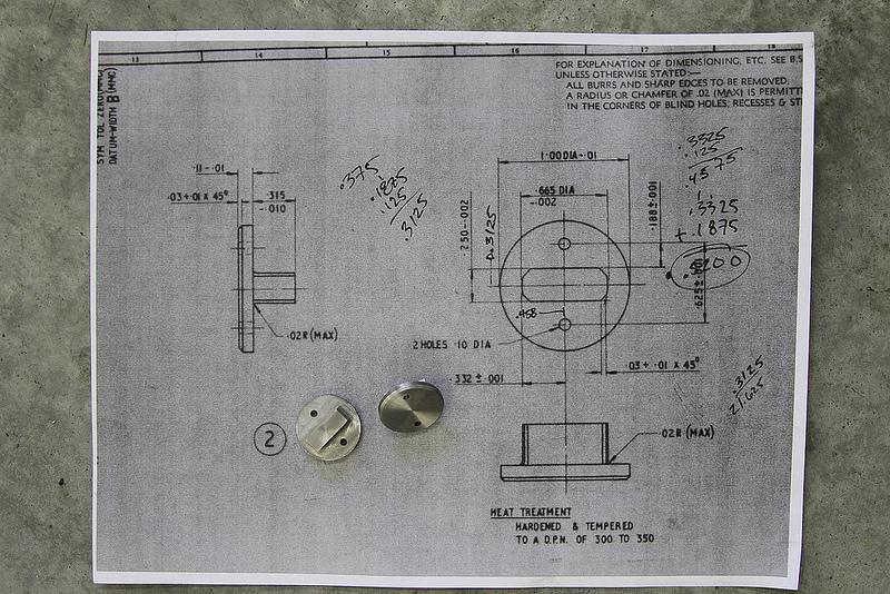

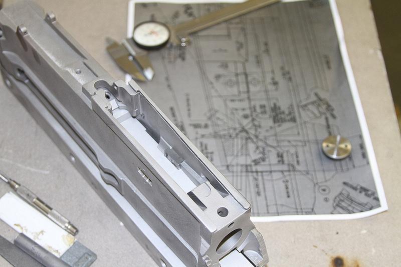

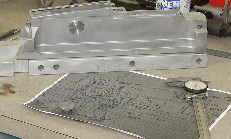

    So here is some more progress. How critical is it to harden the inserts?
    IMG_8678 by c310pilot, on Flickr
    IMG_8683 by c310pilot, on Flickr
    IMG_8684 by c310pilot, on Flickr
  9. #26
    04-20-2025 @ 11:18 AM
    16,645
    05-04-2025
    12:58 PM
    I think that if you made them out of TOUGH material in the first place, that will do. The actual INSERTS only support the otherwise virtually unsupported magazine lips and prevent then from being destroyed.

    Success! A nice tight fitting magazine.
