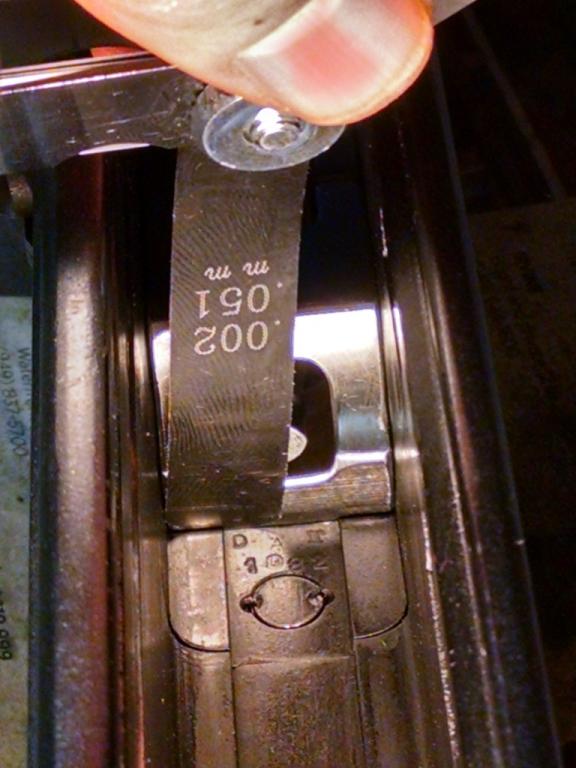

    BAR is dead on. For the Bren you need the proper headspace gage but since the 54R is a rimmed case you can make due with an empty case and some shims and the correct headspace data. You also need the receiver with the barrel and locking shoulder installed and the 54r bolt without the extractor and some feeler gages .002" to .005".
    Very simple to check.
    Somewhere I read that Historic Firearms used some type of adjustable locking shoulder (LS) so that the gun could be easily head-spaced after the receiver was welded up. The LS was slotted so that the LS could be moved in its recess. Great idea but the friction of LS screw cannot take the force of bolt. The LS screw only holds the LS in place. If after head-spacing there was space between the rear of the LS and the LS recess in the receiver it would have to be shimmed, and I assume it was, so that the bolt force goes directly into the receiver. I've never seen one of their Brens so this is just conjecture on my part. Maybe an area to look into.

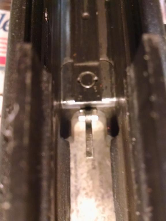

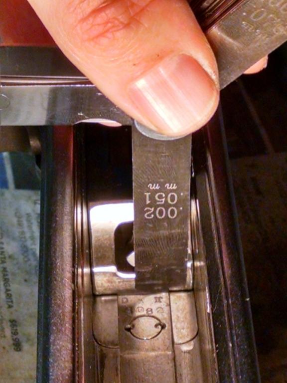

    One problem that used to manifest itself with Brens (and L4 guns) is that you'll NEVER get headspace if, when the breech block lifts up to lock, the outer top surfaces astride the cartridge recess (the areas outside and to the left and right) contact the barrel. The face of the breech block MUST NOT TOUCH the rear face of the barrel. This is called barrel clearance. If it does, it must be stoned down so that it is clear. Only the LOWER left and right surfaces of the breech block should touch anything, and they are the breech block stops.
    The reason why the top outer surfaces of the breech block will occasionally touch the breech face of the barrel is when wear on the barrel seating face*, caused by fair wear and tear and hard use allows the tight barrel to intrude too far into the body.
    If you think about it, CHS is gauged from the front face of the barrel rim seating (or chamber shoulder) to the breech block or bolt face. If some other part of the breech block/bolt face touches the face of the barrel, then no amount of locking shoulder changes will adjust that fixed gap!
    We always check barrel clearance CHS with the breech block hand held in the gun body, less the extractor and stay. Only when the BBlock has been checked for barrel clearance and engagement or touching of the breech block stops will we check for CHS. And ONLY when the CHS had been adjusted/new locking shoulder will the breech block be put onto the piston extension and checked manually using finger pressure on the piston extension to close over the GO gauge. The breech block will NOT close over the NO GO gauge. IN THE CASE OF THE BREN, NOT CLOSE MEANS (while it might LOOK closed) THE PISTON POST CANNOT CONTACT THE FIRING PIN.
    And when the BBlock is closed over the GO gauge, we want a further .002" feeler gap between the locking surface of the breech block and the locking shoulder!
    I hope all that is a clear as mud. What is quite obvious is that some of the builders out there don't understand the mechanical complexities of setting these guns up
    *that's the seating you see looking rearwards into the body when you remove the barrel and barrel nut. These could be re-bushed but only at factory FTR level
    Peter,
    I encountered this exact issue welding up what is called a MGS demill here in the states into a semi. These are later demills and are very difficult to bring back to life. They are not done by the "professional semi builders" in the US. The front cut is through the barrel socket and the middle cut is through the locking shoulder. I found out the hard way that the front weld up affects the location of the breech block stops.
    I had everything fitted up with a go gage and .002" between the rear of the breech block and the locking shoulder. I made one last check and realized the bolt was stopping on the breech block stops and not the gage. I had to grind the LS back for everything to fit up. I had inadvertently built in .030" additional headspace. The 54r would have definitely blown out. I ground the lugs back and had to make a new locking shoulder.
    In retrospect it is very easy to check if you are just using the bolt, and receiver with LS in place and no extractor in the bolt. All springs removed.
