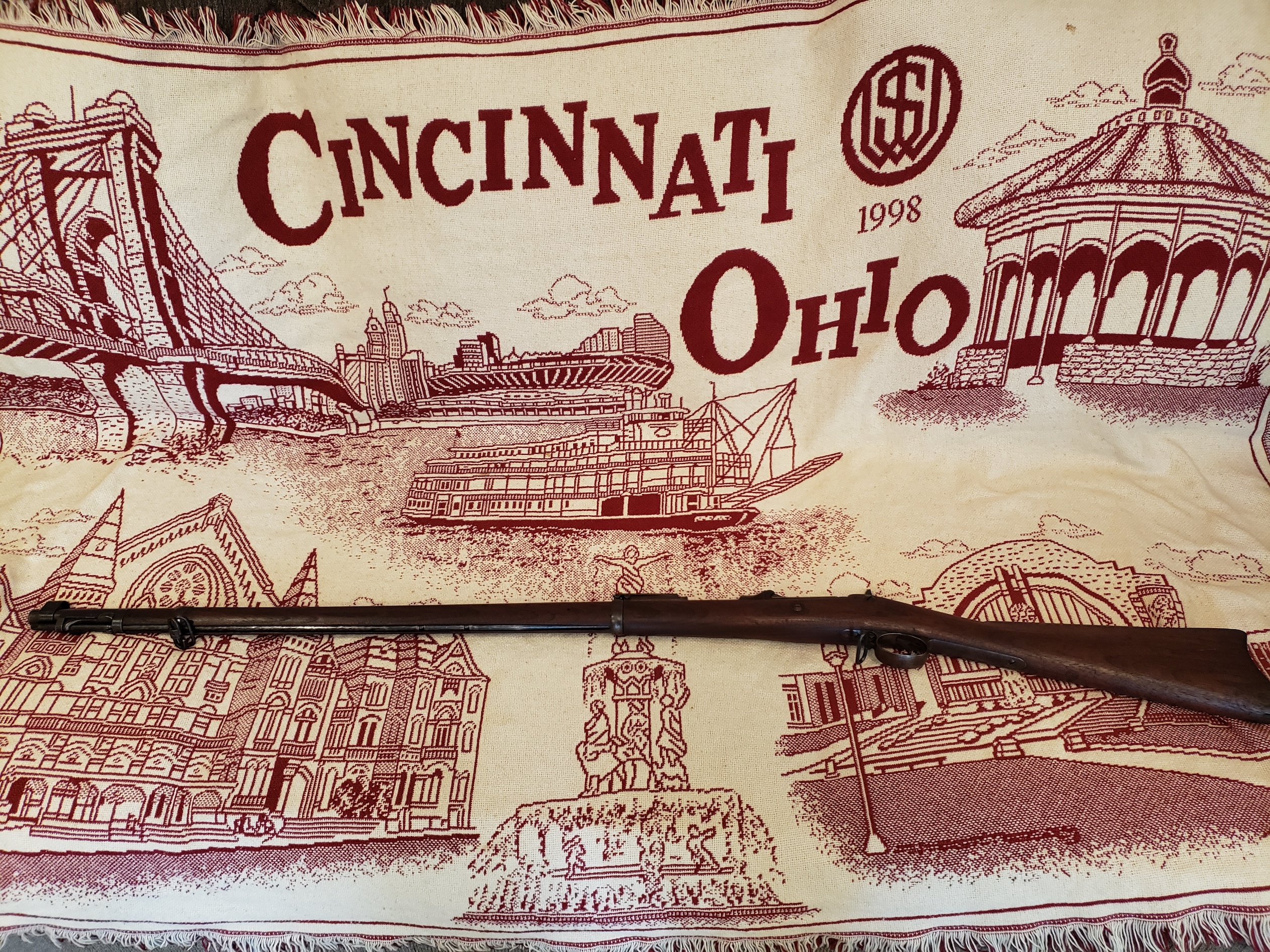

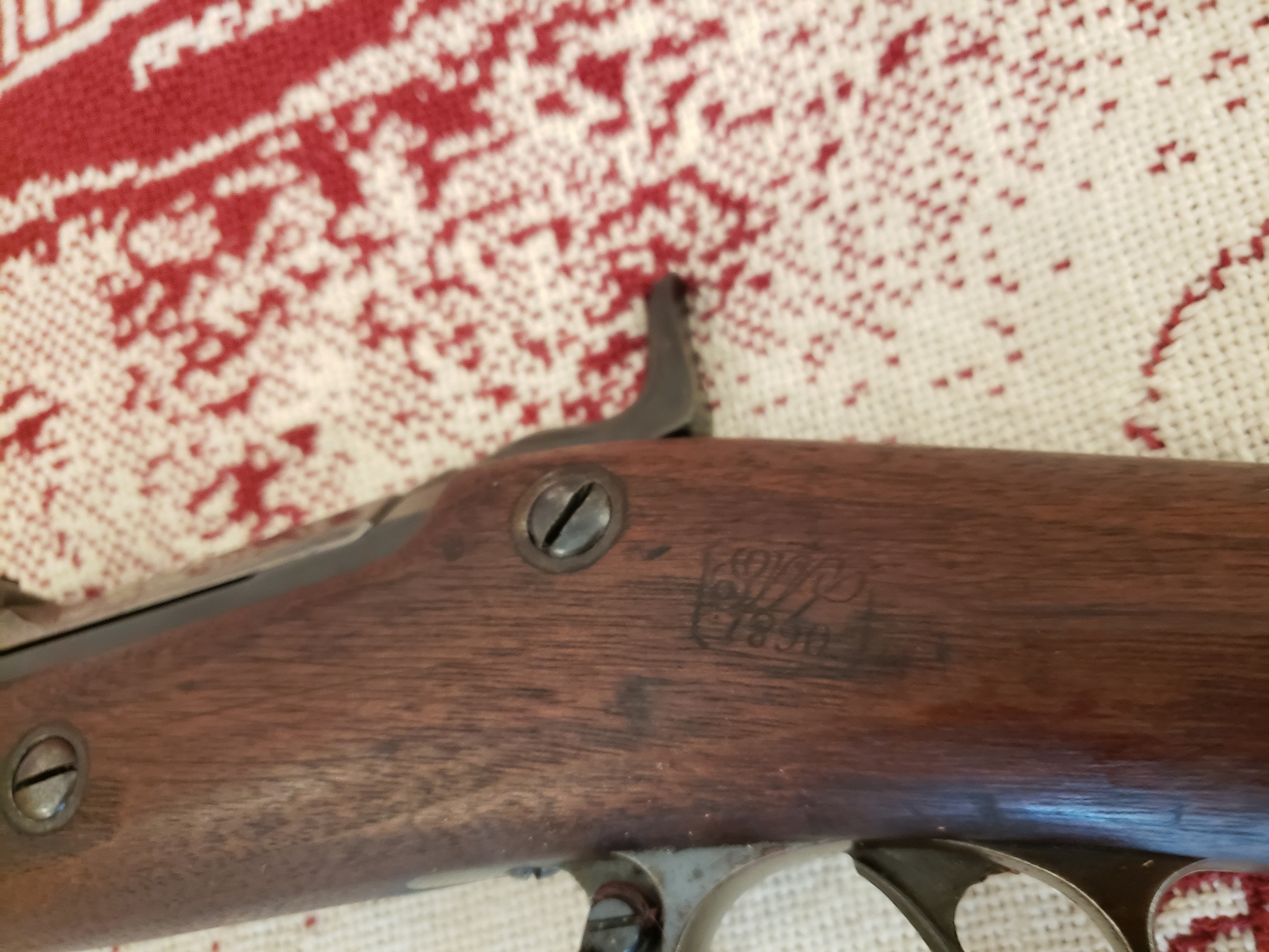

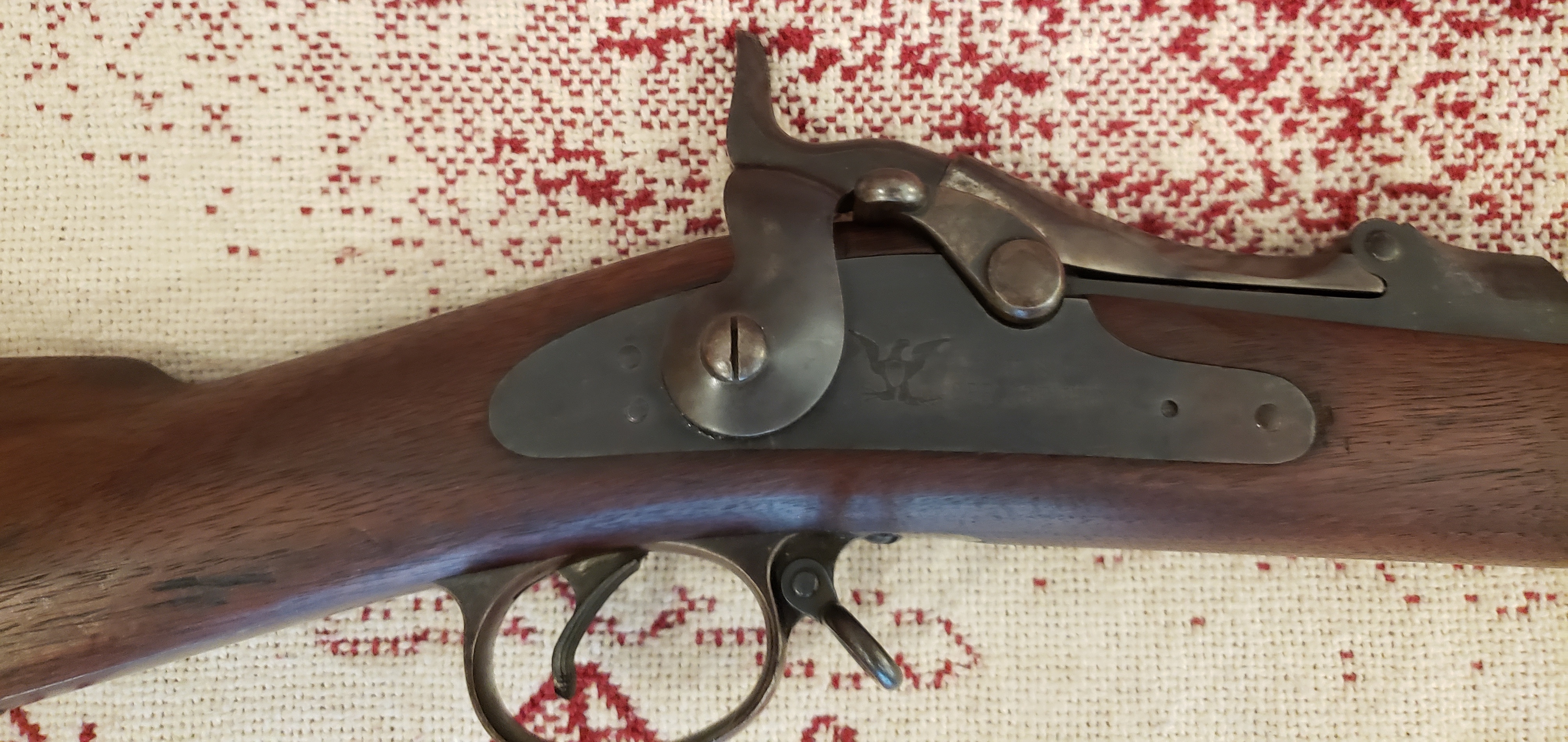

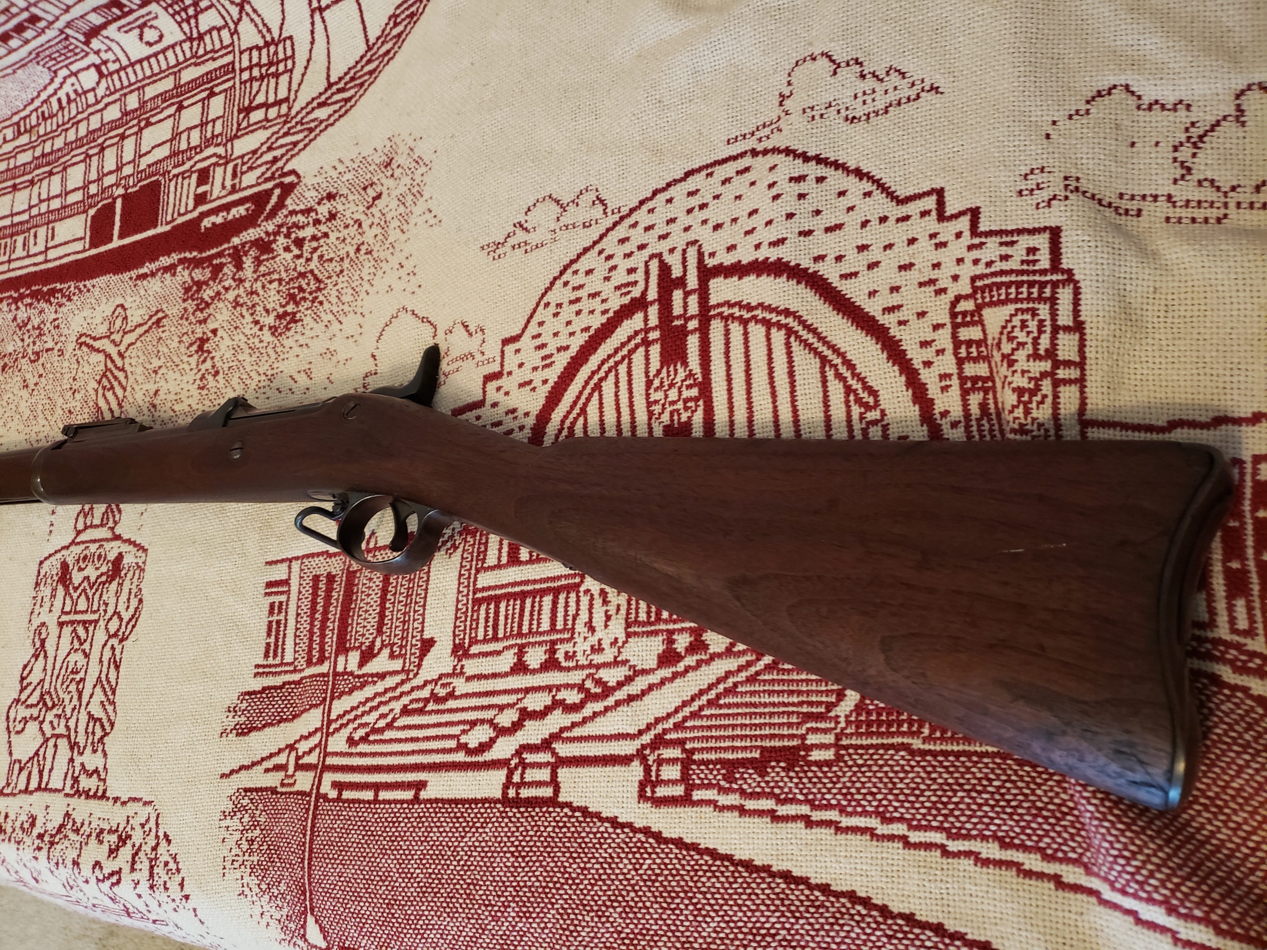

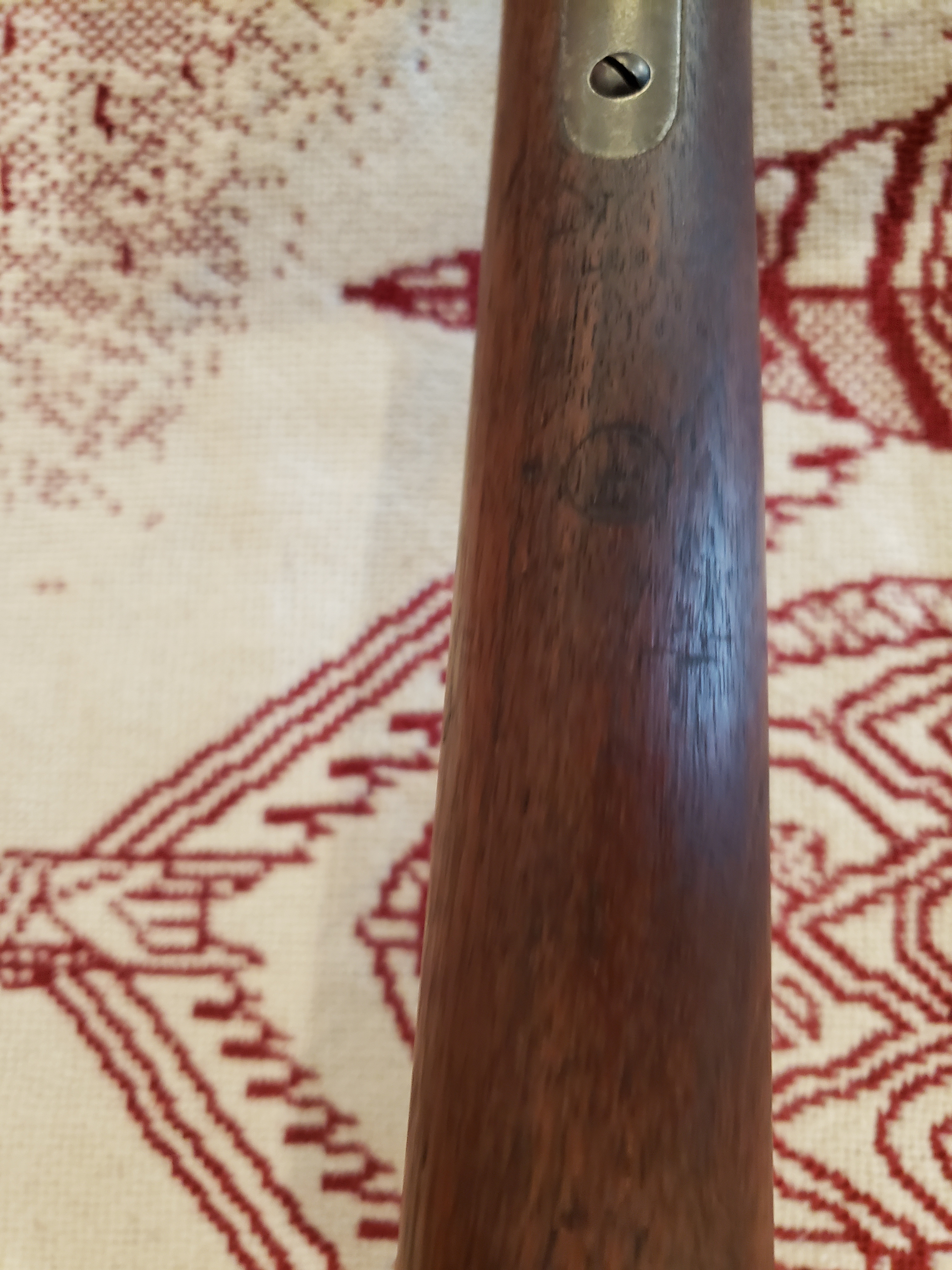

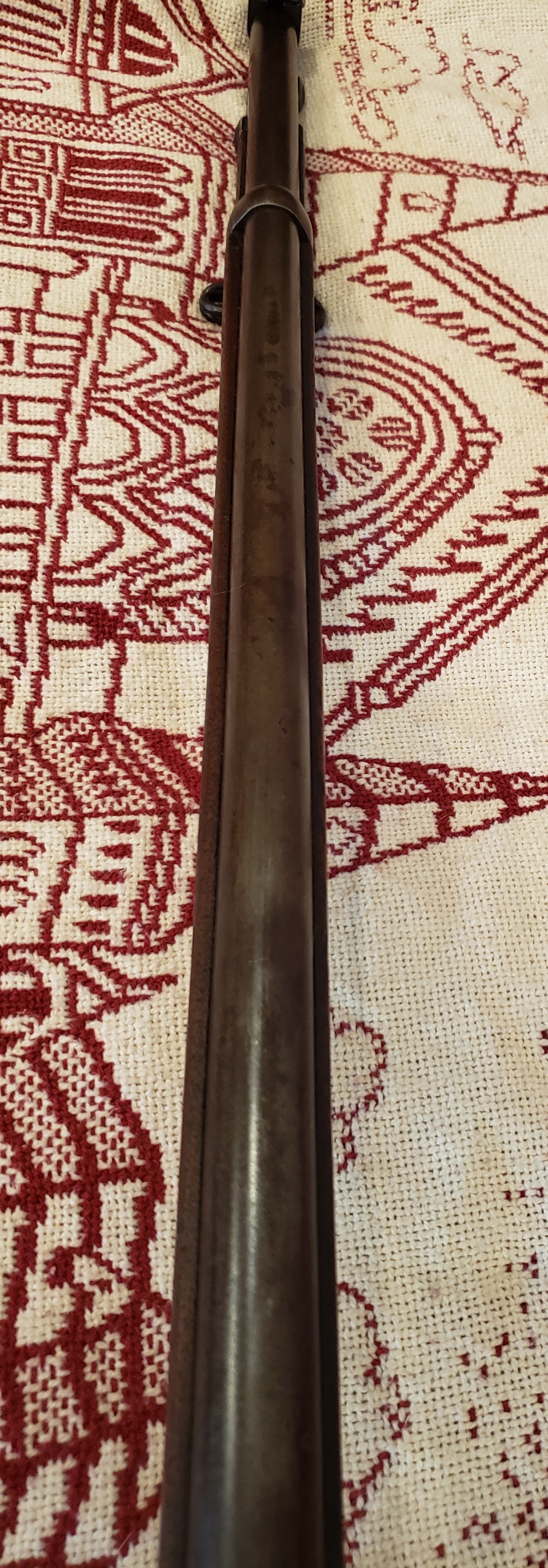

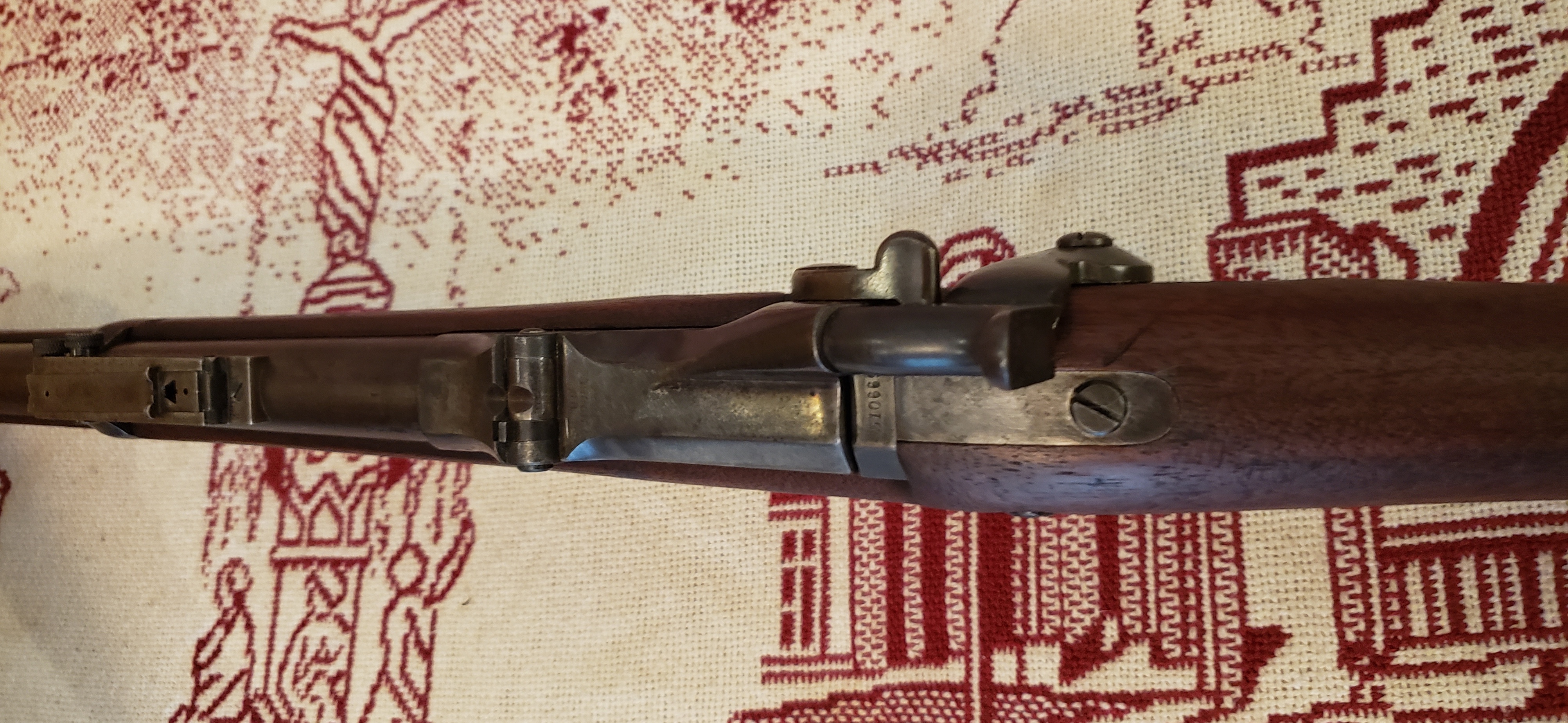

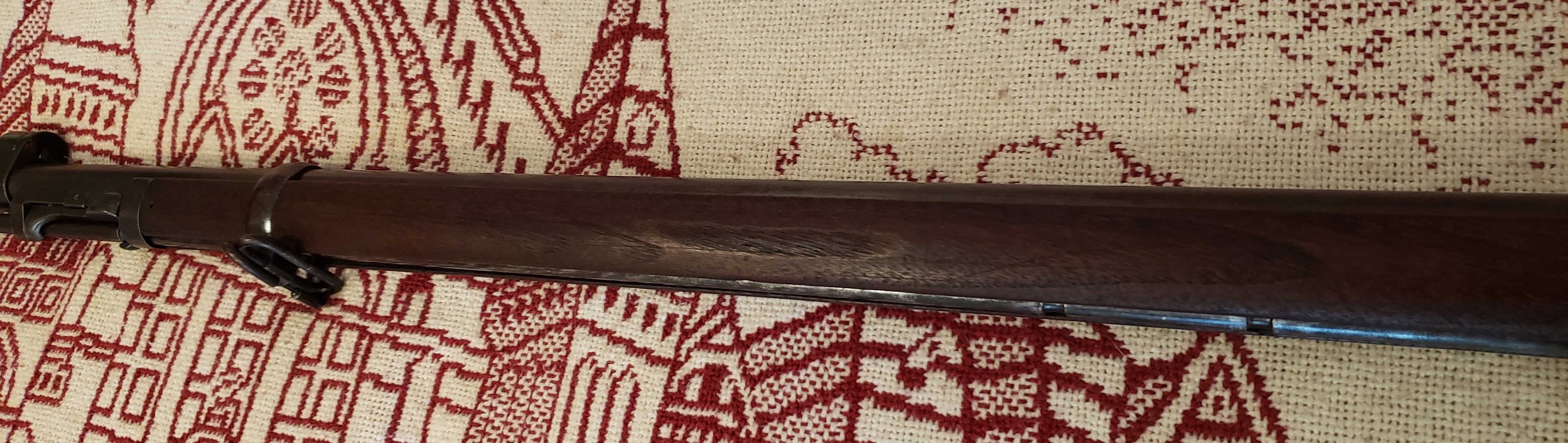

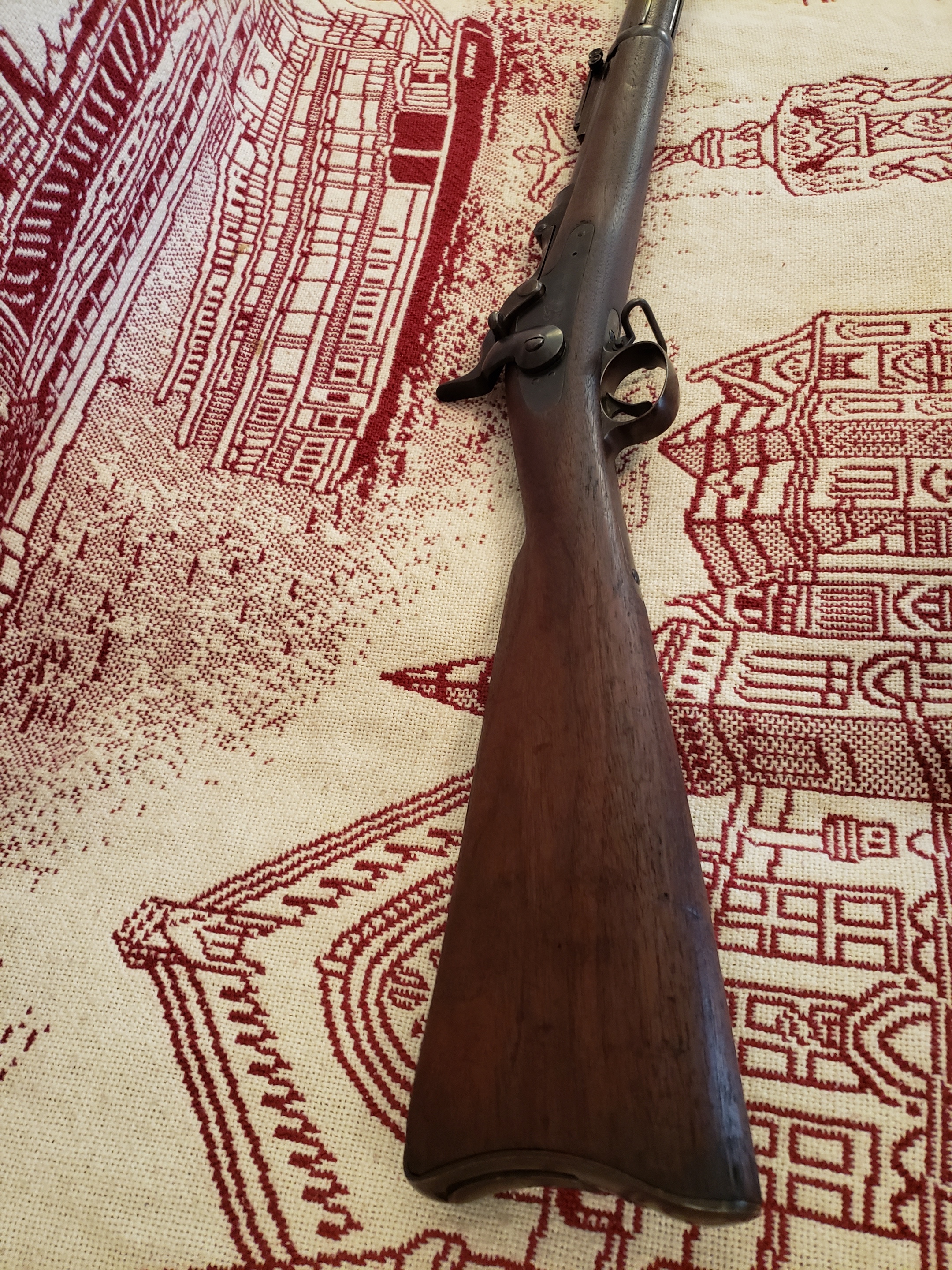

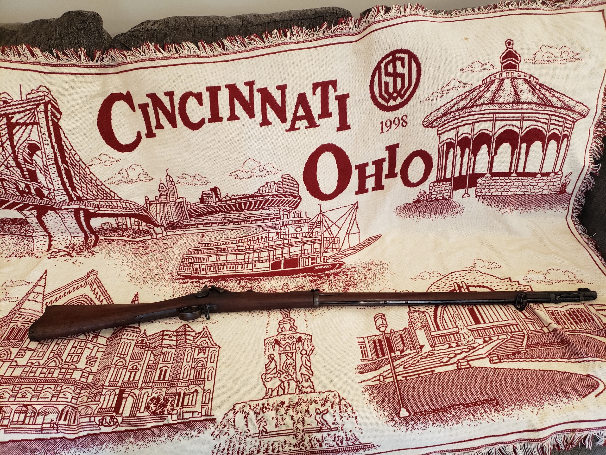

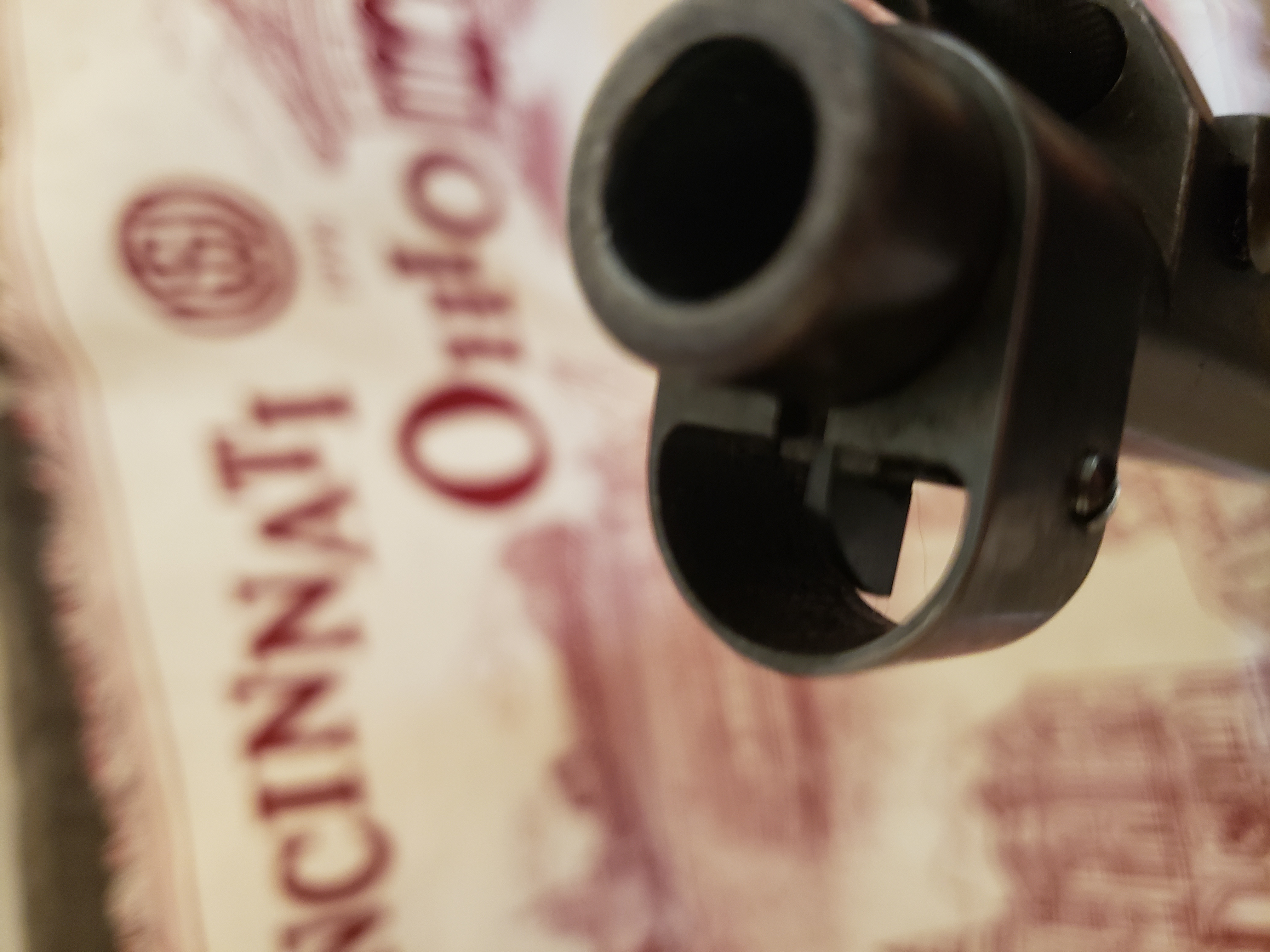

    Pictures!
    Very happy how this turned out. We'll shoot it, and decide if we want to re-cut the crown to fix the heavy cleaning rod wear. I'm guessing nothing spectacular or outright abysmal first time out. That wear is pretty bad, and uneven.
