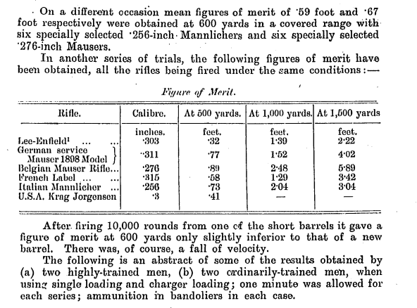

    Yeah Green the Drawing from the SAC is dated 1909 wonder what the short comings were in the accuracy the Brit's were big on long range beaten zones weren't they hence the volley sights is there any literature you may have about the tests Green!

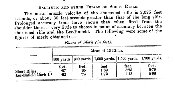

    Here are the comparisons of the 'new' Short Rifle (SMLE) with some of the competitors - showing what Figure of merit each could achieve.
    Dated 1904 source "Rifle Mk1 Short" Report written by the Director Of Artillery

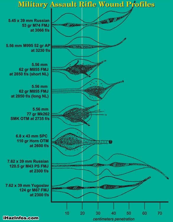

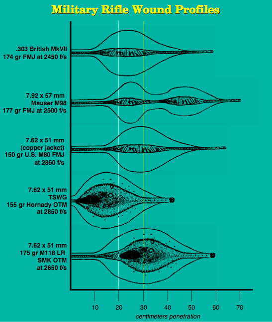

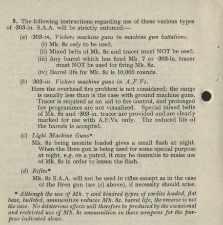

    MK8s were 'primarily' used for MGs but their use was also 'allowed' in rifles 'Stens' etc whilst doing night patrols (due to the reduced flash of the NC)
    You meant Brens?
  14. #28
    Nov 2007
    Today @ 08:27 AM
    Y Felinheli, Gogledd Cymru
    2,724
    Alan De Enfield
    05-13-2025
    02:00 PM
    You meant Brens?
    OOOOPs !
    Yes
    Should have quoted the regs instead of relying on my memory.
