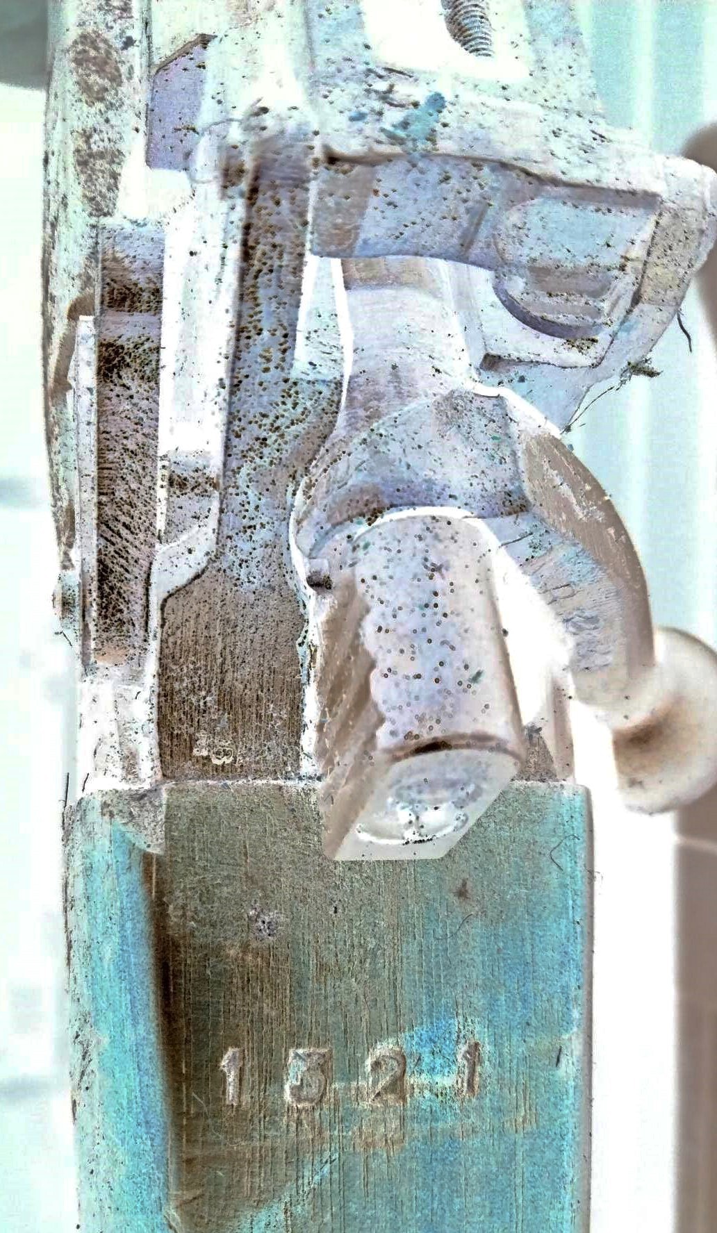

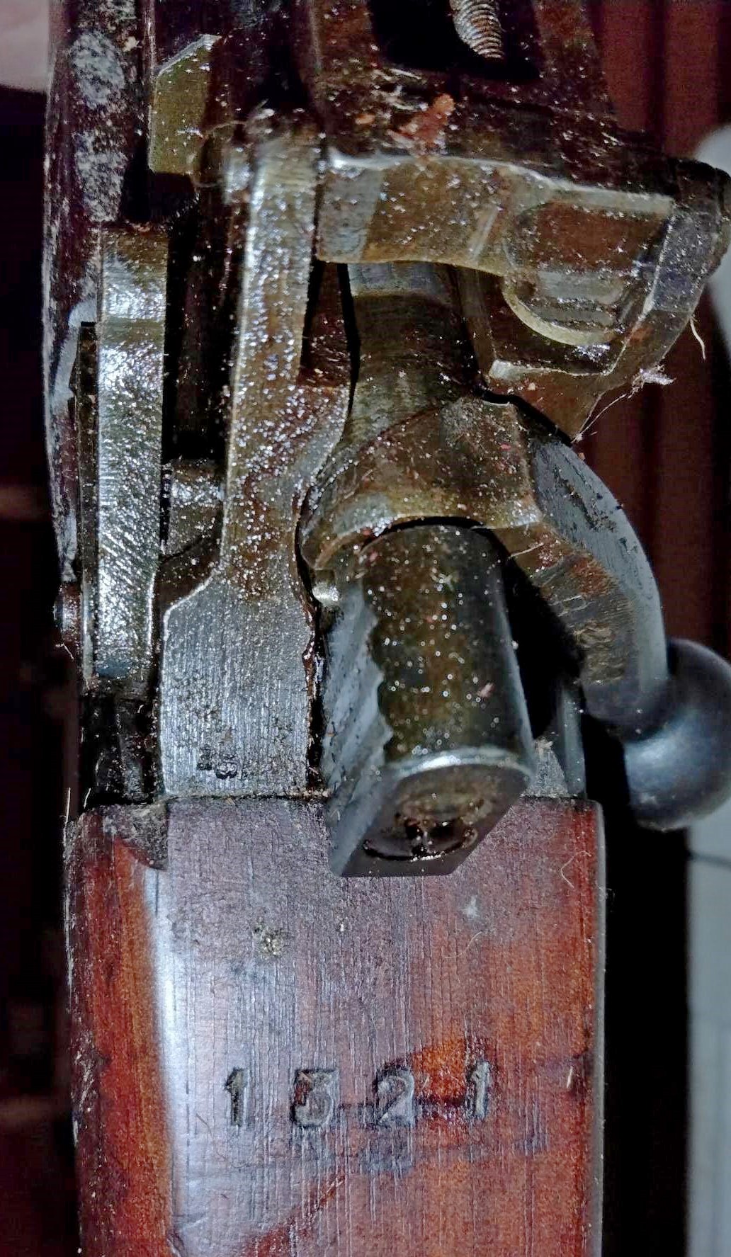

    I keep looking at the scope number on top of the wrist. It's obviously legit but do I see another scope number that's been barred out and sanded out below it? Maybe my mind is playing tricks on me? If there was another number there, it looks like five digits as it should be.
    Good spot Brian, but I don't think that mark is evidence of such a mod: the surface around is just too fresh and too even (like Bohemian snow! ). That butt and forend are like new: I'm sure you noted the typical "glass-paper" sanding marks in the typical patterns and places of new wood. Something has bumped it in that spot later I'd say, though I am looking at it still! Photo as a negative below; it looks like two lines, with the same surface height between them as the rest of the butt.
    I wonder if those marks could be made by the cord that retains the "chock" in the No.15 chest getting looped over under the felt and then pressed down into the wood or reacting with it over years of storage?
    One thought occurs to me about the early "T Less Telescope" rifles: could it be the interruption to the supply of brackets from bombing caused the conversion program to be put on hold until the supply resumed, and those rifles to be put into store somewhere to "get them out of the way" and then overlooked when production restarted, only to be "found" late in or after the war?
    Is that "43" or "48" next to the "TR" mark?

    It would be helpful if the OP could remove the butt so we could know for certain the rifle serial on the tenon. If it's the serial of this rifle then that's at least one part of the mystery solved!

    Yes, that would be a good idea.
