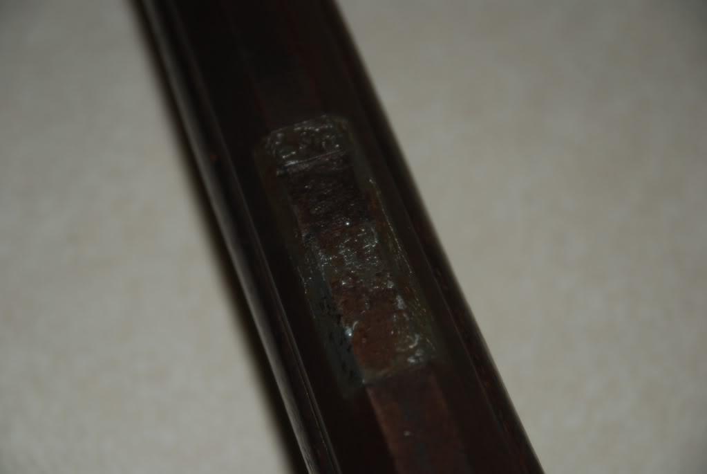

    Gentlemen, if you Google M1803-41-51 Click on the site" Digitalt Museum And follow your nose and the 1803's (about ten or so) and I looked at a couple/ look exactly like the one I have. Even some of the stampings are the same (OIR on one of them in the same spot on the barrel) the K and the crown the shape of the lock,the stamped number and the brass are all the same. I polished the brass on mine and when I saw these pictures I almost fell out of my chair. The Danishicon rifle 1803 may not be as rare as the 1821 but I think it is what it is. Let me know what you think (Patrick, Claven, gew, and anyone I might have left out) all your opinions are valued.

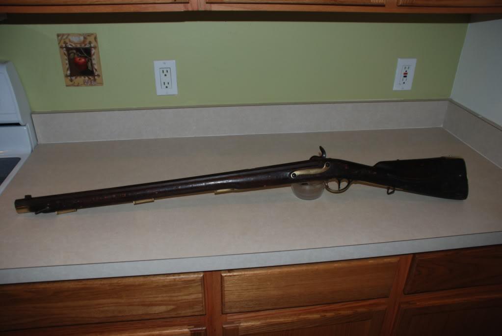

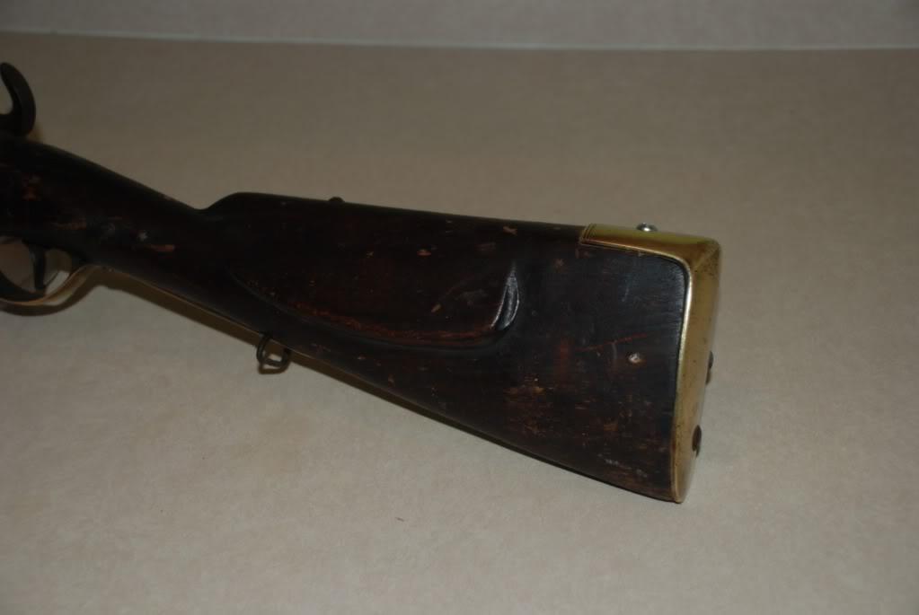

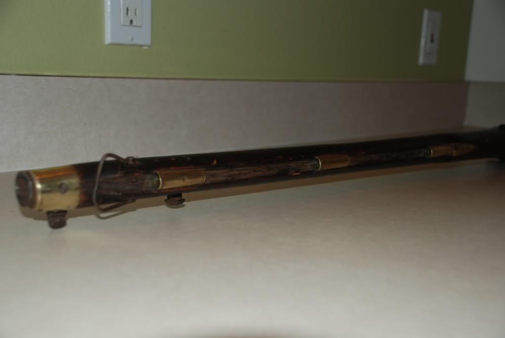

    pictures
    A little proof with the polished brass. I put these together in haste but you get the picture.

    Dang, now why'd you go and polish the brass? It'll be years before it looks right again. It's like a tarted up 90 year old woman. Made me get harsh, but I'm not sorry!

    I'm going to get an after market sight (replica) and a ramrod and enjoy it. I'm not trying to make it look brand new but to me the brass had what ever someone covered the wood with(maybe when it was turned into a lamp?) and to me it looks closer to the ones that everyone is trying to sell. If I was ever to sell it I would have a hard time if it looked to most people like a neglected piece of junk. If I was the soldier and this was my rifle I would polish the brass (when I had the time). I'm sorry if I have disappointed some but I'm going somewhere between don't touch it,and completely restore it.

    DaveN, I just had another look at the original pics. You are quite right, that was no kind of original finish, that was Bubba at work with the floor varnish - the clue is the look of fossilized treacle over everything. Fortunately Bubba usually does not bother to clean the wood before splashing on the brown muck, which does not adhere well to the so-called "patina" a.k.a. dirt. It often comes off quite easily IF YOU DO IT PROPERLY.
    So please leave that rifle alone for now, read up on the Argentineicon RB refurbishent, and not only do you have Part 5 to look forward to, but I will see if I can post a pic of a "treacle" rifle AFTER the kind of treatment that I not only recommend, but actually practise!

    Too harsh, I was? Possibly. But upon a further review of the photos presented so far, I'm still not convinced that a GENTLE cleaning of the wood and esp. the brass would have been more prudent to start. I don't mind old brass that's worn shiny because tou are handling it or using it, but the rest ought to keep that nice old browness. Green is bad, that's gotta go, but the photos did not reveal much active corrosion.
    AS it was furniture, I'm wondering if it doesn't have just an old waxy build up. Try a light rubbing w/ a soft cloth wettened w/ isopropyl alcohol. It will remove scads of gunk but leave the old finish pretty much untouched. Not aggressive at all! Besides might as well even out the finishes now that you've started. In 30-50 years it'll be all better, and that's not much in gun years.
    I've a brass barreled blunderbuss (Irish mail carrier's thing IIRC) that someone polished up over twenty years ago, and it still doesn't look quite right.
    But never mind me, I think Patrick Chadwick will do a much better job helping you do right to this VERY interesting weapon! I just couldn't help expressing my dismay, have seen way too many "improved" pieces over the years. Be patient, and gentle, please. Thanks for letting me rant. All done now.
