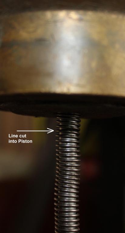

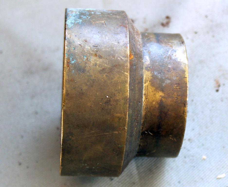

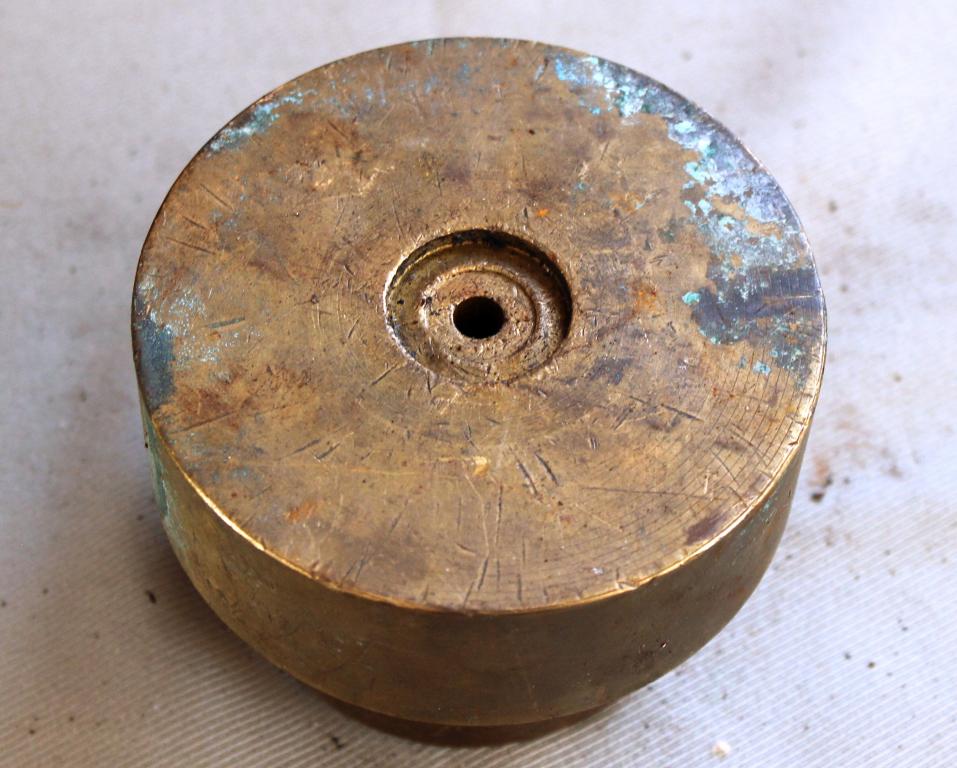

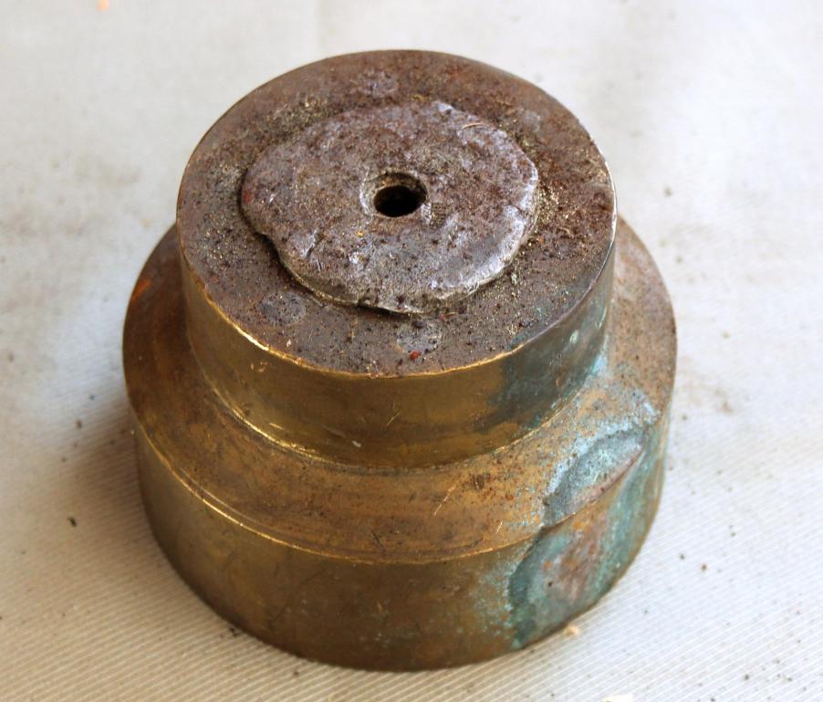

    Ok, Ok.... I've figured it out..... but only because I looked closely at this chunk of Brass 4" dia x 2 3/4" long
    I was just about to post these photos to ask what was it used for, I had tried it on the piston and it seemed to fit it ok.... but for what?

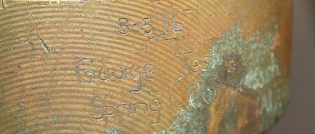

    I went to measure it to keep Pete happy and under some Verdigris I found engraved "8.5 lb Gauge Testing Piston Spring Compression L1A1"

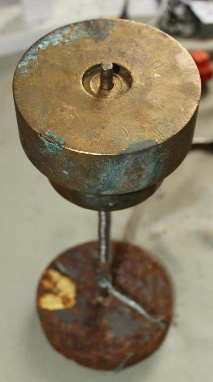

    Here's what it looks like when the parts are back together
