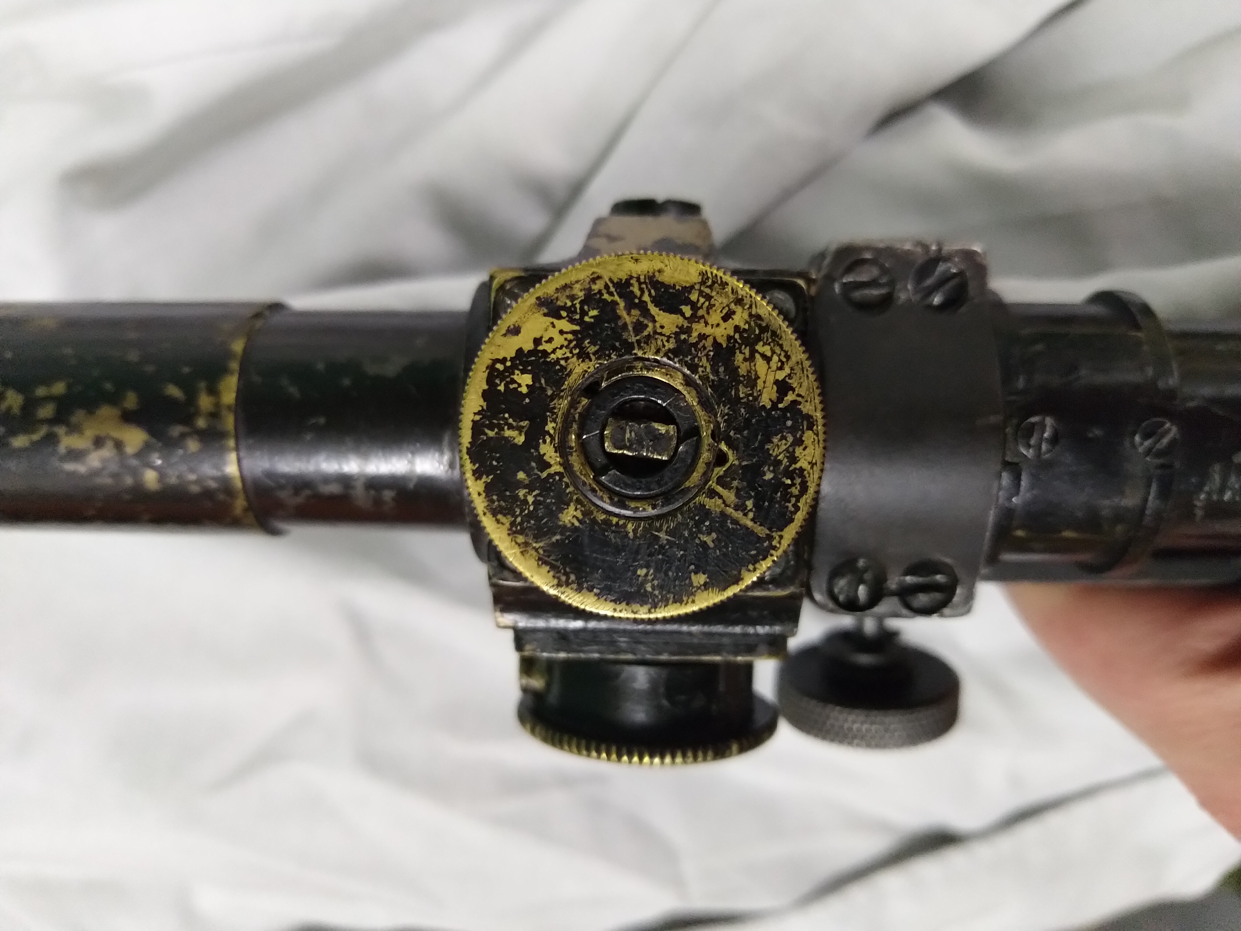

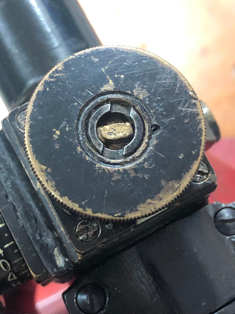

    Another Turret
    Another turret for the survey, and serial number info in case it's useful.
Name:	a Turret.jpg‎
ID:	123578   Click image for larger version
Name:	a Serial.jpg‎

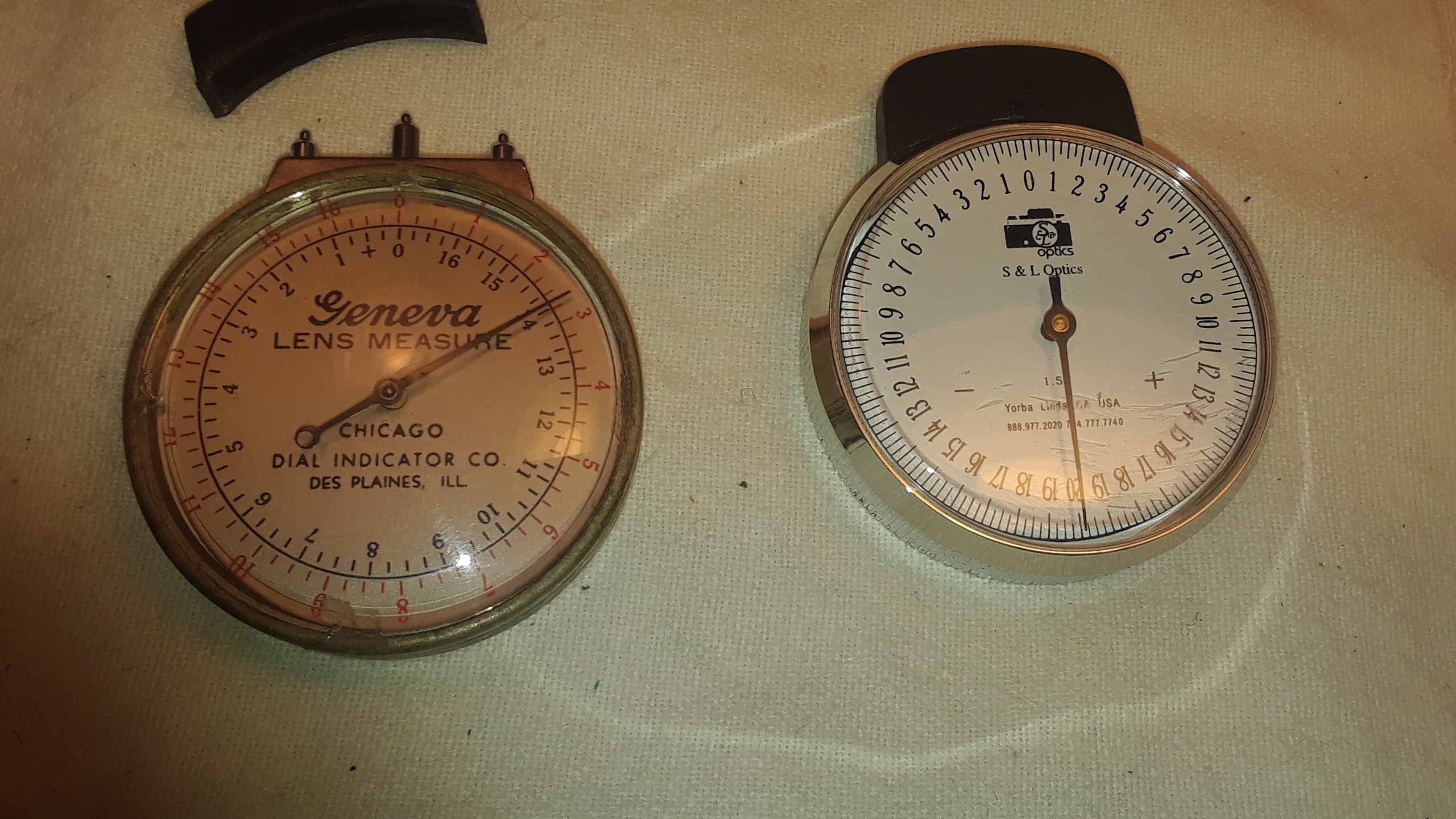

    Just use a clock dial lens gauge...
    Problem solved
    You can pick up used ones for a 5'ver on Ebay
    A perfectly flat or plano lens surface is almost impossible to manufacture.
    I'll post a picture of one of mine later today.
    ---------- Post added at 11:28 AM ---------- Previous post was at 11:24 AM ----------

Name:	lens dial.jpg‎
