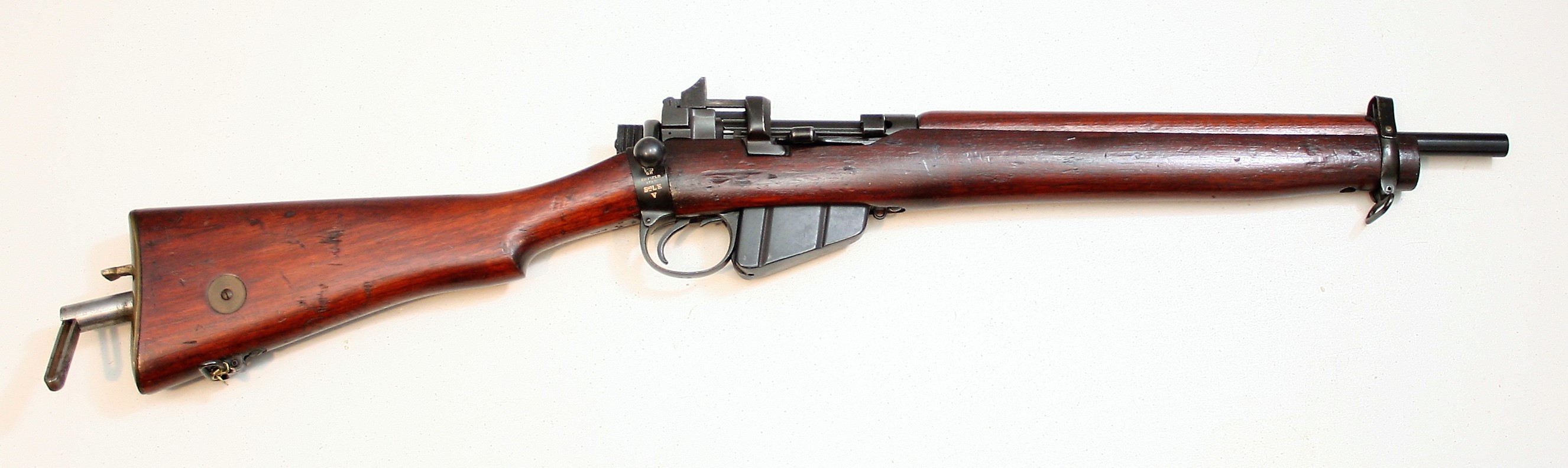

    My No. 1 MkV concealable as pictured in Skennertonicon's books. The former owner purchased it from a Military School museum in Gettysburg Pa. that closed. It was set up by Greeners for the South African police. I was told that there was one in Greener's factory collection.
    The barrel extends from the end of the forestock as it was necessary to extend the barrel to avoid it being classified as a short barreled rifle. The lump protruding from the butt trap is a folding wrench used to remove the buttstock bolt allowing the rifle to be dismounted into two pieces.

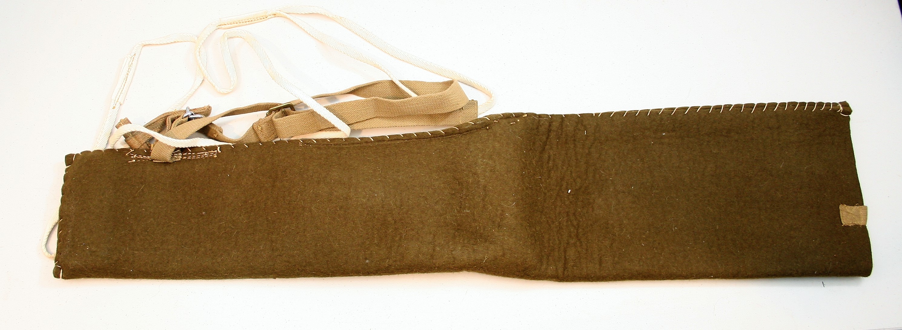

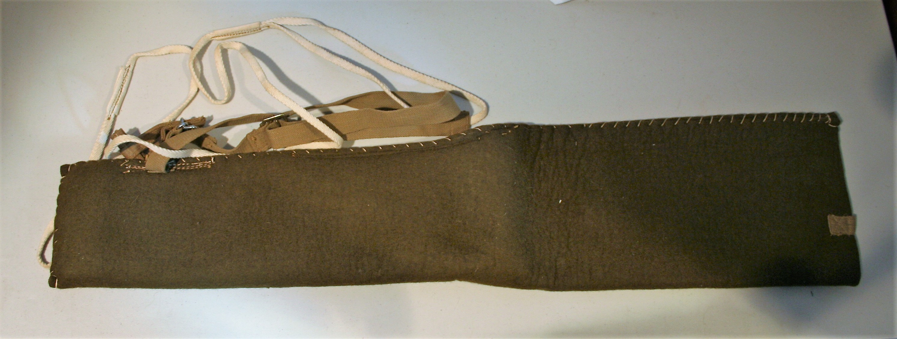

    Had one of those cases previously: there was a piece of white nylon strapping similar to a heavy mine tape and a slit in the felt about where the receiver would be when the rifle was in the case. My assumption was the strap was let in through the slit and put around the rifle action (perhaps through the trigger guard). Seem to recall the rifle was to be lowered before hitting the ground, probably to avoid it entangling or striking the soldier as he landed. End closure as a simple web strap with a snap IIRC. Will see if I have photos of it still.
    ...And here's a photo I found. Looking at the photo I was mistaken above: the strap must have gone around the wrist of the butt. A No.4(T) would not have fit with the scope mounted.
    Yes, a scoped 4T won't fit in the felt rifle drop valise.
    I used to have a moth eaten one decades ago, and sold it along with all my militaria collection a long time ago. Its very rare to find one in the UKicon that isn't mothed, because of the felt construction. If you do find one, they are now very expensive, at least £500+ for a good one!!
    I have a vague recollection that Steve Kiddle of Pegasus Militaria made a small batch of excellent repro's some years back.....but my memory may be playing tricks on me. He does still make a superb repro of the WW2 drop bags though.

    near Detroit Michigan

    Pictures of my valise for what it is worth. p.

    For all the world, it looks like it's cut out of a grey (wool)blanket...

    A very dense felt about 3/4" thick as I recall. The same sort of stuff "Russianicon" felt books are made from. A couple of those cases split open would have made a very good sleeping mat if kept dry!
    I would love to know more about this. The South African Police requirement for something like this would have been bizarre as it was very much still a 'paramilitary' police service at that time, with its own artillery still.
    In South Africa we still don't have a restriction on barrel length for rifles, so the to
    Quote Originally Posted by breakeyp View Post
    doesn't fit in. IIRC there wasn't even a requirement for licensing firearms at that time.
    In my opinion this wasn't official South African Police, but something else.
    In South Africa we still don't have a restriction on barrel length for rifles, so the to doesn't fit in. IIRC there wasn't even a requirement for licensing firearms at that time.
    The barrel length question relates to US laws and has nothing to do with SA. Taken down the gun will fit nicely in luggage allowing a rifle to be taken into a hotel unseen.

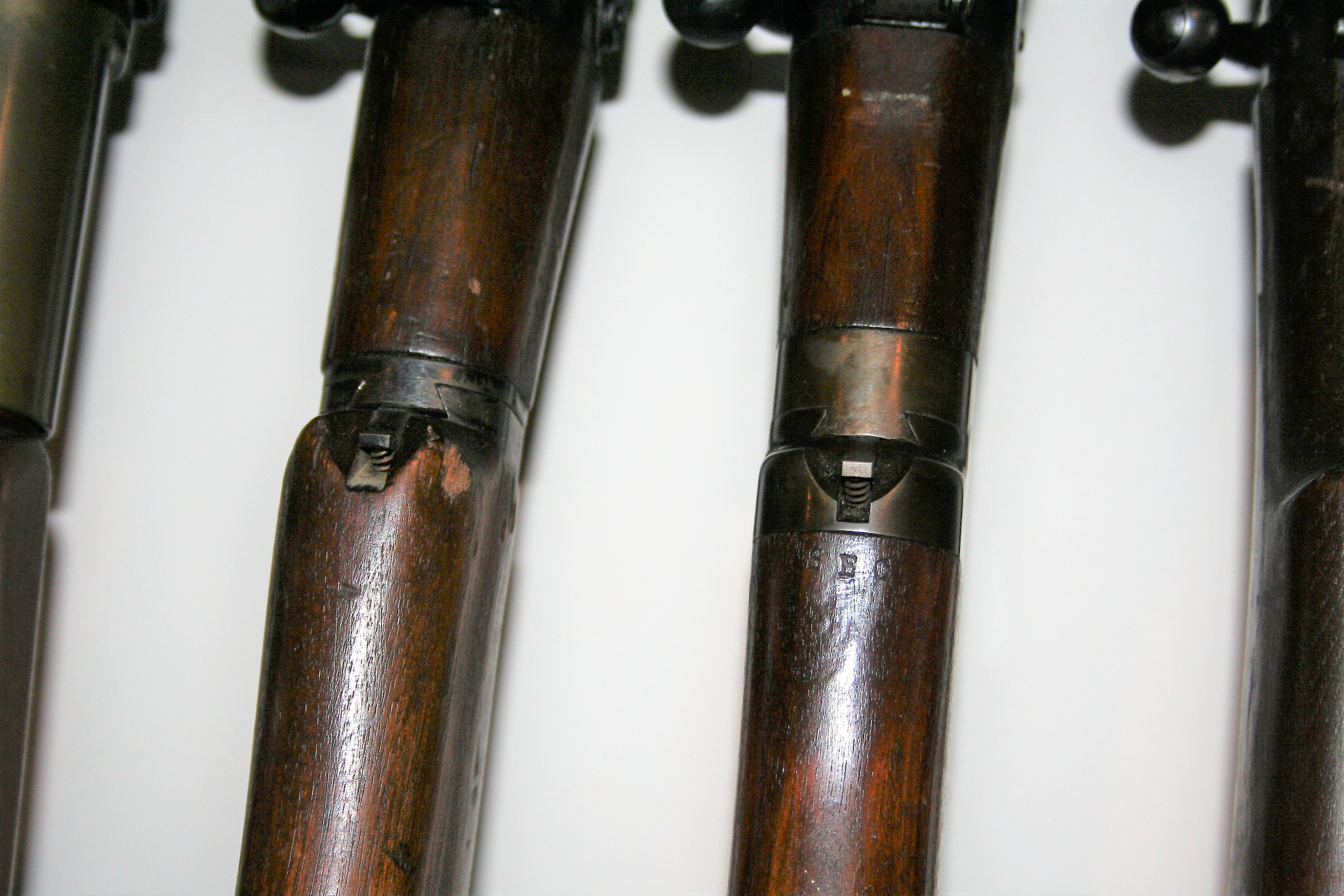

    Continuing my examination of my new acquisition, I note that the dovetail design is different between the two rifles. The thicker metal joint on the Mk2 shows it to have a more protected and solid takedown catch. The Mk2 is on the right.
