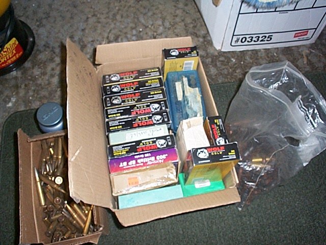

    Wolf .303
    I did a fairly extensive test of a bunch of .303 ammo, as well as handloaded .303 using bullets (and powder) from surplus 7.62X54R (like when this made sense becuase you could buy 54R for 10-12 cents a round). I was planning on doing a write up, but between a computer crash and a move, things got put aside at loeast temporarily.
    The Wolf .303 ammo (most especially the 150 grain "Gold") is without any doubt the finest factory mass-produced .303 ammuntition ever. The brass is fantastic and last forever, accuracy was superb, and I was getting SD's over my Chrony like an airgun with it (like 7's and 9's). No Prvi that I have ever shot was "hot."
    I still have a few hundred 54R Berdan virgin primed brass around from the experiments if anybody needs some! (and yes, you can safely use components from 54R to reload .303--it's just not something to do without a chrony and a good quality micrometer).
