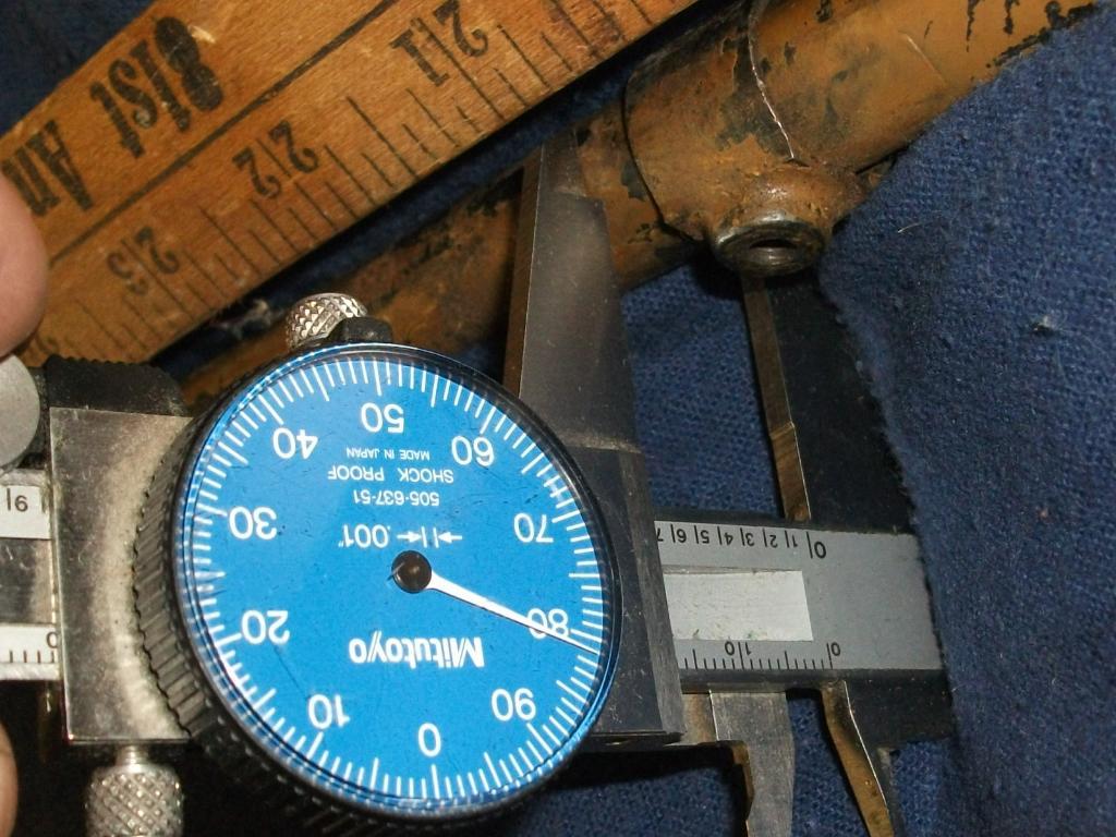

    Here's what we need from you, harlton. A photo like this showing a "regular" barrel next to your "fat barrel". You did indicate you had more barrels. I am absolutely sure that 0.100" will show clearly, as there's not that much between a No.I and a No.4:
    Then we will have proof. Be nice and do the shot straight on...
    But here's the start of the deluge:
    L42a1:
    ~0.790"
    '55 Faz No.4 Mk.I:
    ~0.635"
    Quote Originally Posted by harlton View Post
    Behind the sight is 0.5985" , the Dia increases to 0.6455", in the space of a 1/4 of an inch
    Note that there's MUCH more than 0.100" difference here between the L42 and the No. 4. Harlton's barrel is more like 0.010" different. ONLY 0.090" off...
    And random SMLE barrel at the same location:
    ~0.590"
    (Only about 0.045" difference, but clearly noticable even without measuring tools!)
    Breech end, No.4:
    Front edge of reinforce, No.4:
    Just forward of reinforce, No.4:
    And SMLE:
    ~10" in front of receiver face, No.4:
    And SMLE, same location:
    Want more? Be polite! (Which I'm fixing to fail to do myself

    Some good photo work there JM, that second last shot of the Vernier dial was exceptional, crystal clear.
    Obviously a good nights sleep steadies your hand.
