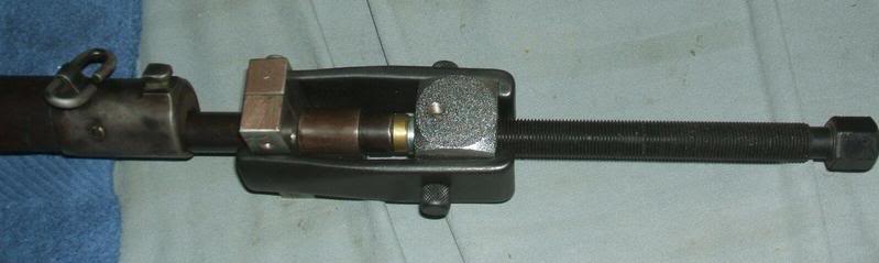

    My new to me Ross Mk III rifle had a severely canted front sight base, a good 10 to 20 degrees off, very obvious as seen. I tried putting the muzzle on a block of wood and tapping it straight with brass drifts etc but it wouldn't work, there is a taper and a very strong interference fit, it wouldn't budge no matter how hard I drifted it.
    Member Tiriaq offered to put together a kit for safely pulling the front sight base off and driving it back on. I received it yesterday and it worked like Jack the Bear...the sight is now straight, the slot lines up for the retaining pin and it looks a lot better. The dimensions of the kit are perfect- it included a brass button to go in the end of the barrel to protect the crown.
    Thanks Tiriaq!
    Anyone else need to do this?
    BTW, this rifle is built like the proverbial brick schidthaus.
    Before:
    Pulling:
    Finished:
