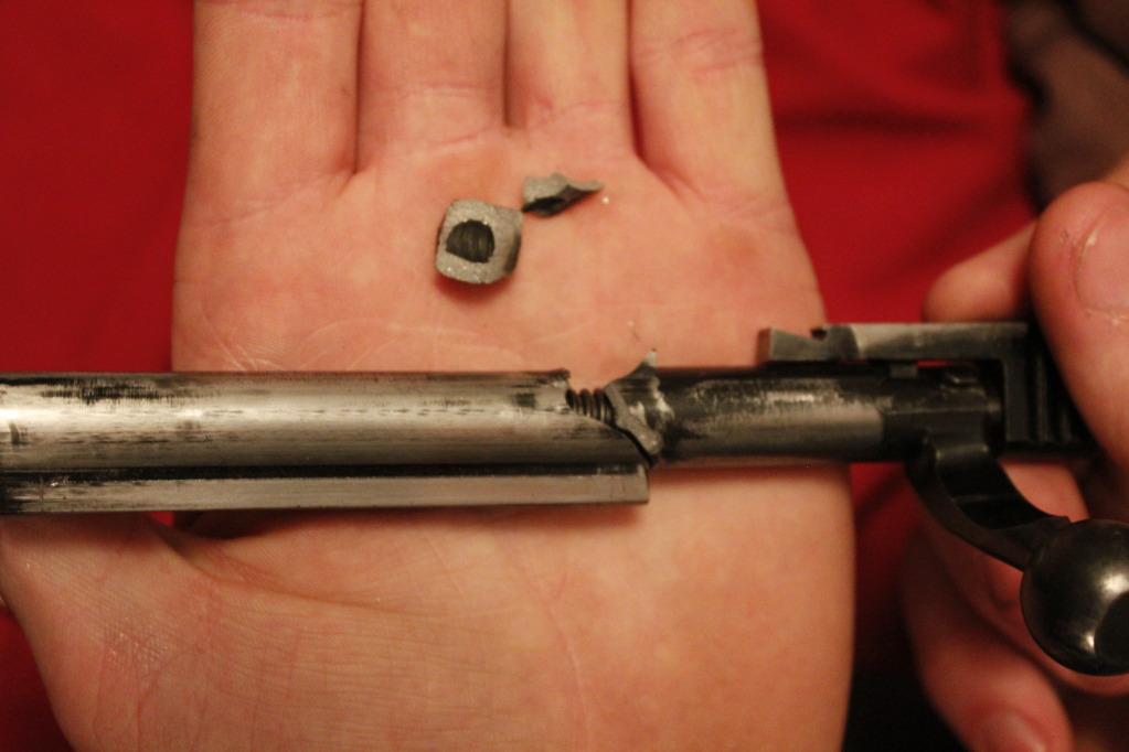

    nother photo surfaced:
    I now think the faliure originated on the left side lug, which broke completely off, and then propagated to a stress point at the base of the safety lug. Uneven bearing could be the culprit, IF it was VERY bad and the load was hot.

    Although we can't see the grain structure too well, I agree entirely with clav. Uneven bearing, whole load taken on l/h lug and something's got to give. Mind you, is that a penetrative oil staining at the left and right hand end of the broken lug? Or is it some camera shading? If it's oil staining, it indicates an earlier fissure which would back up Clavs observation that it's an uneven bearing over a period until.....................

    Comparing the photos to the earlier ones of a sheared left lug it appears that the fracture on this one actually started towards the top of the lug and travels down through it at an angle leaving part of it still attached to the rear half of the bolt body. Weird.

    Could a partially closed bolt, from shallow set primers, also contribute to an uneven loading on the two locking lugs?

    It COULD be in theory Paul but due to the inbuilt mechanical safety, you cannot actually fire the rifle until the bolt is positively locked. On the reverse side to that and thinking about it, you couldn't replicate the situation by half opening the bolt AFTER firing because you can't unlock the bolt until the pressures have dropped to atmospheric

    Is that the same bolt from a different angle Brian? If not, it's a remarkably similar/identical fault line. Can we have a pic of the broken surface? Thanks.

    Peter, It's the same bolt photographed from the top and the bottom. The lugs were obviously bearing evenly, eh?
