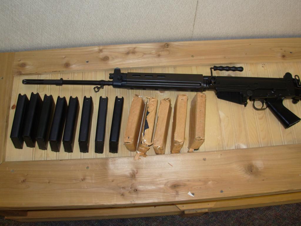

    the new made kits are getting close to complete , ill post when i get mine ,

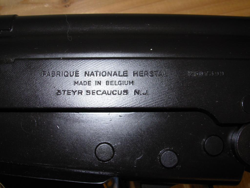

    thank you peter , it has been a process and vicariously fun to watch in the updates , if i were a younger man i might have ventured down that path , its nice to know they will be available to the public again , and i do enjoy the thought of having the kit for my minty belgian ,
