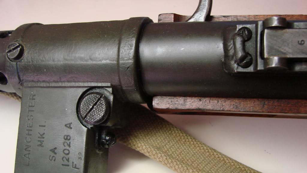

    I've seen the slot in the body on another gun, but I've not seen a hole for the trigger bar on any Lanchester (Probably not noticed it). If anyone has a trigger mech with the hole, could they post a pic?
  3. #22
    04-28-2024 @ 11:48 AM
    16,513
    05-03-2024
    09:41 PM
    Brit Plumber has struck oil there.......... Ignore the safety latch (book, page 16 item 27A) info now BP, you have a true articulating Mk1 trigger bar (P9, items 1,2,3&4 - the bit that joins the trigger to the sear) as opposed to the usual Mk2 fixed variant (P19, item 53). You've also got the hole in the casing for the tripping lever.
    Quite clearly, BP's Lanchester was made as a Mk1*, using up a Mk1 casing and trigger parts mated to a Mk1* trigger mechanism housing that has been screwed onto the Mk1 casing.
    I suppose, in theory, you could make a Mk1 tripping lever and change lever, modify the trigger mech housing and revert it back to a Mk1 gun
    Quick question first BP. In your thread above, do you mean the hole for the trigger bar or hole for the change lever? And it is a good book too!

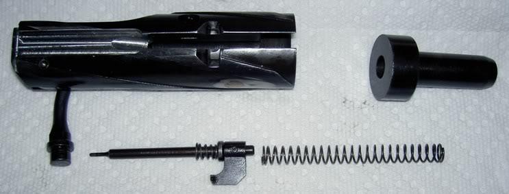

    As this will be a closed bolt, semi-auto only, I think a similar arrangement would work. There would be no disconnector, just a one piece tripping lever. I would like to use the breech block below, Mk4 Sterling modified to semi-auto Mk6 configuration. This means moving the sear forward for the firing pin, and a longer tripping lever. An arrangement like the STEN might be more suitable though.

    Found some more bits. A safety lever and a Mk1 sight base.
    Does anyone have a Mk1 sight they would like to sell or know where I can find one?

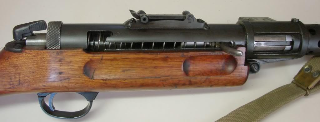

    Could someone please tell me if these guns were originally finished as shown below.
    Thanks
    David
  12. #30
    16,513
    05-03-2024
    09:41 PM
    The only ones I ever saw in service were Brit, Australianicon and NZ navy ones out in the Far East. The Aust Navy ones were from a Submarine and the NZ Navy ones were from HMNZS Royalist. The original finish was pretty thin to the point of threadbare....., as shown on the end cap of DRM's example but the Navy Armourers at the Armament Depots used to keep them all in order. Where they'd gone through our Base Repair programmes, they were the usual phosphate and black oil dipped finish. As I remember it, the brass magazine housings (some were folded/wrapped steel) looked to me as though it'd just been left to tarnish and darken down naturally. Yours looks as though it's actually better than some of the Lanchesters the Navy had and a whole LOT better than some of the dewat/deact stuff that was available in the UKicon many years ago
    It's interesting to see the backsight bed gas-welded down over the original screws. What on earth possessed anyone to specify screwing the spring loaded backsight bed down onto a round .100" (?) thick casing with BA threads that weren't even square on to the diameter of the tube is simply beyond me! But there you go........, desperate times require drastic solutions and all that.
    Is yours a runner DRM? I've got one in similar condition but it's been through the Base Workshop system........... naturally!
