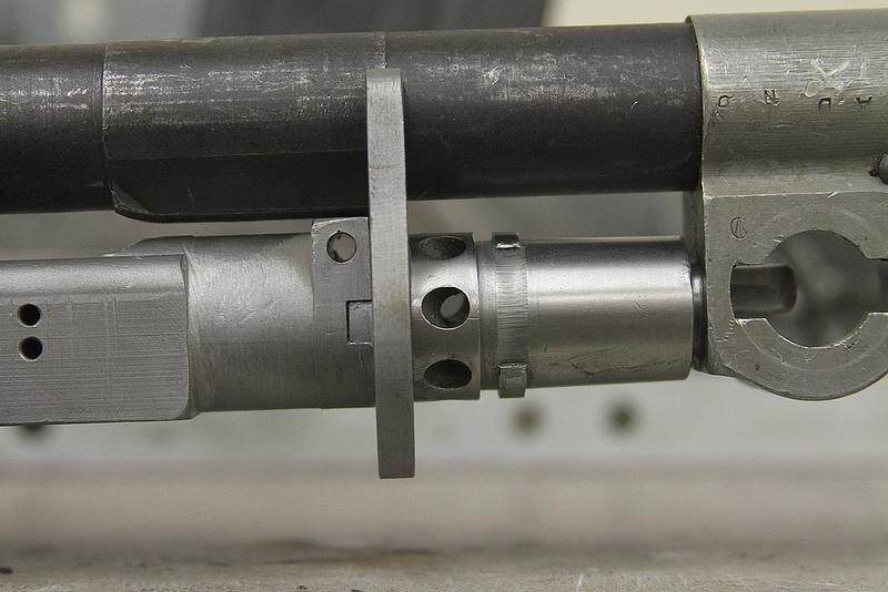

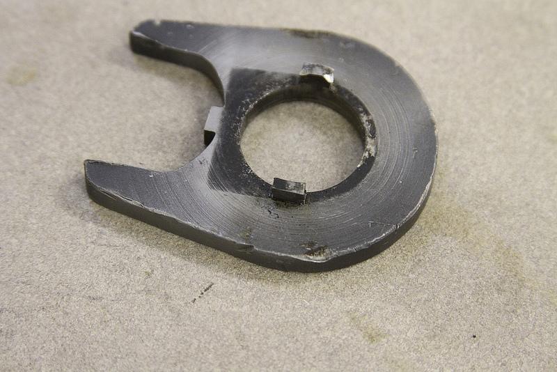

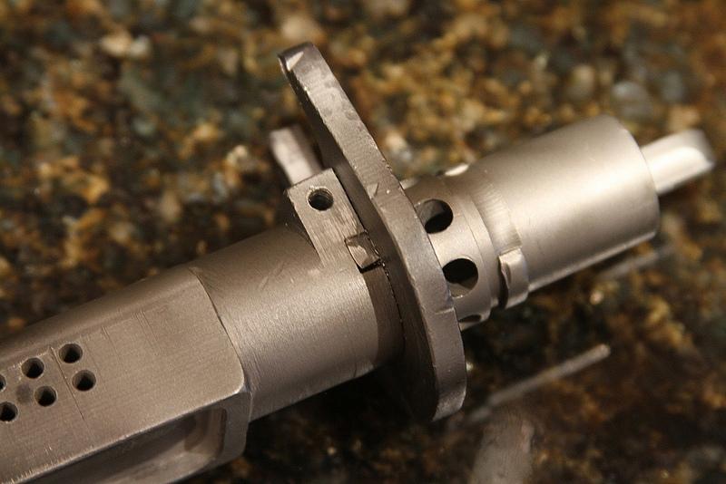

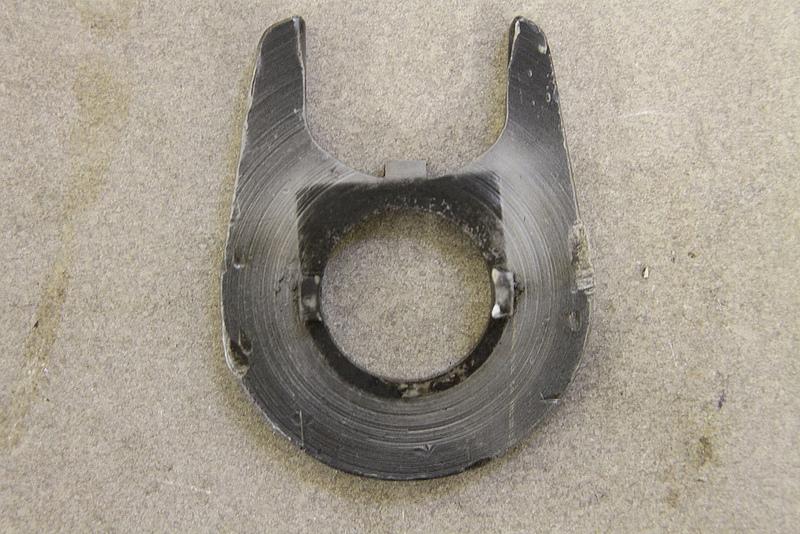

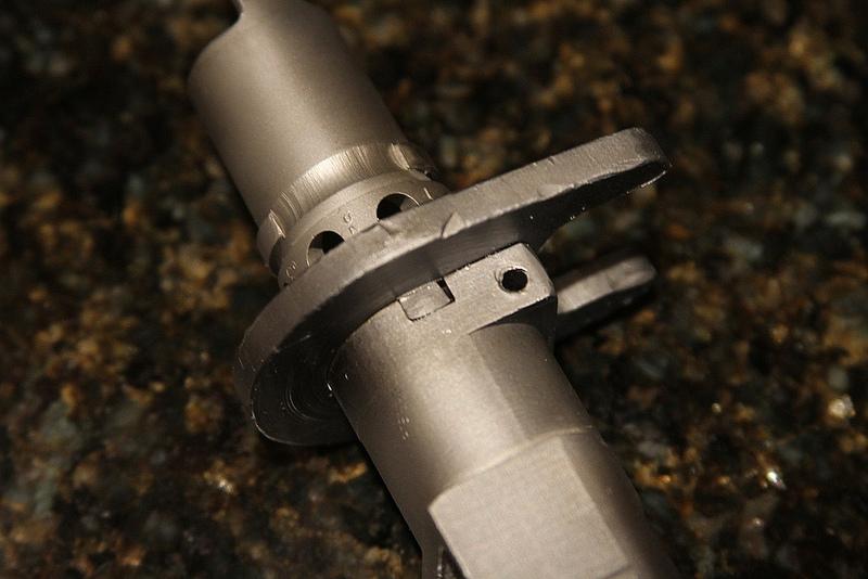

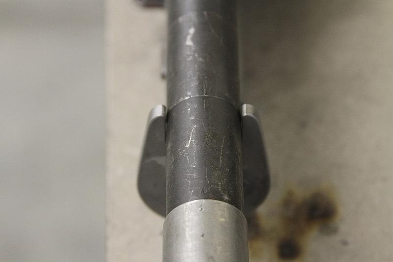

    Well I finally got the gas tube removed. Ended up reaming the pin out and then using a steel block tapped it out using the gas shield. To install the new gas shield I polished the gas tube with super fine scotch bright and used some mil-comm to lube it before reassembly. The assembly is snug but serviceable now and the new taper pin will secure everything nice and tight. The taper pin reamer used was a No1.

    Just like that.............. Brilliant!
    Added later....... Pic 4 shows exactly what you speak of. The darkened silhouette of the face of the body distinctly shows the offset/cant against the blast plate. I'll get a photo of the gas cylinder alignment gauge and ask Badger to put it up. Better still, get my son to give me a tutorial.......
    I would love to see that alignment tool. As of note, I found gauling in the insert area of the body where the gas tube was forced in orginally. This undoubtly caused extra friction. This made the use of the bipod as wrench unsuccessful and started to round the bipod locating lugs on the gas tube (hence the polishing). If the press fit was clean, I could see how this approach would work.
