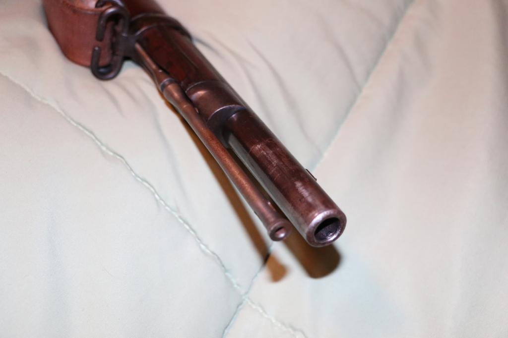

    You know you guys may be correct. I had spent about 2 hours running a brass brush up and down the bore from the muzzle end, but would that do anything for the chamber?
    what is the best way to clean the chamber on a 45/70 trapdoor, you can't use a solid cleaning rod from the rear due the shape of the receiver

    I just got back from friends house we used a bore light to check the chamber and it appears to be mostly gunk solidified in there. We used an older 12 ga. bronze brush to clean the chamber and now the cases slide right in, and it looks pretty good. I will take it to the range Saturday and see what the fired cases look like.
