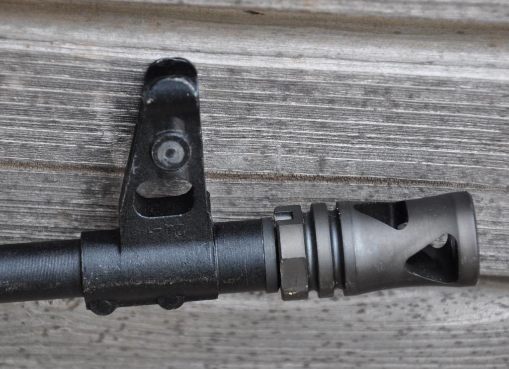

    Had to have an AK that had no pistol grip, flash hider, or collapsable stock, so I could use my "legally possessed by me in California prior to 1-1-2000 high capacity magazines." It shoots about 2 to 2.5 MOA with irons.
    Started with a Saiga IZ-132
    Barrel shroud cut and threaded .
    Tactical Tri-Delta comp and crush washer (same brake was awesome on my 300 BLK!)
    Tapco gas piston

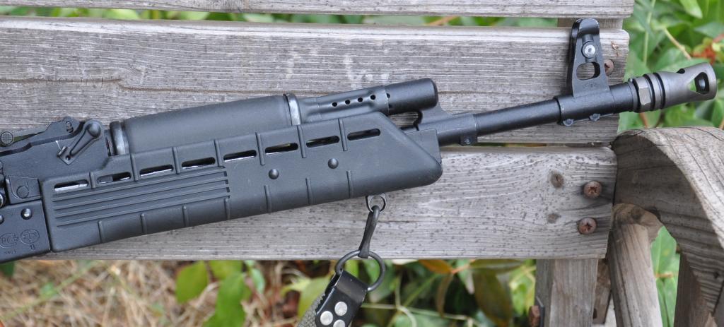

    Tapco G2 double hook FCG modified for stock Saiga
    Tapco Intrafuse handguard with fabricated aluminum heat shield

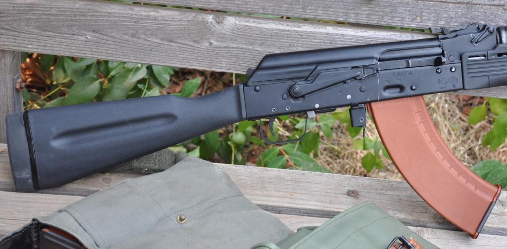

    K-Var Nato length AKM stock modified for stock Saiga with 1" pad extender
    Chinese Type 56 vented gas tube and polymer top handguard
    Pre-2000 possessed comblock steel, some with beat up bodies replaced with Tapco smoothside burnt orange bodies (original com-block innards)
    Bulgarian RPK sling (grey cotton web)

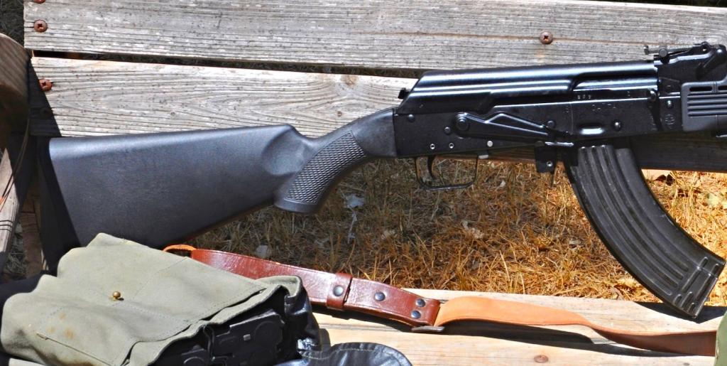

    Arghhh! Finally got a chance to try the build with the K-Var stock. I thought it would be alright from first feel just trying it dry firing- BUTTTTTTT...
    (Let me preface this by saying I am 62 years old and have had three surgeries (2 complete rebuilds) of the right shoulder) After a few shots, my right arm started to cramp because of the unnatural angle. Dang! After all that effort, I just had to go back to the factory Saiga buttstock. I know it works well, as I have had fired hundreds of rounds with the factory stock. I still don't want to restore this one with a pistol grip like prior saiga I have had, as I am not a fan of kydex paddles. VERY hard to do a secure one-handed grip while changing mags.
