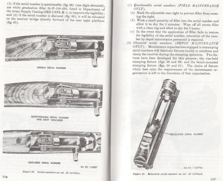

    I'm not a carbine expert (they have been banned in NJ since 1991), but I believe the serial number in front of the sight was added by the upgrading facility. When the new adjustable sights were installed they covered the manufacturers I.D. and the serial number. Some carbines were re-marked to allow easy access to that info. The practice stopped when they found the original number was readable, the manufacturers name didn't matter for book keeping at the unit level.

    I.B.M. had one serial number block, 3,651,520 - 4,009,999 about 346,500 or 5.6% of carbine production. Your carbine looks to have been built the first quarter of 1944. Making a 10-43 barrel most likely original.
    The re stamped serial number indicates at least to have had an Arsenal upgrade sometime. Quick things to look for. Does it have push or rotating safety? Mag catch with the tab for a 30 round mag? Flat bolt? Stock cut for a selector switch? Did it come with a sling, end tabs?

    IBM, or Auto Ordnance for that matter, never stamped the serial number in front of the rear sight. That was done during an arsenal rebuild. The reason it was done is because when the flip sight was replaced with an adjustable rear sight, the serial number was often times covered. See photo from rebuild manual below.

    My humble apologies to all -- I checked my M1icon again and saw that I was in error, it was only the s/n that was stamped ahead of the rear sight and not the "IBM" stamp. And yes, it does appear to be an arsenal s/n stamp as the numbers are not in perfect alignment as is the original factory stamp. As mentioned earlier, having the type III barrel band and the adjustable rear sight definitely indicates an arsenal re-build.
