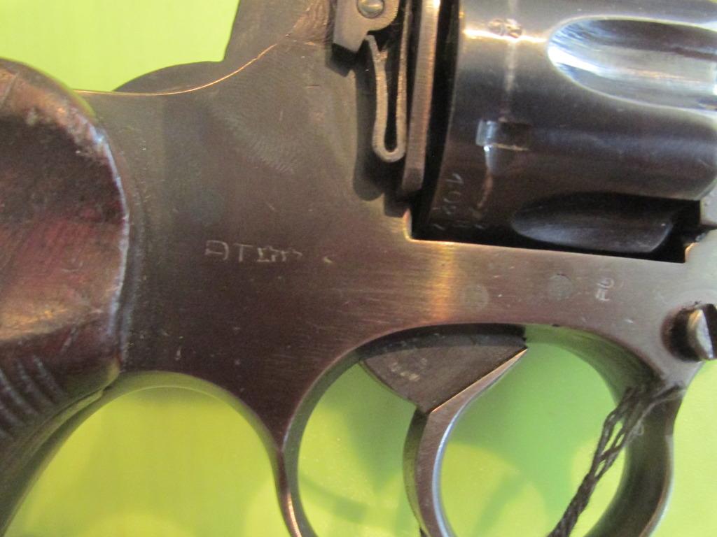

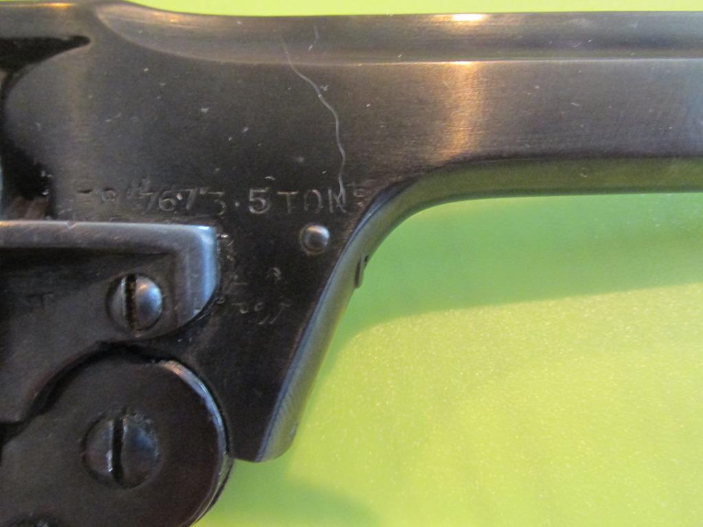

    Those apparently Hebrew markings are in fact the half eliminated D/E followed by an equally half obliterated 1 and two stars

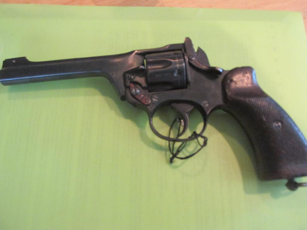

    Quote Originally Posted by mmppres View Post
    so 38 s & w is the correct ammo??
    Yes. Both the the .380 inch Mark I/Iz and the II/IIz" were based on the .38 S&W and so one can use any of the three cartridges (.380 Mk.I, .380 Mk.II and .38 S&W) in the revolvers.
    In the past, I have used all three. The .380 Mk.I is the most accurate, followed by various brands of .38 S&W. I have found the .380 Mk.IIZ round to be the least acculturate.

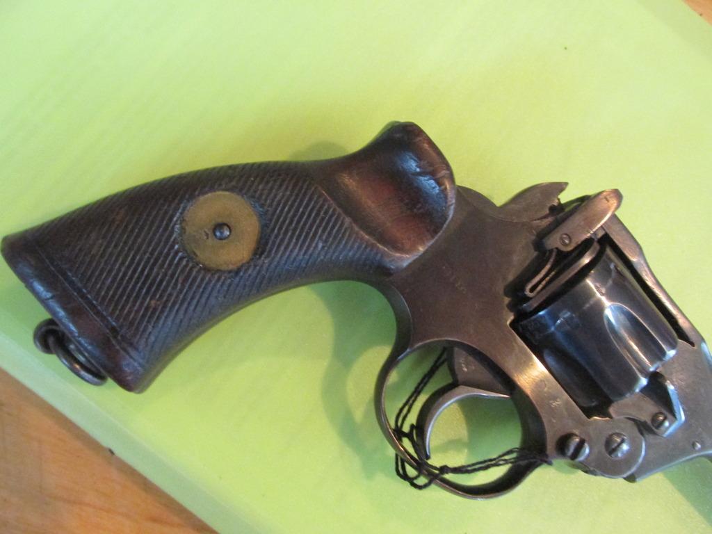

    This one lacks the safety stop, which was eliminated on later production to simplify manufacture (and, likely, reduce cost slightly). These later guns are not dated as such although the barrel date ['43] is usually the same or close (unless they have been rebarreled).
    Commercial .38 S&W cartridges will frequently shoot high, and a higher foresight is often desirable.

    Where did you see Hebrew markings on the Enfield?

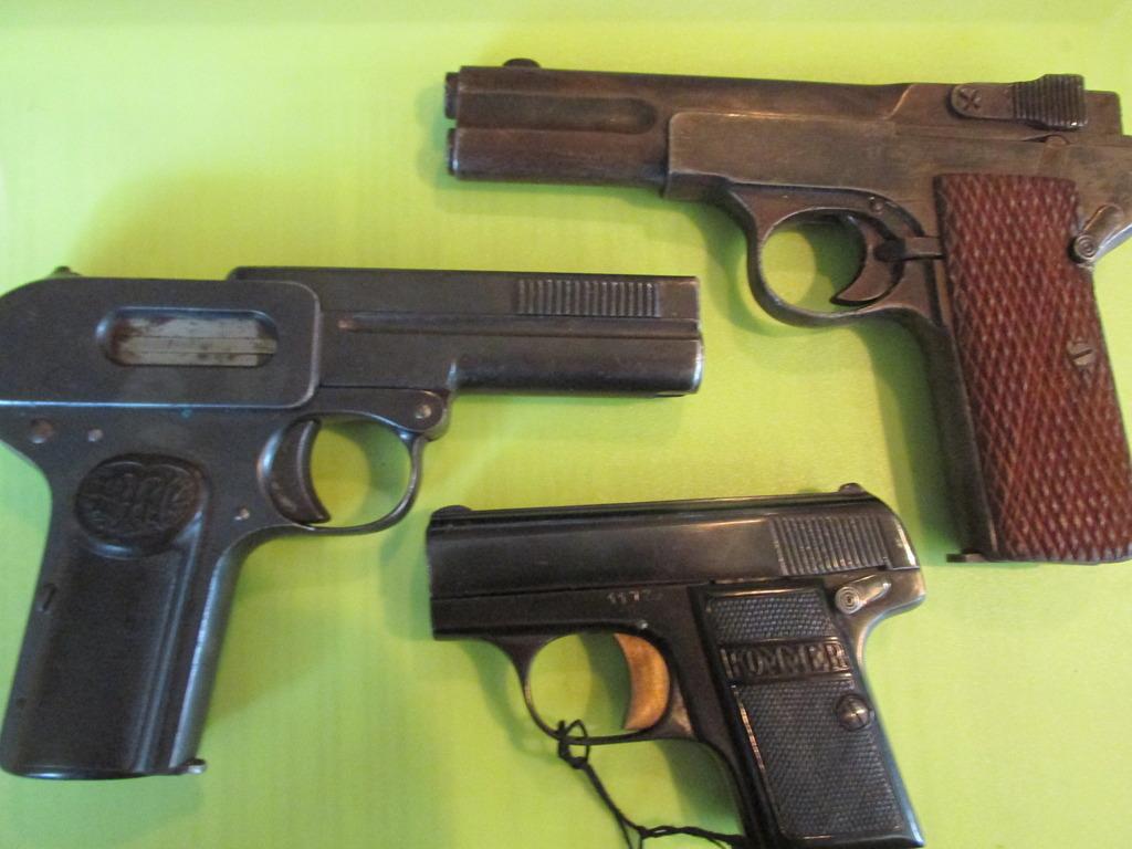

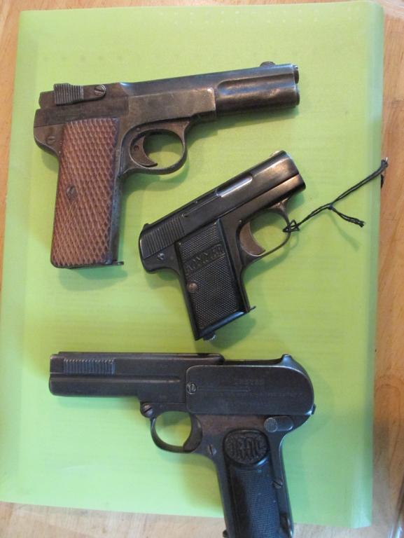

    Also, that top auto with the wood grips looks all sorts of "Chinese".

    the wood grip one is Germanicon marked what i found out so far. an the guys said by pistol grip area. but i think it was said that was done by buffing before re- bluing

    Brown gripped autoloader appears to be native made. Dara Afganistan or Far East. I would not fire it.
