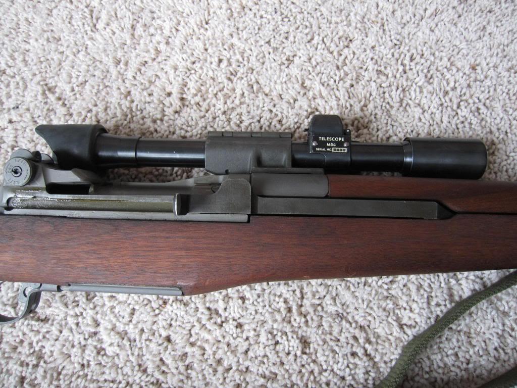

I have just received an M1D from CMP, a Special with the repro scope and scope mount. The gun arrived without the scope being mounted.
Let us not discuss this rifle (I wanted a shooter), but I do need help in positioning the scope in the mount. How much space should one have between the front of the mount and the adjustment blocks on the scope? Should the scope be positioned to give a correct image in the lense? Any hints on mounting the scope in the mount? Any and all help is welcomed. Thanks in advance, John McP

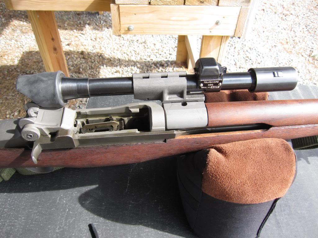

And vary it according to what eye relief fits your shooting position best.

Thanks for the pics, and I should have indicated the M82 scope in place of the M84. Not a lot of difference I think. Still need to find the rubber eyepiece at a reasonable price. John McP

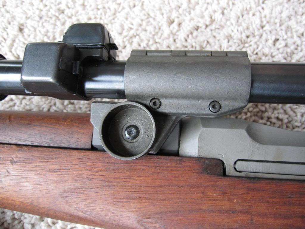

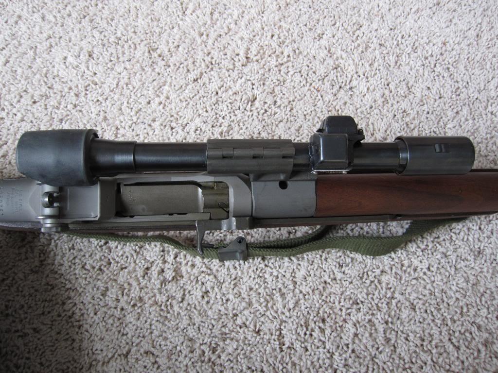

Mine is mounted as above with the adjustment covers being about an "1 1/4 in front of mount with the rubber eyepiece almost touching the windage knob.
Contributing Member
Now twist the rubber eye piece to contact the SIDE of your face, not poke your eyebrow.
That was what I was thinking...it's supposed to shade the outside of the eye.
It won't fit that way. It interferes with the rear sight.
Well, most of the time you'd be employing the optic...your #2 would take the iron sight shots with his rifle.
