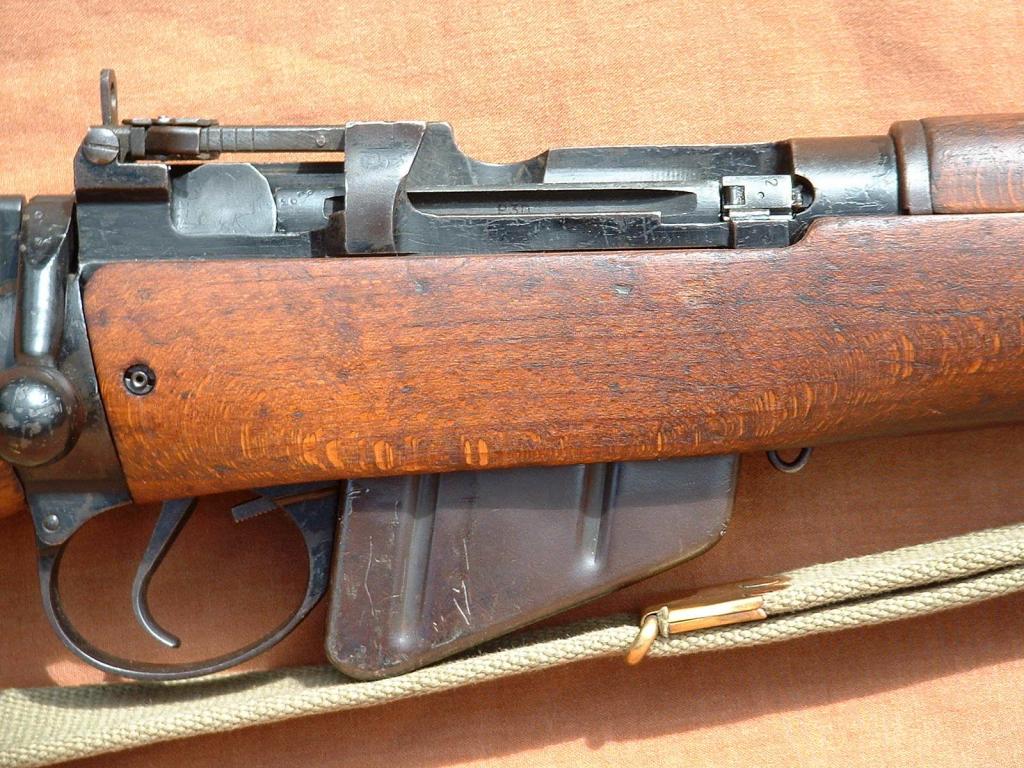

    Here is my '41 6L series LB No. 4 Mk I/I*, she came with the simple flip sight.
