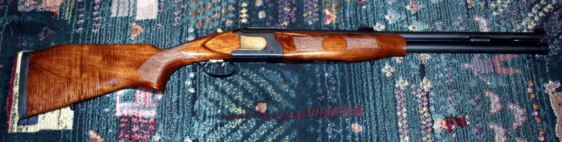

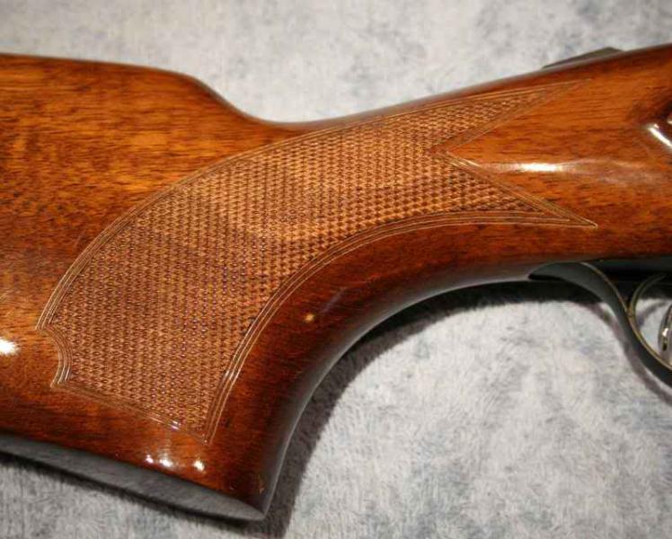

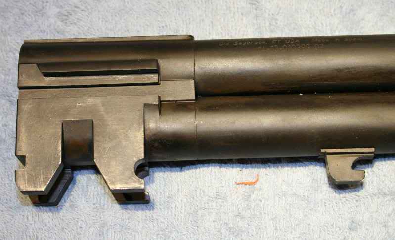

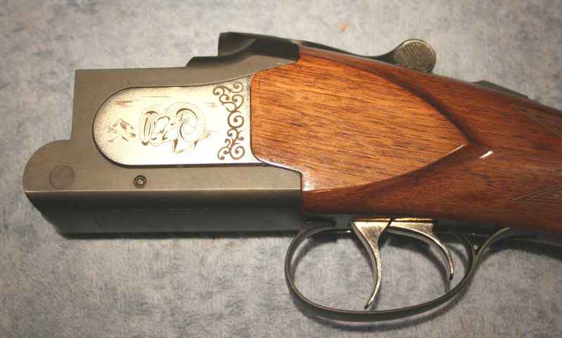

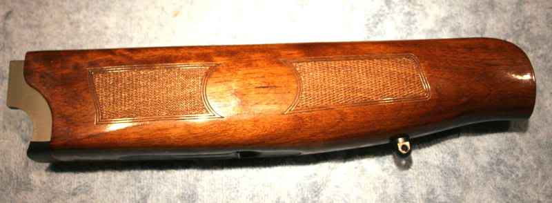

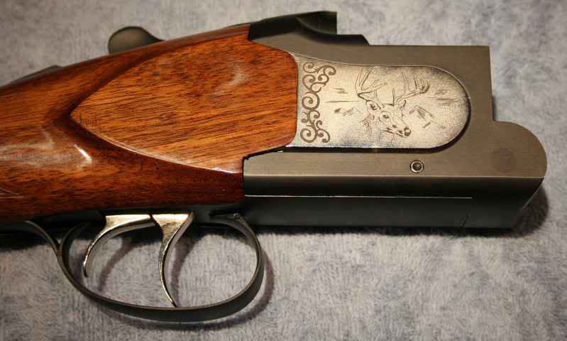

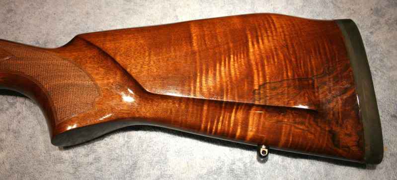

    Hi, another member, RCS encouraged me to try to post some photos of a double .50 BP rifle that I recently got from Traditions. The wood is beautiful and the metal work was fine. I think that the metal to wood fit was excellent. A very nice gun. I would have liked to have shot it, but I sent it back for some minor reasons that are unimportant to the design of the gun. They will exchange it for the lower grade version which I should receive sometime next week. Anyway, here are some pix.
    The breech is substantial, the gun weighing 12.5 lb. It also locked up nice and tight.
    I didn't care for the engraving on both sides of the lock.
    Traditions doesn't have any more of this grade in stock. I think that they still have some of the less fancy rifles though.
