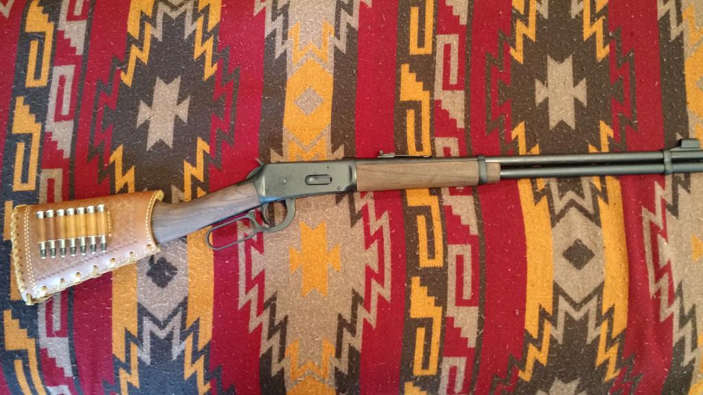

    I refinished this old Winchester 94 after I found it for $125 in another local pawnshop. I local gunsmith did the metalwork, and I did the stock
