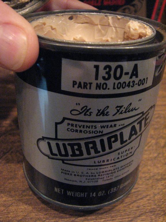

    You forgot to mention the first type of lubricant that was referenced in the manuals, it was a particular kind of graphite cup grease. When, they were having particular problems with the rifle locking up they tried modifying the bolt etc, and even recommended adding a particular type pencil to the cleaning kit. Fortunately, they came up with the tube lubricant and eventually, lubriplate 130-A. The trials and recommendations for lubricating the garand is a story in itself.

    - Bob Seijasicon, thanks for the GCAicon Journal reference, outstanding magazine. I found two mentions of the early grease from you, in V28/2 page 20 with the same picture, and in V32/2 page 28. The latter mentions a question as to which grease tubes were earliest. Not knowing any more, I assume the tubes labeled “Stano-Rust No. 3” from a Springfield MA company predate both the spec and the yellow tubes and white tubes labeled SXS-77 from two different NY companies. The markings otherwise are nearly the same. If there are other references or another article I have missed, please let me know.

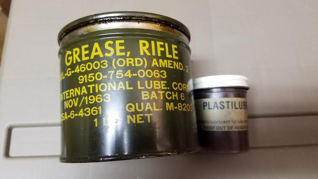

    - Looking for the above, I found an article from Bill Ricca, in V27/3 page 7 that says the Army changed to the darker grease, issued in cans “as 1963 approached”, and the “older yellow grease” was no longer acceptable. He also states contract dates for the cans in ’63 and ’65, and the earliest contract that he saw for the late grease pots with the darker grease was 1970.
    - I said the only date I had seen on the darker grease cans was 11/63, but of course there are others. Looking around online, I can see at least two other manufacturers with dates including 5/62 and 10/63. I wonder if the can dates are more of a contract date, since it was more difficult to change can markings at the time.

    - CPC, I would fully agree more could be written on this. And I would definitely be interested to hear more about the earliest graphite cup grease you mentioned. The only mentions I have seen are to “Dixon’s Graphite Cup Grease No. 3” and also the pencil(!) as competitors that were tested against Lubriplate 130-A in 9/42. Hatcher’s Book of the Garand also mentions that users recommended a graphite grease for the sticking op rod cam issue, before the (non-graphite) Lubriplate was adopted to cure this issue.

    - The Canfield book also gives a reference to the later darker grease as Plastilube, from the Warren Refining & Chemical Co. They sent Garand himself a sample can of this at one point. I don’t know if Henkel bought this 1950 trademark or if it just expired, but I still doubt the current Plastilube is anything similar to the ‘50s-‘70s Plastilube.

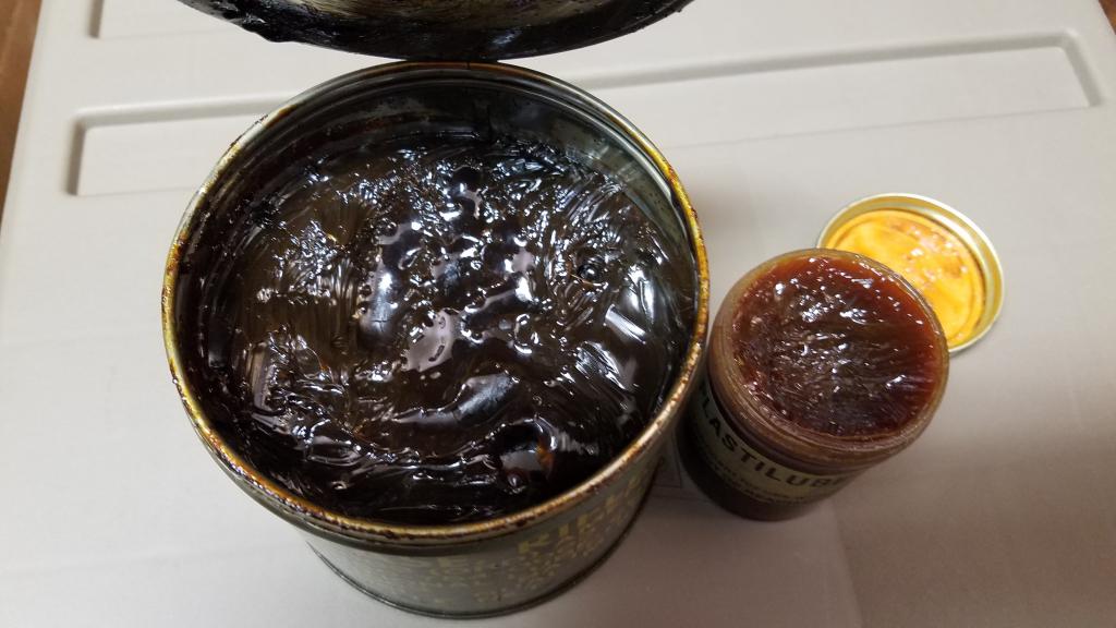

    I still have a can of it but can bet the formula has changed since 1942. I prefer the brown as it doesn't show like the yellow or pale stuff does. Rick Bicon

    I still have an unopened can. It'll last me a while, I think.

    In my rifle team days, the Armorer used Lubriplate 130A when he serviced the team rifles, and personally owned rifles he worked on. I never liked it as it would turn runny in the summer heat and get down into the bedding.
    Plastilube was the preferred grease by the vast majority of High Power shooters at the time for the M1 and M14icon. It will not melt, and it will not get stiff in winter temps like a lot of greases will.
