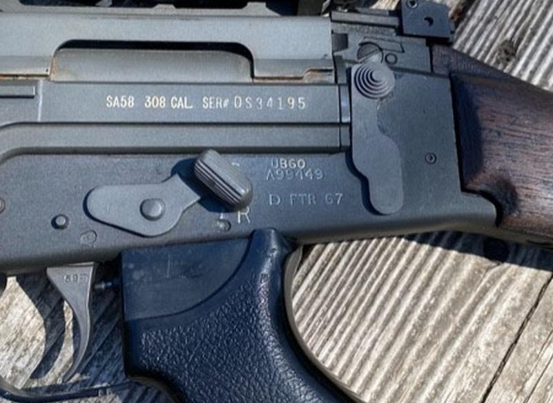

    Here's the Britishicon FTR marking. Enfeild did a batch in 1967

    Like I said, I never saw or was aware of FTR'd L1A1's. Notifications such as this would come through in a little restricted booklet titled 'information for Quartermasters' or within the Misc Instructions or Information part of the EMER's. It does seem strange that the example still has the turreted type body locking catch lever.
    Not if it were assembled after release from parts...

    its a photo of an American assembled L1A1 made from parts fitted to a compliant "American" body. The TMH is the important piece of information

    Well done for finding that pic Kev, starting to think I had dreamt it! I recall the small FTR marking on the TMH, clocked it on two BSA examples (I think), wish I had taken pictures!!!!
    ---------- Post added at 12:53 AM ---------- Previous post was at 12:50 AM ----------
    Bee Hive locking lever, good spot Peter, a rare item to find these days...
