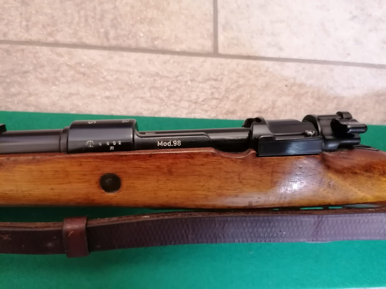

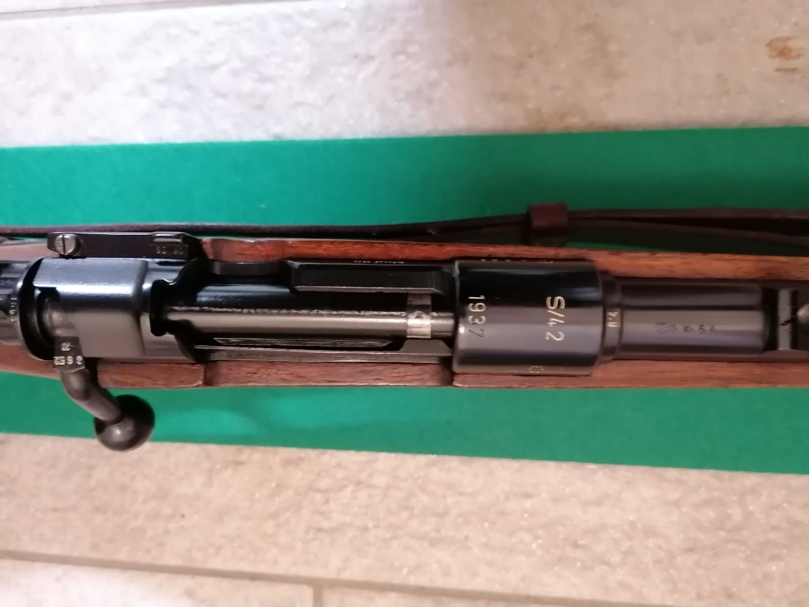

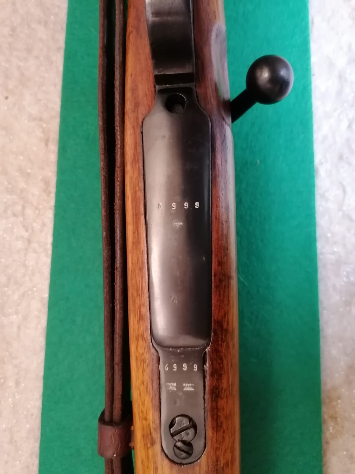

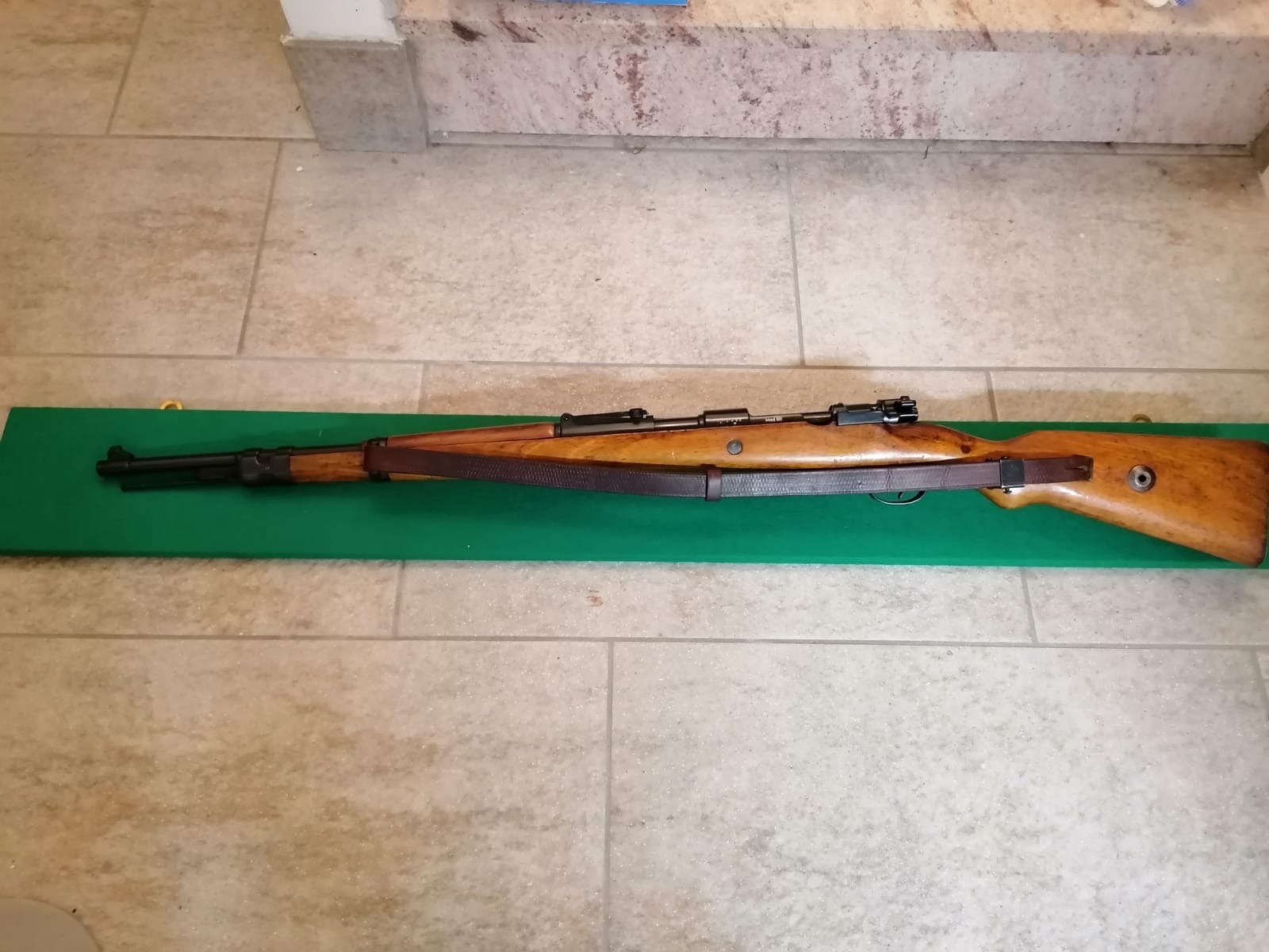

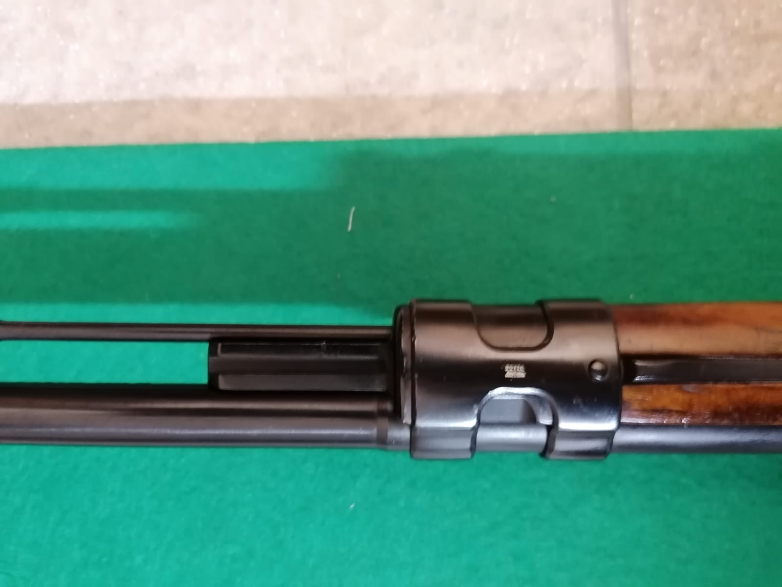

    I'll go pick up this rifle Tuesday.
    That guy is really ok.
    Worked on the AWACS in Germanyicon in the 80ies, and bought the rifle from a collector.
    Almost never used it since.
    He told me he can't swear about it, but the rifle might be 100% in original conditions.
    I'll see soon.
    I add the pictures again.

    Quote Originally Posted by Ovidio View Post
    I'll see soon.
    Attachment 123953Attachment 123952Attachment 123951Attachment 123950Attachment 123949
    Capture screws matching which is a good sign, bluing looks almost too good, but not impossible to be this good.....there are similar condition rifles in similar near perfect condition in collections.
    Only question mark I would put is the white infill to the markings, which isn't factory, but was commonly done by old collector types decades ago, so the numbers would stand out in b&w photo's etc.
    Check the stock though, it looks quite light in colour for a walnut stock, which most still were in 1937, prior to the introduction of the laminate stocks. It could have been sanded, and if the stock markings and numbers don't match the rifle, or are very faint and stampings are not commensurate with the blueing and rest of rifle, then maybe a question mark over it.
