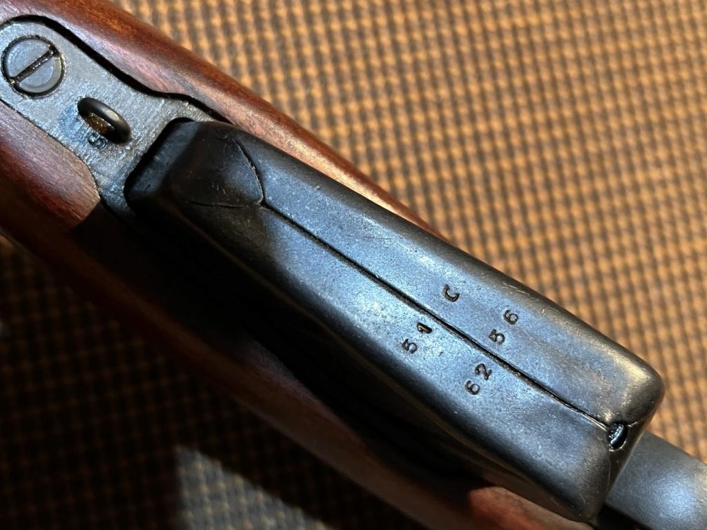

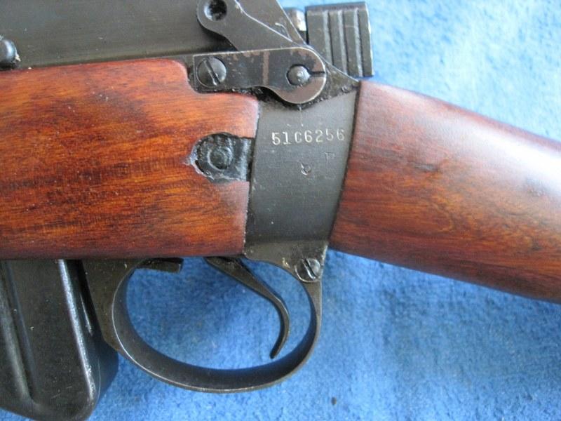

    Hi,
    I have a Lee enfield no4 savage that looks unissued, unfired but the bolt head is no3 so I assume the rifle is not unissued, unfired ? lol
    In my knowledge, when a service rifle is issued from the factory for the first time, the bolt head should be no 0 ?
    thanks for your inputs !

    This could be a rifle that has been completely refinished from an individual after restoring it. I did lots of them, they sure looked new after. Yes, #3 bolt head is at the far end of it's life... I knew a Canadianicon Ranger weapon storeman that used to put a higher number bolt head on rifles before issue to "Tighten them up a bit" without regard to their actual headspace requirement.
    Pics might help?

    Dunno how comes I had no3 in mind its in facts a no2 bolt head lol
    rifle is still pack with heavy grease and the bolt look brand new, same at everything else

    Don't know. Typing from memory and you likely have a few. Yes, looks about new. Whole thing...

    You can find #0,1 and 2 bolt heads on new rifles. The whole idea of the different length bolt heads to be selected for proper headspace was designed as a production expedient. #3 bolt heads were used later during FTR to get the last life out of well used rifles but you wouldn't see them as new from the factory. Your rifle looks legit and excellent. When you find them with the Dulite bluing in that condition, you know that they weren't used much. It wasn't the most durable finish in the small arms world.
