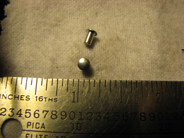

    The rivets are here but may be slightly short...diameter seems fine but I think the length on these will provide enough to gain proper strength. The measure 3/32 X 5/32...(?)

    edit to prev post: ...diameter seems fine but I think the length on these will not provide enough to gain proper strength.

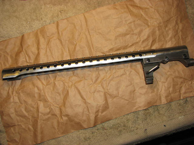

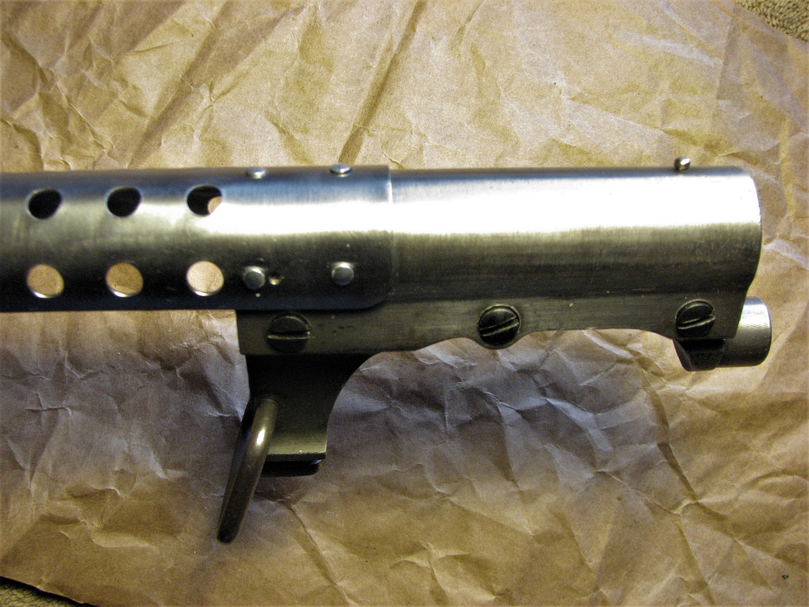

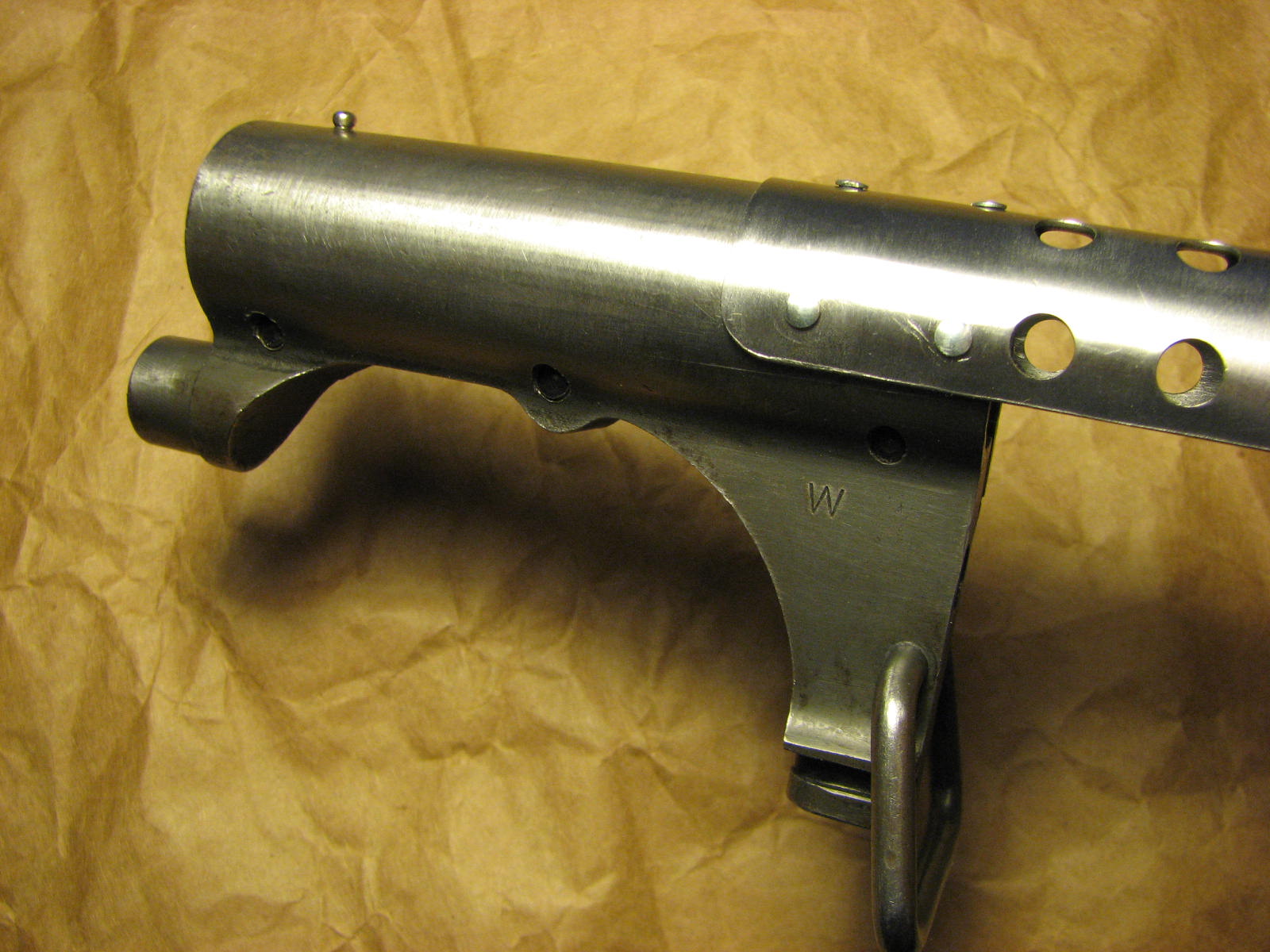

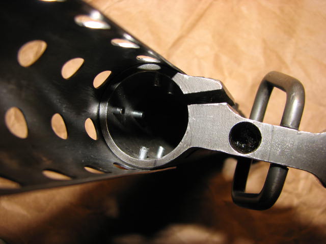

    Photos of the rivets installed but not soldered yet. The one misaligned hole will be filled in. Interior shot shows the rivets needing to be trimmed prior to soldering.

    They look good. After trim they would be about right.
