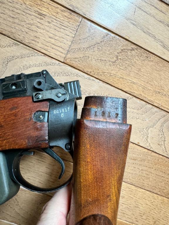

    I got the stock off and it's original! Got a real Savage setup by H&H....

    Quote Originally Posted by hopdevil View Post
    You took the butt off without removing the forend.

    So, to summarize I have a correct Savage No4 Mk1 (early) that was semi converted by H&H? Meaning, a Scope and bracket was not paired. We know this because it would be stamped "T" on the receiver if fully converted? "TR" was never stamped on the Savage Rifles?
    Your rifle was "fully converted". The part that included Jigs was the attachment of the base pads to the receiver.
    "T" on the receiver is not universal. On a 1941/1942 Savage No4T the presence or lack of a "T" on the receiver is meaningless.
    The "proper" markings really only show up in 1944-1946 production. Too many rifles have been "f'd" with by people trying to "correct" markings.
    On your rifle the lack of a scope serial number on the butt stock is the key.
    I take it your rifle is a Savage 6 groove barrel?
