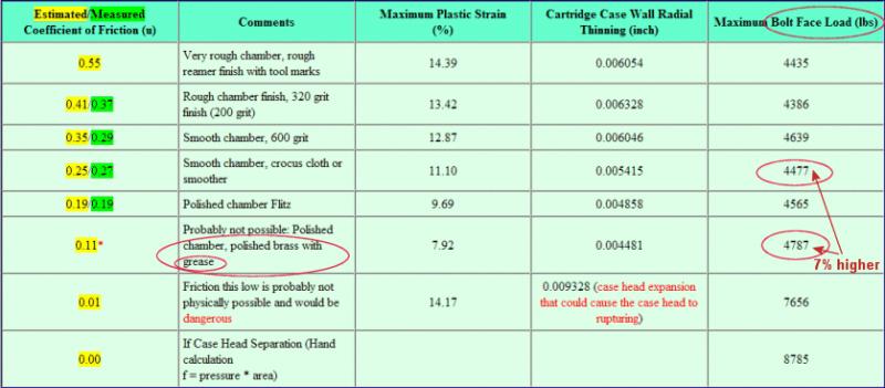

Here is some mechanical data from Olin
"If the case isn't stretched that far, or the case is effectively lubed, less energy is used for stretch and more reaches the bolt face. (The NRA Handloading book says British
-style axial pressure readings with dry cases are normally about 10% to 20% less than with lubed cases - possibly indicating that neither stretch, adhesion nor lubrication approach 100%, or that my 40% calculation is way off.) "
Yet Ed's post picturing the excerpt that 19 tons psi thrust with a lubed case vs 10 - 12 tons psi with a dry case is about a 40% difference.

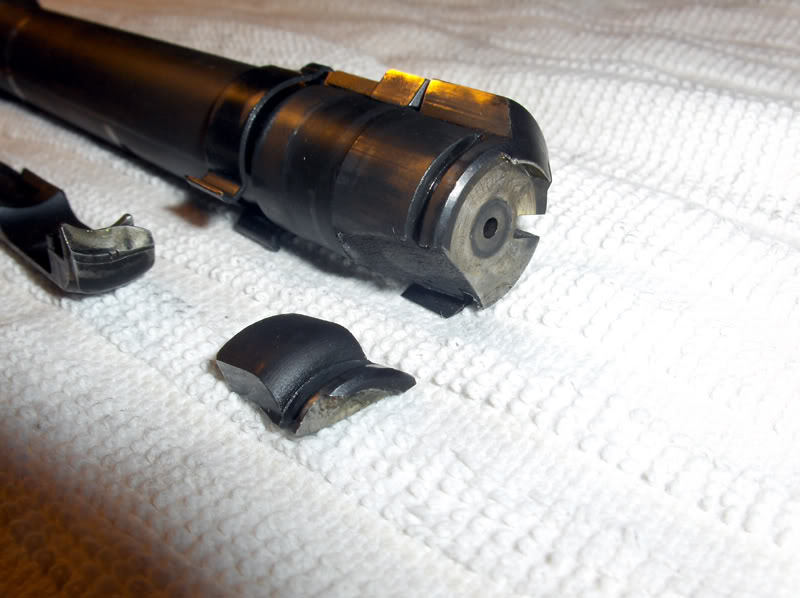

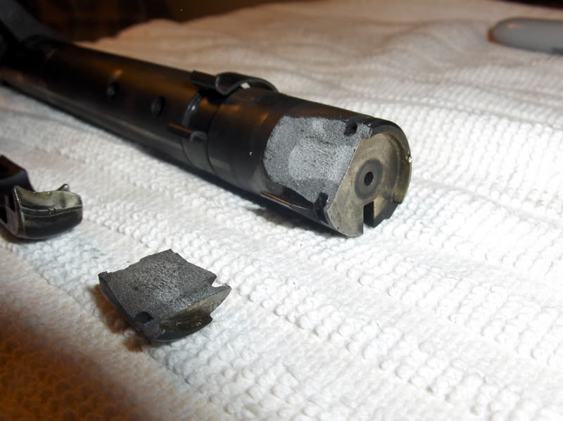

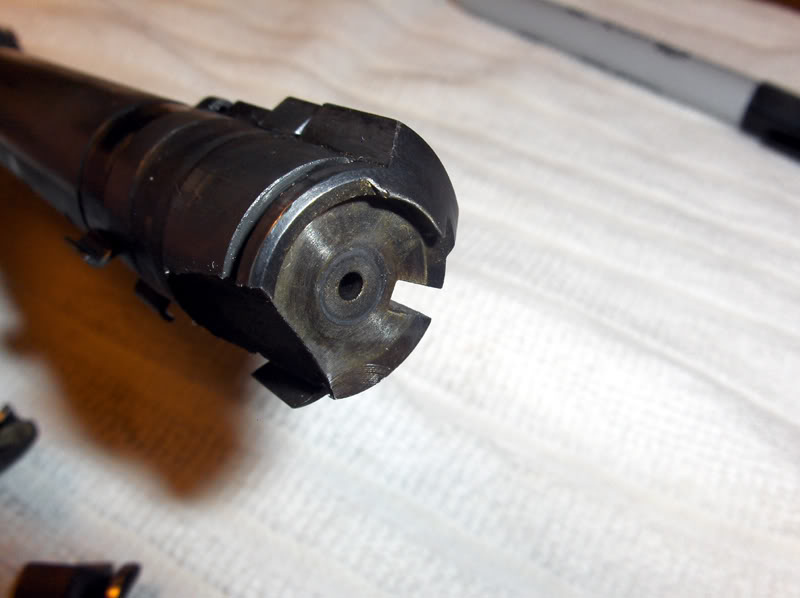

I damaged a .270 Remington 760 Gamemaster because I was using case lube to fire form my cases and the technician at the Remington repair center was the one who informed me to never use any lubrication to fire form any cases and to keep all oil or grease out of the chamber. My cases and chambers have been dry ever since and what caused the damage to my Remington 760 was excessive bolt thrust.
The problem is the oil or grease preventing the case from gripping the chamber walls and the case slamming into the bolt face with excessive force called bolt thrust. The bolt thrust on the Enfield is increased by the amount of head space or head gap clearance on each rifle. (The air gap between the case and the bolt face)
The mating surfaces of the bolt body and bolt head can become peeded and you can actually feel a sharp edge on the outside edge of the bolt body, think of driving a metal stake in the ground and how the top of the stake mushrooms outward. The same can happen to the bolt and lug recesses in the receiver with the corresponding increase in headspace.
Even fire forming cases at lower pressures still creates excessive bolt thrust and the case still slams into the bolt face and the resulting damage is accumulative over time. Decreasing headspace and keeping the chamber dry and oil free reduces bolt thrust, if you can not change your bolt head to decrease headspace then using a rubber o-ring reduces your headspace to zero when fire forming cases and eliminates excess bolt thrust.

For those of you who oil your cases and say it has no effect all I can say is my rifle was damaged and the warning in books in manuals were put there for a reason.
