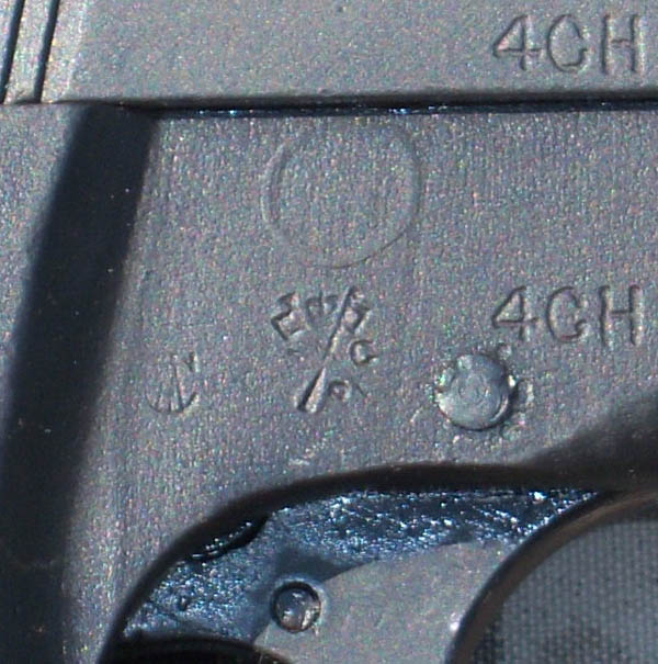

    Hello everyone.
    I found a small but interesting C Broad Arrow stamp on my Chinese Contract Inglis. Can anyone tell me why this stamp is present? To me it means this pistol has seen service with the Cdn Forces at some point.
    Is it possible that this Hi Power was captured from the Chinese by Canadians during the Korean conflict and put into Cdn service?
    The script on a usual CH marked Inglis translates to "Property of the Chinese Republic" and there are 6 characters involved.
    As I understand it, the Chinese script translates to "Public (or) Official gun" but I do not know what that signifies.
    Is it possible that this pistol was issued to a member of the Chinese Army? I've seen a few chinese inglis contract pistols that were never shipped and went into Canadianicon service. None of the examples I saw had Chinese script on them. I should never assume but I don't think the Chinese stamps were made in the Inglis factory - my gutt thinks they were stamped in China. Never trust your gutt instinct because its usually wrong right?
    Anyone have some clues as to what this Pistol did in its previous life before I got my grubby hands on it? I need Clive's book

    The small C-broadarrow stamp you have noted on the right side of the frame of your pistol seems to have been applied during manufacture to most pistols - both the No. 1 ("Chinese" model) and the No. 2 ("Canadian" model) before the finish was applied and irrespective of ultimate destination, so in this case did not signify actual Canadian government acceptance or ownership, to my knowledge.
    I don't see the issue of this mark being indiscriminately present on both types of pistol addressed at all in Clive's book, either in Chapter Eight ("Standard Markings on Inglis Pistols") or Chapter Nine ("Special Markings") and can't recall seeing any other explanation. Perhaps, because production originally began at the request of China to supply them with High Power pistols as part of Allied Mutual Aid arrangements, it was originally used as a sort of "faux ownership mark" akin to the "U.S. Property" marks applied to Lend-Lease materiel ..... Who knows?
    In any case, the matter is further complicated by the fact that the great majority of pistols (of either type) which actually entered Canadian service do not seem to have ever been given any additional Canadian government/military ownership marks anyway - perhaps it was felt that the C-broadarrow already on them was sufficient. Again, who knows?
    Having said all of the above, my own No. 1 pistol does have a separate C-broadarrow stamp - rather larger than the other one - stamped on the left rear of the slide (a "regulation" location for an actual Canadian acceptance/ownership mark on a semi-automatic pistol) and is the only one I have seen with such a separate C-broadarrow, in fact -
