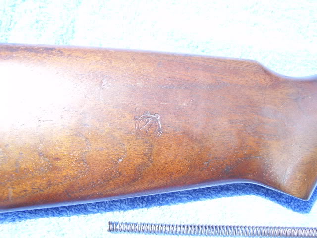

    Guys,
    I've had a stone mint early Standard Products M1icon carbine. It came out of Lynn Lugar's estate/private collection. Nothing refinished, crisp unissued condition, but the ordinance escutcheon on the stock is unusual. Compared it to those in my Ruth book and it doesn't look SP. The stock is marked S-HB in the sling cutout. Same with the handguard. Everything is textbook correct SP. It is either an anamoly or someone popped a fake escutcheon in a like new, untouched original SP stock. Thanks in advance for any help.

    Hambone, I think Hillerich and Bradsby, Louisville Slugger bat factory made that stock. Don't know much about the crossed cannon cartouche though.

    If that Carbine is a 65 year old, "never been used one", I'm thinking, the cartouche may very well be correct. Standards will have an SHB or SJ slingwell. Here's a couple of well used ones, that didn't make it back to the States for rebuilding. A 1.9 and a 2.2. Compare to yours and let us know what you think. I'd like to know what the left hand side of the butt plate on your one can tell us. Here's hoping an STD. PRO expert contributes !. Mike.

    On a good note, it does not match the pics in Harrisons and WB carbine books as we know they are wrong.
    Need BrianQ on this one, I have studied cartouches from the different carbine mfg's, but the Std. Prod. and IBM cartouches are the hardest do to there size and being 65yrs old with alot of wear, very hard to see details.
    One thing to look at is the fuse hole in the right cannon and the shape of the pinions on the left cannon. Hopefully Brian will contact you.

    look at the cannon butts

    It look like an IBM
    It also looks like a Winchester as well but the cannon butts are curved on the Winchester, IBMs are not. Flame is also like IBM.

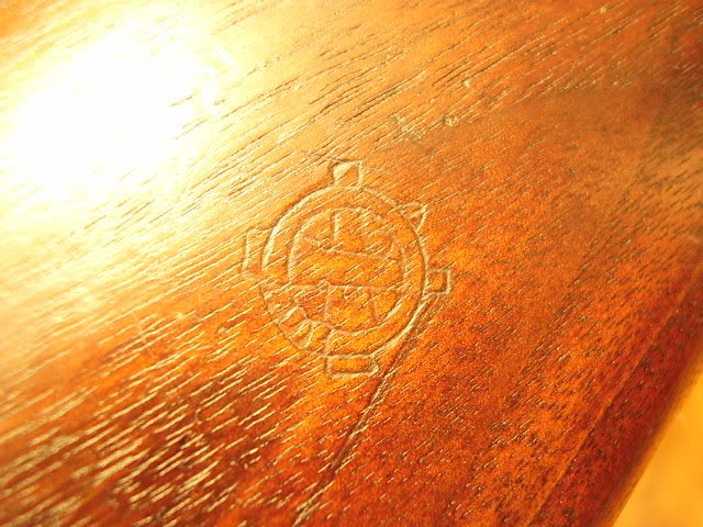

    Why would it be on an otherwise mint original condition SP with an SP stock? I think this a little closer pic.

    I hope that CC is real....... because that is one beautiful carbine.
    Did notice the op slide stop pin is parked, but i sure wouldn't throw it away over that.
    When you get a chance could you give us a parts breakdown?
    maybe a few more pics like the frt sight, barrel marking, rear flip etc.
    Thanks for sharing it with us !
    Charlie-painter777

    I remember a collector friend who has been collecting carbines for 40 years laughingly lamented to me how he had made "correct" carbines that the Ruth book said were already correct. That is, original carbines were a$$ed up being made "original". I'm not a US collector, but it seems to me that there is an awful lot of misinformation masquerading as "textbook correct" information in books and such. Just as soon as I swapped this stock or the pin out, another book would hit the shelves or "conventional wisdom" would change. So, Lynn Lugar had it for many years like this, and I will too I reckon.
