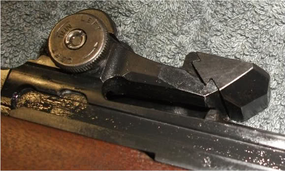

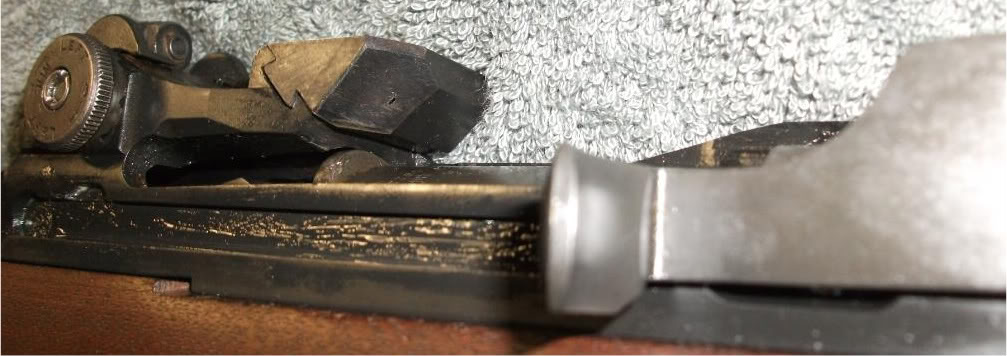

    Is it a Springfield Inc. mount? If so, THERE'S your problem. It can be fixed by judicious metal removal, mostly from the part that replaces your charger guide. On the last one I did, the cross screw hole just began to show before the brass quit ejecting improperly.

    Couple or three photos of the "modded" Springfield Inc. rear mount attach point. Note that the cross screw hole is just starting to break through the "new" angled surface. The mount proper needed no modification for reliable function:
