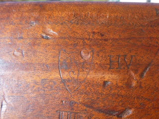

    not to sand
    I like that patina color on walnut, if it is on a Lee Enfield, M1icon Rifle or 1903. Just finding wood parts such as handguards with a nice old patina color is difficultAttachment 16654Attachment 16655Attachment 16656

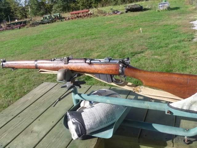

    Why sand the stock?? Just clean it and rub in some Raw linseed oilicon. Sanding wrecks the stock and you can spot a sanded stock a mile away.......Don't ruin history please! Here is a good example. It's a 1926 Lithgowicon that was filthy. I cleaned it with DA and rubbed in some raw linseed oilicon. If you look close, you can still make out the Kangaroo. Sanding would have ruined this beautiful piece of history. OBTW, no steel wool either! Regards, Rick. Regards, Rick.
