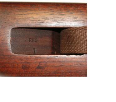

    If it is RMC marked in slingwell I would say yes, but I would say to late if it was an H.I. or OI stock

    Here's the sling well marking.
