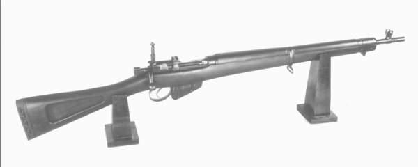

    According to Skennertonicon's newest publication The Lee Enfield on page 319 ..
    "At least one prototype .303 N0.5 jungle carbine was produced at the Long Branch factory, the illustrated specimen is from the Canadian War Museum collection. This example utilized a 1943 vintage No.4 Mk1* receiver with No.5 type barrel, flash eliminator assembly and fore-end. The backsight is s No.4 Mk3, re-graduated to 800 yards, which makes it similar to the British-made No.5 Mk2 sight. The carbine is stocked to within 6.25 in. of the flash hider, similar to the ROF Fazakerley and BSA Shirley-produced No.5 model."
    The photograph from Skennerton's book referenced above also appears on page 319 and shows it marked as a 1943 No.4 Mk1*.

    To offer an authoratative opinion one would need to examine the rifle alongside a contempory Long Branch rifle and British No.5 to examine each component for the machining, cuts and finish. Wood and metal alike. Unless it were a tool-room one-of, there would have to be 10, 12 or 20 produced so we would need to compare the only known sample (not saying that is kosher either) at the CWM. Special parts like the flash hider, barrel, rearsight (would have been graduated to 800 years, surely), &c.
    Also consider the requirement of the Canadianicon war machine at that time. Would they have needed a jungle carbine? With two factories churning them out in Englandicon, I doubt that England would have considered an order on same from Long Branch.
    CWM sample has the action body made in 1943, another point for consideration. And a folded sheet metal rearsight rather than the machined Mk I Singer type. At least it is marked to 800.
